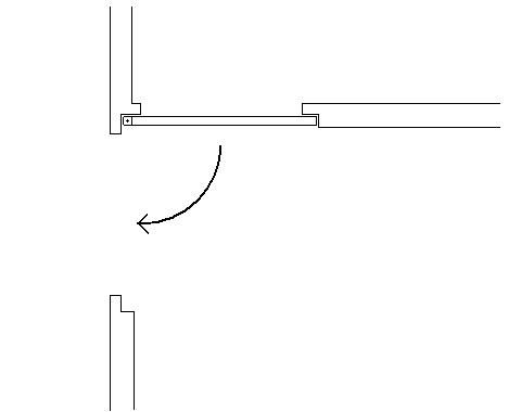

Well, I never made drwgs, but I will share where my thinking went:  The "hinge" becomes a vertical pin(s) near the back edge of the door ... and running vertically thru the centerline of the door thickness.  Either one long pin, or two short pins ... one at top, one at bottom.  The back edge of the door is rounded ... a portion of a circle that shares the pin's centerline.  The shared jamb between the two openings is also rounded, and "fitted" to the door's rounded edge ...allowing close approximity between the door edge and jamb.  So now we have the door swingable between the two openings ... and swing stops and trim are easy to imagine.
What about the doorlatch hardware?  It would be easy enough to make directional latches and use one doorknob and latchware.  But another approach would be to made the door "dumb" with non-moving latch components ... and put all the latchware in the two separate door jambs.

bambilez
Thanks bayview.
It seems as if i would be able to have 2 doors leading into a paralel coridoor, which will open onto another frame, to create a sealed walkway between those rooms.
Thanks for the drawing,  8)
.......and shouldn't be too expensive either.
JRR
Yes, thanks Bayview for the drawing.  Just the way I was "seeing it" in the 'ole head-bone!
