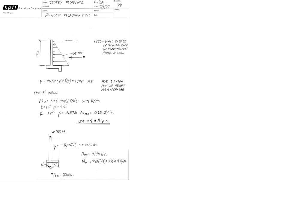

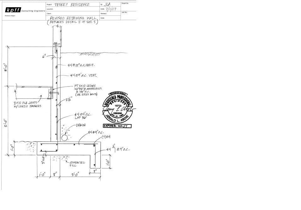

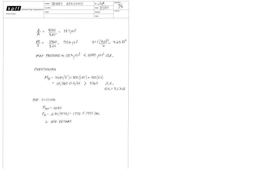

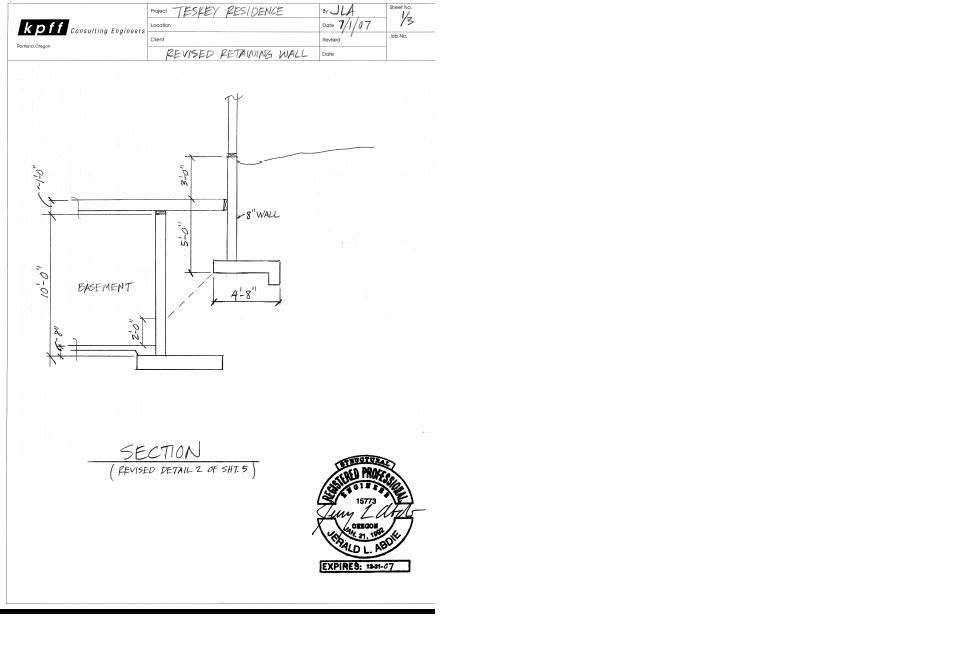

I cannot locate my specs for my main retaining wall, but I have
included the specs for a smaller secondary wall that is upslope from my
main basement wall.   It will, I hope, give you a sense of the type of
calculations and specifications that go into a retaining wall.  I happen
to think the stakes are high and the investment in a professional to
figure out the appropriate design standards is important.   I also included a few other pictures to provide some context....
mt

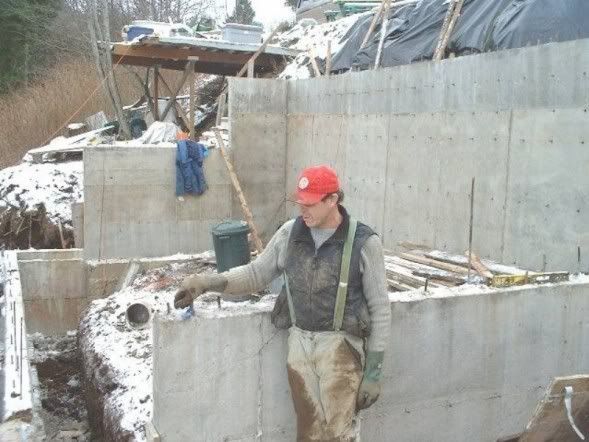

Here is a picture of the main wall after pouring and forms removed..
