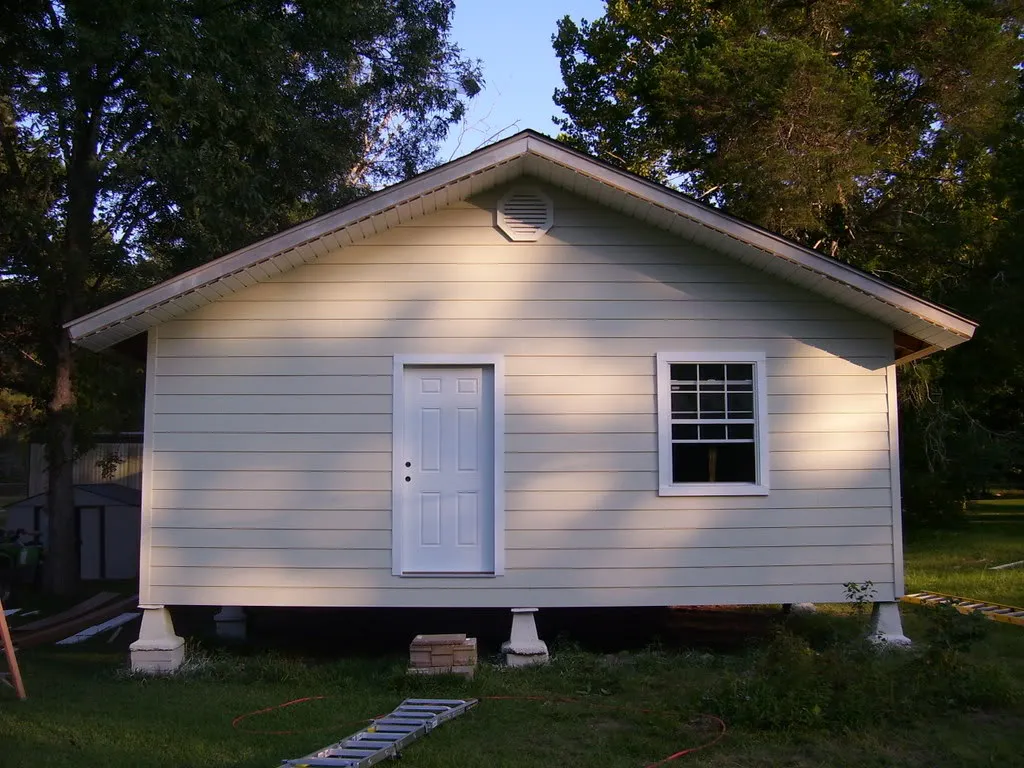

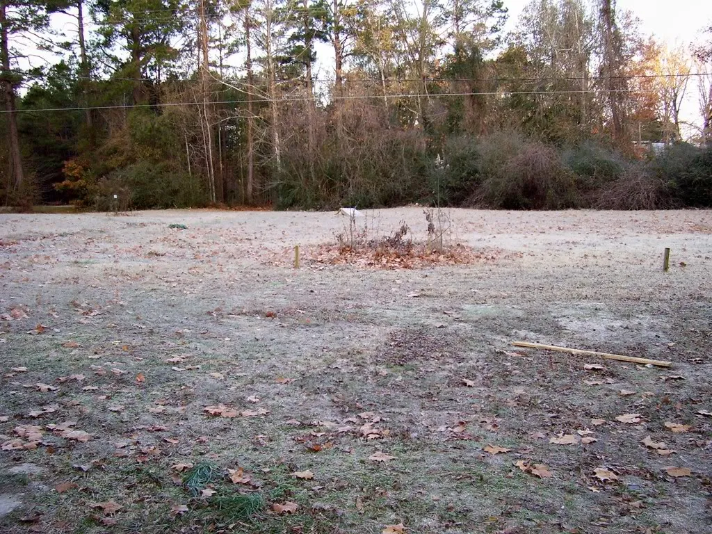

I've been reading this forum for a long time and admiring the work of others' building projects.  Being newly married my husband and I were looking to purchase a home, but gave up defeated.  The prices were outrageous and we knew we could never afford something we really liked.  So...we got inspired by you all and decided to build on an acre we purchased.  And we decided to pay for it with all cash so that we would have no debt on our home. That was one year ago.
I was 23 and my husband was 22 and we had absolutely know building know-how.  We literally checked a book out from the library called "How to Build a House"
So far so good.  We will be hanging sheetrock and insulating this weekend.    We hope to be finished and living in it by this summer.  All in all, a year and a half is not too long of a wait to have a brand new house that we designed.
Here are some pictures if anyone is interested. <a href="https://s252.photobucket.com/albums/hh4/jspalmer/?action=view&current=100_1377.jpg" target="_blank">Click Here.</a>
From Dec. 2006:
To Dec. 2007:
Just a few details:
Up to this point we've spent approx.  $11,000 on materials.
Labor only costs us our sore muscles.
The concrete piers were given to us, so we did not pour a slab.
The 2x6 roof trusses were purchased at a steal ($44 each!) They were accidentally built to the wrong size for another project.  Their loss, our gain.
We chose Hardie smooth lap siding for the exterior, 30yr architectural shingles, bought all doors and windows at Lowes/Home Depot, did the plumbing ourselves, my husband is an electrician so wiring is a given.
A family member is going to build my solid oak kitchen cabinets for free.  We bought the lumber this weekend for $1000.
I would appreciate any comments, questions, or suggestions.   And also a little constructive criticism if you see that we're doing something wrong.   We only know how to do what the books tell us to do.

Nice work... a year can make a big difference! :D
Great job.  Much better than going into debt for the rest of your lives.
Congratulations!  What an inspiration you 2 are!  I bet your friends & family are quite impressed  [cool]
