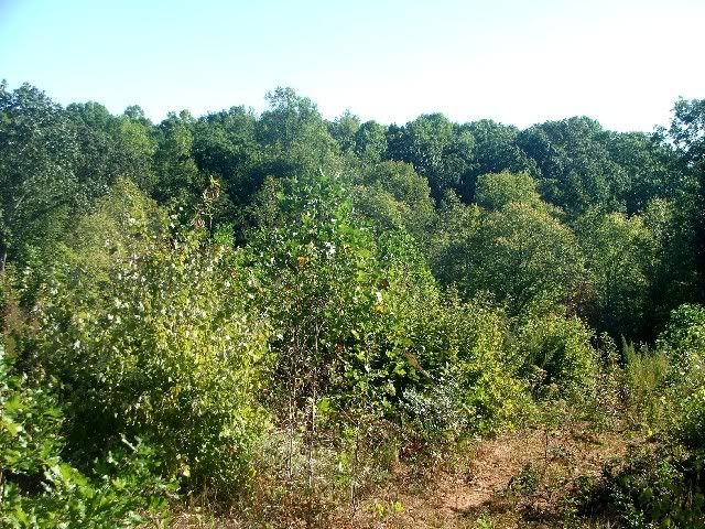

peter_nap
Here's the new spot before I cleared. It's steeper than it looks. The river is where the big trees are. Good view, PITA to build on.
Think about how the solar etc. will affect your house in the new location, Peter.
peter_nap
#11
   ;D[highlight]Think about how the solar etc. will affect your house [/highlight]
Already have Glenn. It works out pretty well. Taking the picture, I am facing due east. We are near the top of the hill and will have an unobstructed to the south and west for the solar.
The tractor shed will be to the left and the panels go on the roof of that with a battery bank in an underground, vented and drained container. This keeps them warm during winter.
To the right and down is where two of the springs come together. That's where the hydro goes.
The prevailing breeze comes from the river and a 20' tower puts the wind ginny above all the trees.
The composting toilet needs to stay at a minimun of 55 degrees to maintain maximum efficiency. That goes in a solar space under the right corner of the house with a coldfame vent in it. The crapper  will operate on AC,DC or no electric. It works best if it has power to the fan in the vent pipe(40 watt)....That gets a dedicated 45 watt panel .
The solar hot water panel goes on the roof just over the right hand corner.
It all works pretty well.
The air is cooler in the bottom near the river so the intake end of the earth tube goes there
