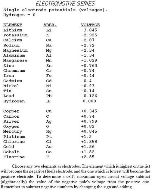

FYI, ACQ is one of the reasons for the development of those special Deck Screws... they're okay for ACQ PT lumber. In a similar vein the Simpson Z-Max products are rated for ACQ use. Using 30# roofing felt (or asphalt shingle.... ) as an "insulator" between ACQ and a metal bracket can also help with alleviating the problem. The problem stems from the fact that in the presence of moisture the steel and copper (the "C" in ACQ) don't get along well... the 2 metals create a battery of sorts (how many volts?) and that leads to accelerated corrosion.

A couple years ago I screwed down some ACQ planks using the run-of-the-mill yellow zinc electroplated screws. Earlier this year some places were popping loose. The 3 inch screws had corroded down to 3/4 to 1 inch little rusty pointed bits of metal with no threads left.  :o

How about a little report on how many volt's Don --- possibly you could provide us with a few numbers :-?
You do have a nice multi-meter, don't you :-?
You don't have to present it in spreadsheet form. :)
Unless you want to. :-/
What is the potential between the metals?
Try multiple potentials -Iron, zinc, copper

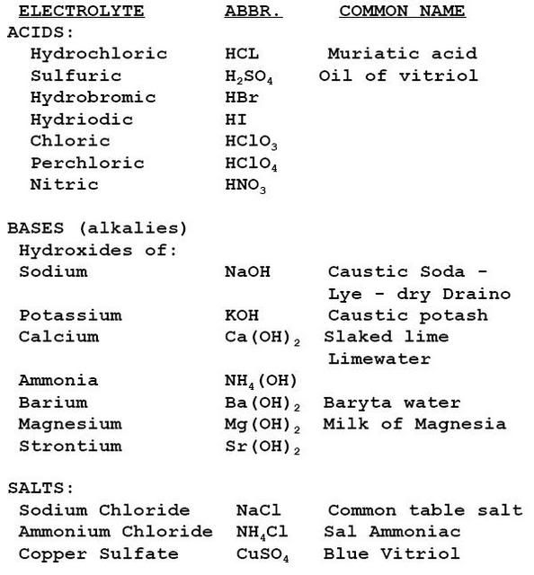

ACQ (alkaline copper quaternary)  Alkaline energizers anybody?  This one will have to have future ramifications, eh. :-?
Data from Rust Power -by John Hait   http://rmrc.org/rustpower.html

Possibly when it has eaten enough away it loses contact and is no longer a battery, but there is still enough holding if it wants to jump off of the foundation in an earthquake.

Glenn, I see the potential.  :-/

Don, that is from the E-Book I got that tells you how to make batteries by decomposing metals.  Any metals.  Your entire foundation could become a power source but as soon as the anchor bolts entirely turn to rust, your power will stop and your house could blow away.  This is a new and interesting mandatory experiment by the Building code/Building official/Corporate Big Business/Taxation conglomerate at the expense of the homeowners of America or anyplace the codes affect the building industry.
Anytime this mixture of wood and metal becomes slightly damp, it will become a battery and decompose the metal at a mild to fast rate.  The extra zinc is merely an extra sacrificial layer only prolonging the agony of the metal decomposition.  It should help to get you past warranty though. :o :)
