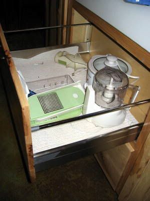

I have the Blumetal box with Blumotion full extension and so far they have performed beautifully albeit a short time.  I didn't install them but  the cabinetmaker said it would be much less time on his part with just as good (or better) result.  In Arizona we don't really have to worry about humidity rusting the metal, otherwise I try not to have water in my drawers  :-[ (the Depends really help).
My husband built the island (not shown) from an existing cabinet with drawers which don't have these slides-they will in the future.
Judy

Ah Judy's photo reminded me of another complaint we had , notice how short the draw side is , that may not be the tallest Medabox  side they sell , BUT  the tallest side is like 8" IIRC . We had at least one client who hated that so we made a "liner" that came almost all the way up  in EACH draw . So any time we saved :-/ was ah taken back Eh ::)
Yes Judy's has the "gallery rail" and IIRC we had used those as well  BUT the lady still didn't like that fact that she had a big draw front and essentailly a 6 or 8" draw side.

All I have is my experience with the slides. We have the 8 inch on the drawer pictured and the 6 and 8 inch in the pan drawers under the stove. I can't think of anything I would put in them that wouldn't/hasn't stayed put unless I was stacking a lot of loose things on top. But then I knew exactly what I wanted in these drawers when I drew the plan. Also I'm not nearly as nit-picky as some-like the lady you're speaking of may be.  As far as noisy-they aren't. They are the quietest drawers we've ever had. We do have the Blumotion soft close, maybe that makes a difference.
They are expensive but one of my mantras has always been, If it's something you touch every day, spend what you feel comfortable to save yourself aggravation.  Who wants to be irritated by their "tools" on a daily basis.  Every time I use these drawers I'm glad I spent the money.
And no, I usually don't put wet things in the drawers, I have a rack that they go on if damp from the DW. But again in AZ, usually not a problem with <25% humidity 10 months of the year.
