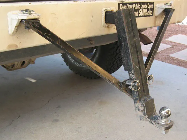

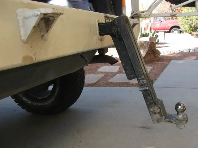

One of the problems with a lifted vehicle like my Cherokee is hitching a trailer to it. Installing a typical receiver hitch was not an option as they hang down under the bumper reducing the clearance at the rear. I solved the problem by starting with a new bumper I built myself. 2x6 inch 3/16 wall steel was used. I cut through the bumper and welded a receiver tube into place.
The trailer has a low ride height which is great for loading and unloading. However this meant a drop of nearly 18 inches from the bottom of the bumper receiver tube to the base of the hitch ball.  :o
As I suspected while designing this, with such an extreme drop there was quite a bit of sideways slop at the hitch ball. It made all kinds of noise. Backing up over bumpy ground and backing around corners probably put more sideways twisting force at the receiver tube than I liked. I was certain things would wear and just get worse.  :(

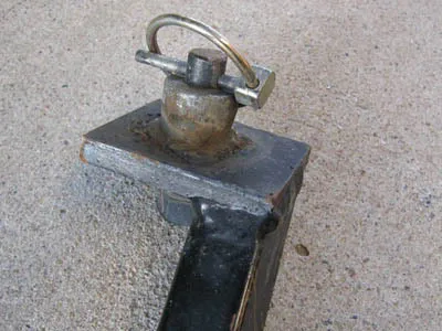

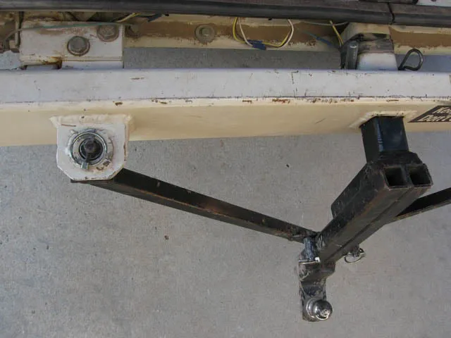

I had built the bumper with two large tabs primarily for attaching tow straps with large D-rings. The 3/8" steel tabs actually go right through the bumper, welded on the front and rear of the bumper tubes. Half inch bolts connect to the custom mounts. All welds are air tight as I use the front and rear bumpers as air tanks.
I built a Vee shaped brace using 1 inch square, 11 gauge wall, tubing. The lower end of the Vee connects to the drop hitch. The upper ends of the Vee connect to the bumper at the two tow tabs. Snap ring pin locks make mounting and demounting easy.
There's now no noise emanating from the hitch and I'm happy.  :)
