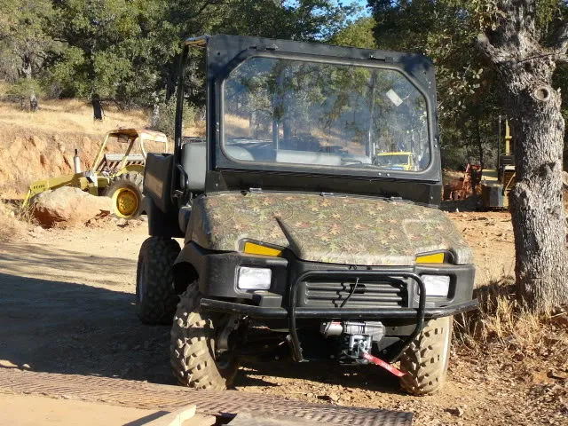

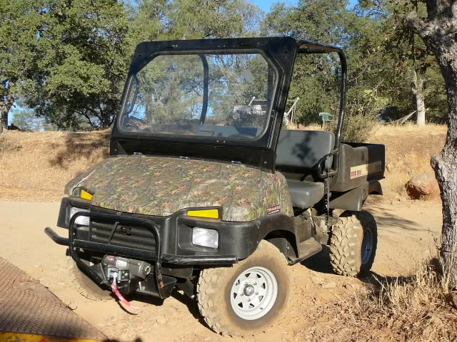

Bush Hog is here.  Not too much evidence to show that it was hit by a out of control 18 wheeler.
Mike fixed up nearly everything on it.  Biggest thing left is the hood crack, and when I stop playing with it I may get that fixed. :)
More accessories on the way -- top - snow plow - power dumper for the bed - maybe even the gun rack -- already has beer holders. :)
