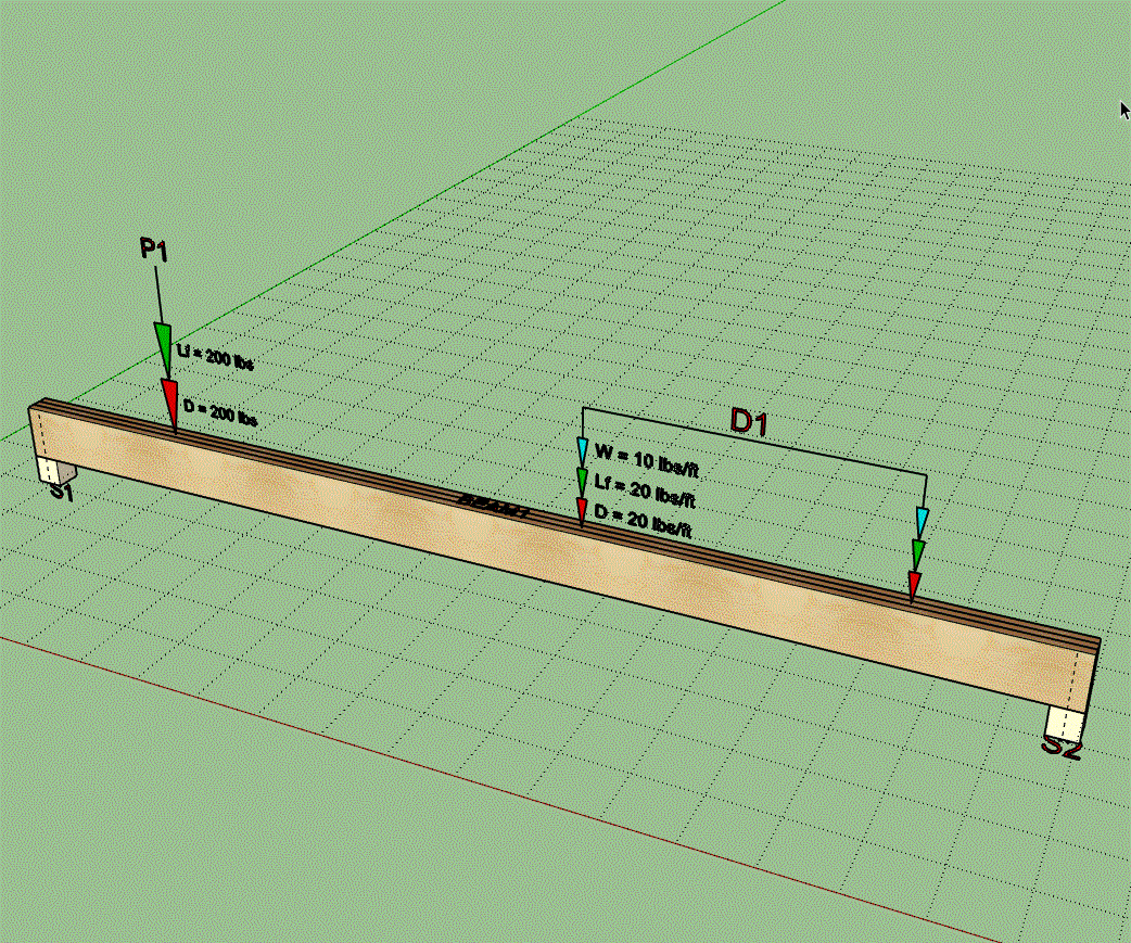

Here is an example of some point loads applied to a timber beam, now I just need to setup annotations:
The different color arrowheads indicate one of the six load types (Dead, Live Floor, Live Roof, Wind, Snow, Seismic).  The colors assigned to each load type will be able to be customized in the global settings.  The size of the arrowheads will also be customizeable.
Regenerating the beam geometry will not regen the loads, there will be separate context menu item (right click the beam) to regen the engineering loads/supports.

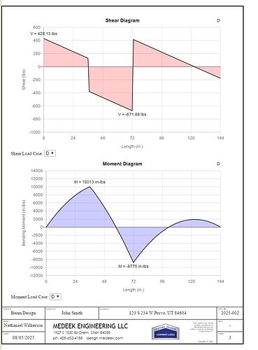

Now that I have the shear, moment, slope and deflections algorithms in place for point loads it is just a matter of algebraically adding multiple loads for more complex loading scenarios (ie. multiple loads and load cases). Here is a very simple example of two point loads applied to a two span beam. Note that self weight of the beam is not yet being considered:
I need to add some formatting logic into the top beam diagram to account for shorter spans so the dimensions don't run into the supports as shown. This is why a lot of testing and debugging is necessary.
This beam engineering tool with its matrix analysis engine is probably the single most complicated piece of code I've ever written, it certainly rivals the truss calculator (2013) and the complex roof (2019) module. I will admit that I now freely use ChatGPT with some of my coding puzzles lately and surprisingly it even understands the context of what I'm coding and offers suggestions to improve the accuracy and efficiency of the engine itself.
The numerical integration (for the slope and deflection) was initially stymied by incorrect boundary condition constants and I had no easy way of analytically solving for them. At that point I was fully aware of the issue but I was stumped at how to arrive at the right solution. ChatGPT suggested a normalization algorithm which proved to be correct and was even an easy fix within the algorithm. It's like having a really smart graduate student looking over your shoulder pointing out what your doing wrong and how to make it all better.

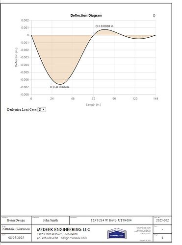

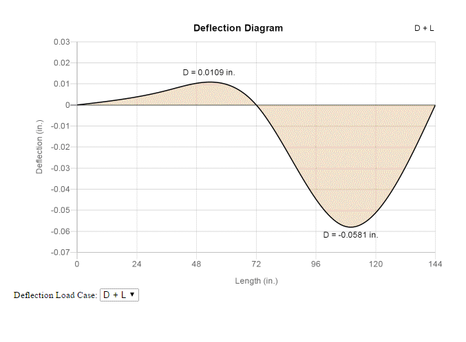

Here is a first look at the ability to switch between various load cases for the deflection graph:

First look at a combined point load and distributed load. I'm not exactly happy with the shear diagram where it makes the vertical jumps. I will need in to add in a correction factor (additional point) at each point load and internal support so that the shear is properly reported at those locations.

Still putting out a few fires and bugs. I had a small bug in my conditionals where loads were symmetric (like the example below), but I've resolved that now. My next fix is the vertical jump issue(s) with the shear diagram. I have some ideas on how to address this, just need to test it and see if it is the solution. Here is a symmetric point load scenario and the deflections for the two load cases:
P1 = 500 lbs (D)
P2 = P3 = 100 lbs (D) 500 lbs (L)
Nathaniel P. Wilkerson, P.E.

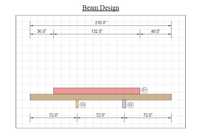

First look at partial UDLs with overhangs:
So with that I think the basic nuts and bolts of the matrix analysis engine is in place and functioning pretty much as expected.  Of course it will probably be a few more days or even weeks before I am able to put out every little fire that may be burning undetected thus far, but we will see.

- Added a deflection graph to the beam report.
The engineering report is still not complete however by rolling this beta release I can allow potential users of this plugin the ability to test it out and assist in the debugging.  The plugin can be directly downloaded from this link:
