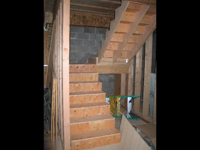

Well we have finally started back up.  My wife and I have been doing the little time consuming things here and there.  Floor span connectors, blocking, cleaning and organizing.  This was the first weekend that was snow free.  Two weeks ago we still had 2+ feet of snow, but now everything is drying up.  We had to sweep the volcanic ash off the deck from Mt. Redoubt's past eruptions, but the place looks great.  I have a buddy who is going to help with the plumbing and another that will help with the electrical.  My wife and I reworked the stairwell walls in the basement and actually started stairs, well sort of.  We put in the landing between the basement and the first floor.  I hope we can get the stringers done correctly.  Of course nothing is perfectly plumb or square, just to make it more difficult.  The concrete slab has a dip in it and some how the damn framer (that would be me) didn't square up the stairwell hole perfectly.  Hopefully I won't mess up to many stringers. I thinking of making an OSB template (cut to the width of a 2"x12") that way if I mess up it won't cost so much $$ as I have lots of strap OSB.

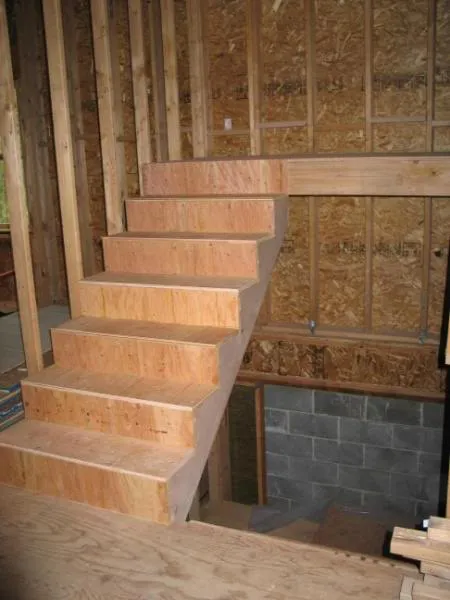

Well my daughter and I went up to the cabin to do a little work today.  It was a very nice day.  We added one more platform to the stair landing and finally got around to shimming all the windows.  I have attached a few pictures.  One of my helper trimming shims, one of the stair landing and one of the pond out front.

Well I took a week off to paint and of course it rained 3 out of five days.  We got the front painted and all the trim on.  We also finish the flight of stairs from the basement to the first floor.

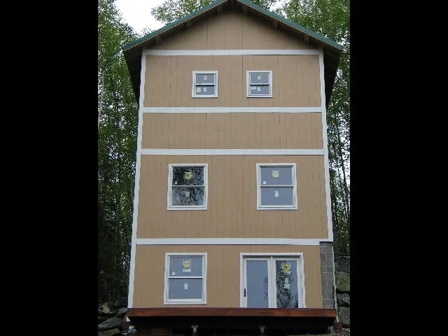

rdzone

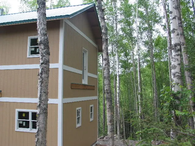

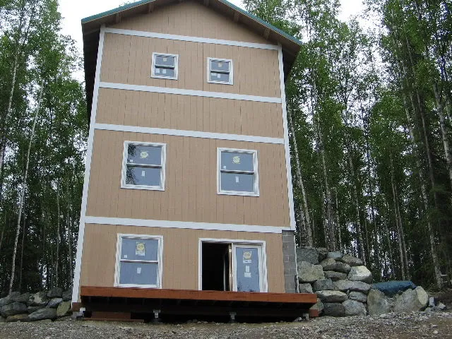

Finally have the whole cabin painted with all the trim installed.  I am definitely glad to see the scaffolding gone.  We finished the painting last weekend and my wife installed all the window screens after removing all of the manufacture stickers and washing the insides and outsides.  The place looks pretty finished from the outside, but still all of the inside work to do. (plumbing, electrical, insulation...etc).

rdzone
#129
some pictures as promised.
Chuck

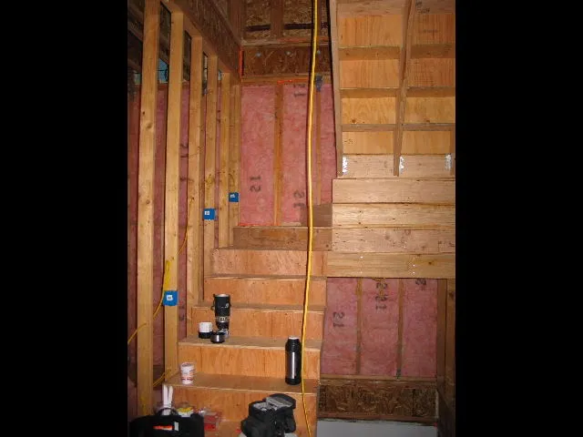

I started another thread to cover my daughters playhouse/mini cabin.  But I did squeeze in some work on the big cabin.  While it was raining my wife and I got another flight of stairs completed.
Chuck

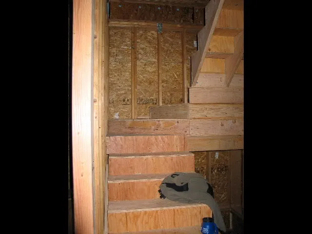

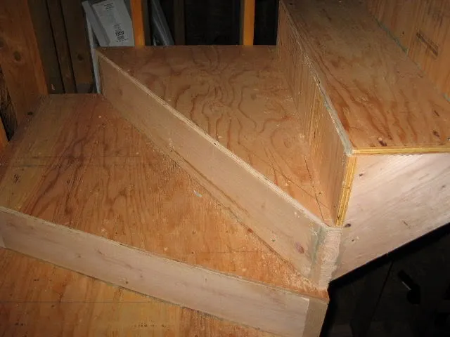

rdzone

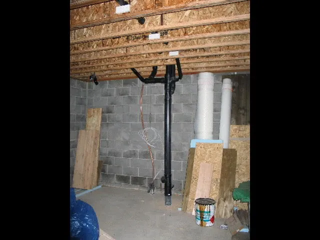

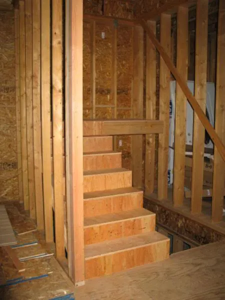

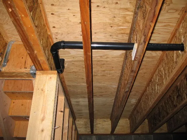

Well my wife and I took yesterday off and we got our stairs done, winders and all.   [cool]  My buddy also came over and we started the rough plumbing.  :)   No pictures, but we will take some this weekend.  I must say I over thought  ??? the stairs, once I broke it down into pieces they really were not to bad.  They are not strictly to code, but the cabin is in an area without any codes.  It sure beats climbing up and down a ladder!

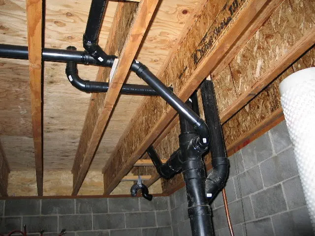

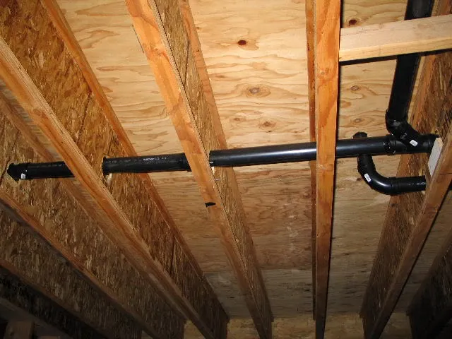

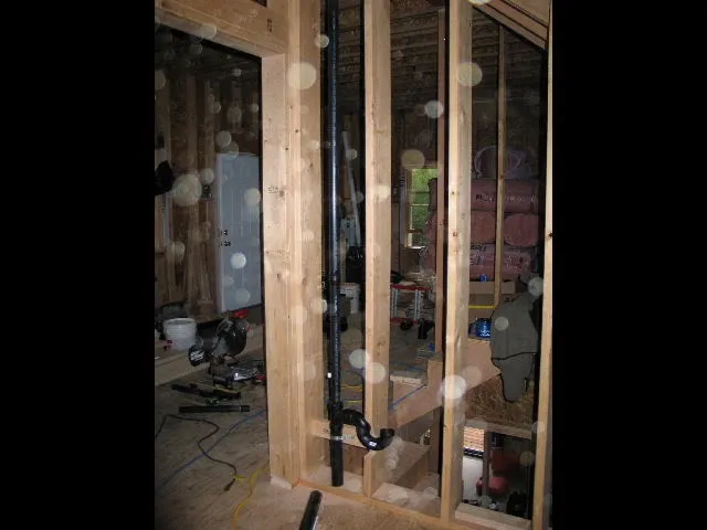

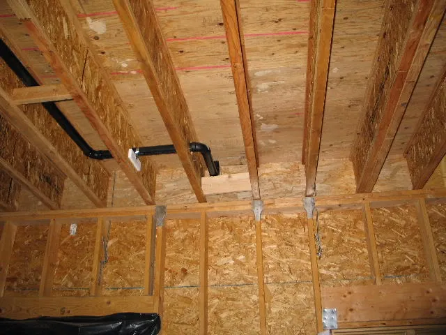

Ok more stair pictures and some rough plumbing pictures finally.  I hope to get some more work done the next couple of weekends.
Chuck
You're moving right along - great job!   :)
Hey, that stair landing looks just like mine....only mirrored - good job!   [cool]

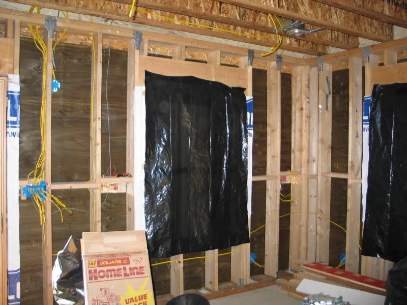

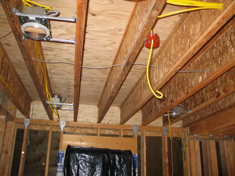

Well we have done a lot of work since my last post.  One of my friends has been helping with the plumbing and electrical.  We have pulled over 2000' feet of 12-2, 12-3, cable and telephone wire.  I hope to do one last check of things this weekend and hook everything to the breaker box, that way we can start insulating!!!!!!! :)  I never thought we would get to this point.  Pictures to follow.
Chuck
rdzone I would take the extra time to DOUBLE check the wiring and the plumbing.  Make sure that there is no wire staples into the wire. Run an OHM check on the wiring.  Pressure test your plumbing. Once the insulation and subsequent wall covering is attached it is almost impossible to fix something.
rdzone
#145
Not a problem. Thanks for the advise.  WE have been checking and double checking along the way.  As far as plumbing goes 99% of it is in the interior walls, but we will also triple check it.
some pictures

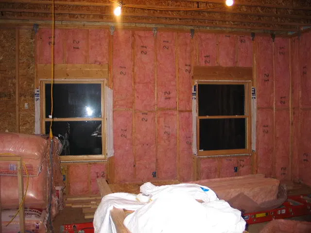

rdzone
Finally started the insulation!!!!!!!!!!!!!
Chuck
That will make a lot of difference with the temperatures!   Looking good!
poppy
OK, I just have to ask; why all the outlets going up the stairs?  ???
