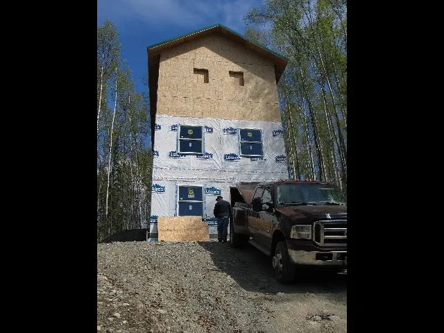

rdzone
A few new pictures.
We wanted to get all the windows in and house wrap on, but time and mother nature didn't agree with us. We are now working on the inside trying to finish up all the little things we postponed until after we got the roof on.
Chuck

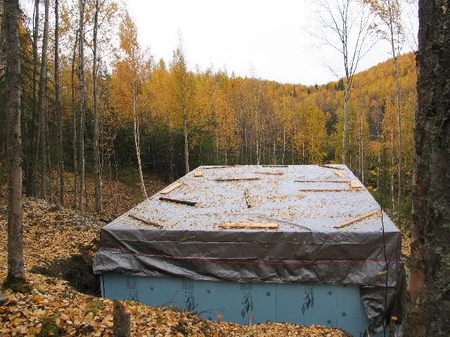

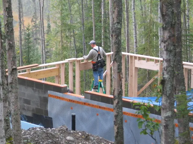

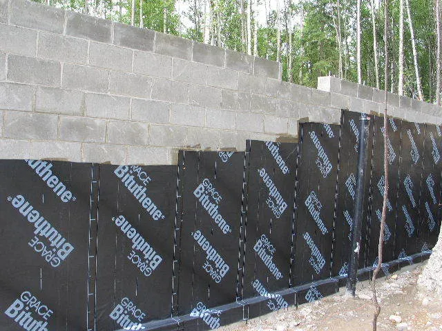

rdzone
Well Really old pictures that I finally got off my old computer.  The humble beginings of our cabin.  The first picture is where the cabin now sits.
Chuck

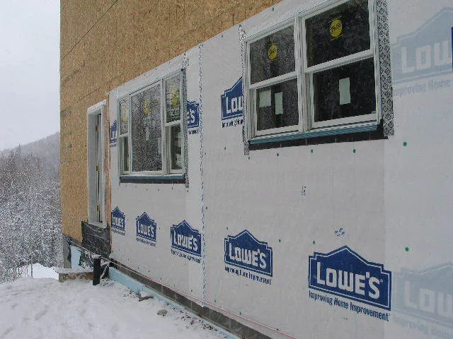

Well the weather has been cooperating and the snow has finally melted.  [cool] We have been busy doing little things here and there on the inside of the cabin until yesterday.  We finally got back to installing windows.  We intalled 3 more (two in the front and one on the side) and of course I forgot my camera.  d* I will post pictures once I take some.  The worse part has been installing the house wrap.  Lots of up and down the ladder, but we are getting there.  The t 111 siding gets delivered next weekend.  I can't wait to get the outside wrapped up.   :)
Chuck
Are you going to put any kind of screen wall drainage space between the T111 and the house wrap, Chuck?
House wrap doesn't have the greatest reputation where water may get against it - get into a hole in it then not get out of the wall causing mold problems.  A vertical batten spacer every 2 feet to put the T111 on could eliminate nearly all of the problem without going to felt to be safer.
Just a thought as it's pretty easy now.

rdzone
I promised some new pictures of our progress.  I will be halibut and salmon fishing this weekend, so no updates until next weekend.

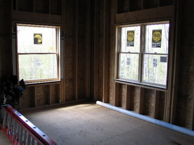

walls finished to ceiling.
interior shot of some of the 1st floor windows.

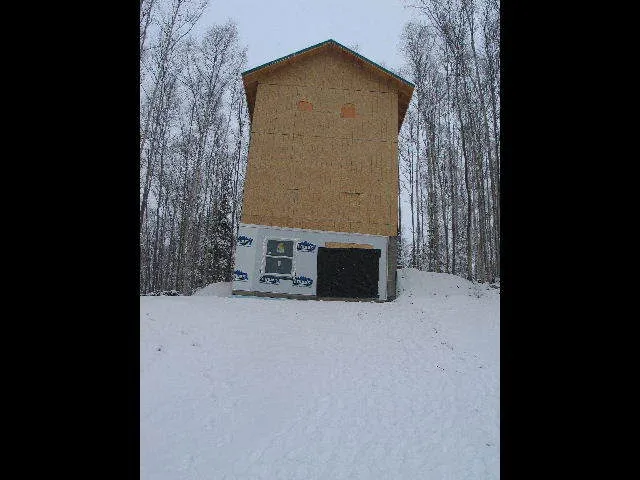

exterior shots.
Chuck
Looks good.   That last step's a doozy.
rdzone
It sure is! :)  We are planning on a small deck, which will be off the master bedroom.  It will over look the lake.  My wife can't wait.

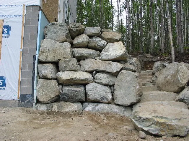

rdzone
#73

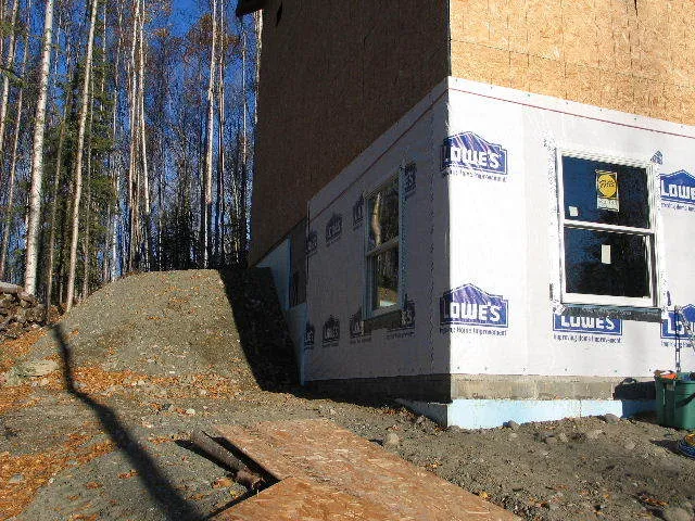

Well some more progress photos.  More house wrap and retaining walls.  We also did more interior work (blocking, floor span connectors, ect)  I must say I did a lot of up and down the ladder to install the wrap. Nothing like pushing the limits of a 32' ladder.  Boy is my back killing me ...those rocks are heavy!  ;)
Chuck
Very nice job, Chuck.  I also am doing the dry stack rock retaining wall in various areas.  As I do more of them I am not as intimidated by them and the big ones get much easier to move. :)
Looks like you knew what you were doing on the walls and for those who don't there is a book linked in the free stuff area about building them.
