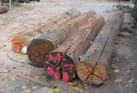

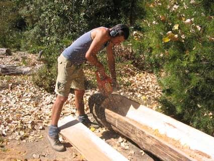

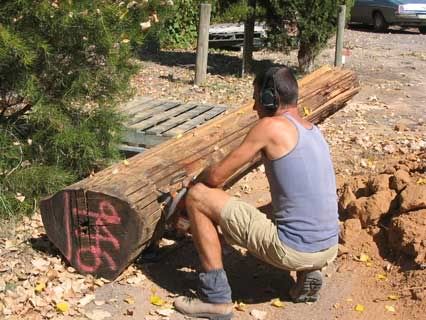

Glenn, perhaps today I'm just 'thick as a brick', but I thought the boards for your Adirondack siding were radially sawn timber - is that not the case?
We've used several logs of radially sawn timber and it's a wonderful way to keep wastage at a minimum and is being used more and more here.
Here are a couple of photos showing how the logs are delivered to the job and how they're dealt with.
cecilia (in Australia)

desdawg
Wow, I have never seen that before. I am intrigued to say the least. Tell me more about how it is done.
The reason I found you, Cecilia was the radial sawn lumber -- thanks to Jonesy for showing me your site..  Mine has a similar look but is cut after a cap is taken off one side of the log then it is rotated and sliced in 5/8" slabs of the log.  I wish I was set up to do the radial and Jonesy and I have talked about ways to do it but would take me a bit of rigging.  Great to see how it was done for you though. :)
