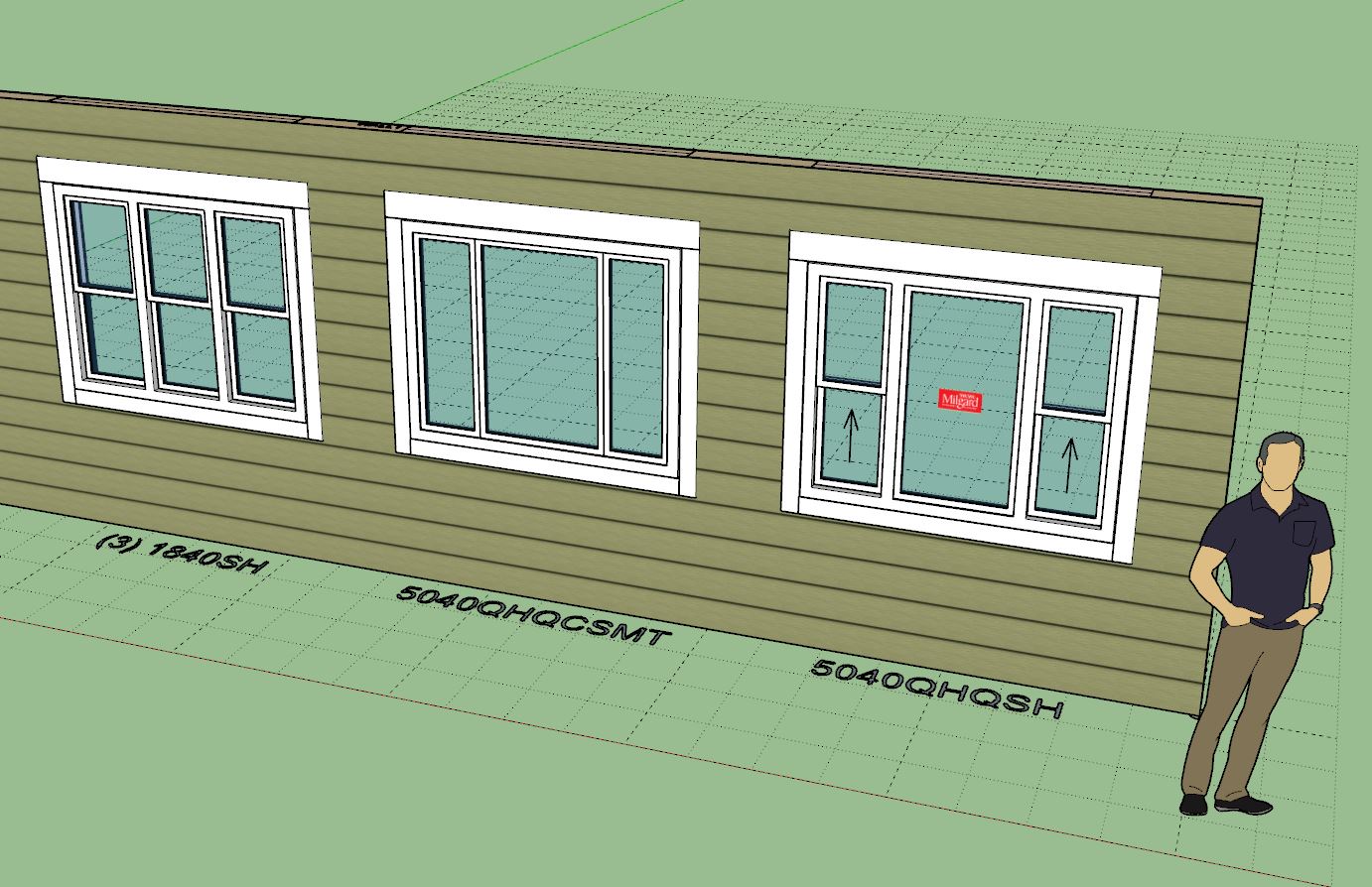

I suppose one could gang together as many window units as one would like, but two or three is probably the practical limit from a structural standpoint.
Here is a three-gang of windows with one header, utilizing the recent advanced framing options:

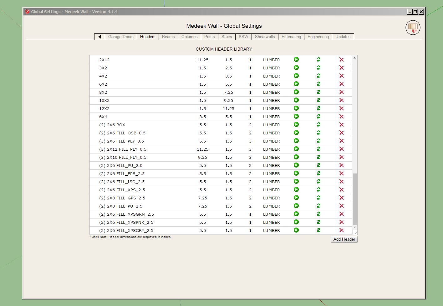

Version 4.1.4 - 11.26.2025
- Added "GPS" and "PU" foam insulation as an option for SIP wall panels.
- Enabled insulated (filled) custom headers for windows, doors and garage doors: XPS, ISO, EPS, GPS, PU.
- Insulated headers can be customized/created with the Global Settings similar to standard (OSB/PLY) headers.
- Added a QHQ Single Hung window to the window draw and edit menus.
All updates per customer requests.
Nathaniel P. Wilkerson, P.E.
Medeek

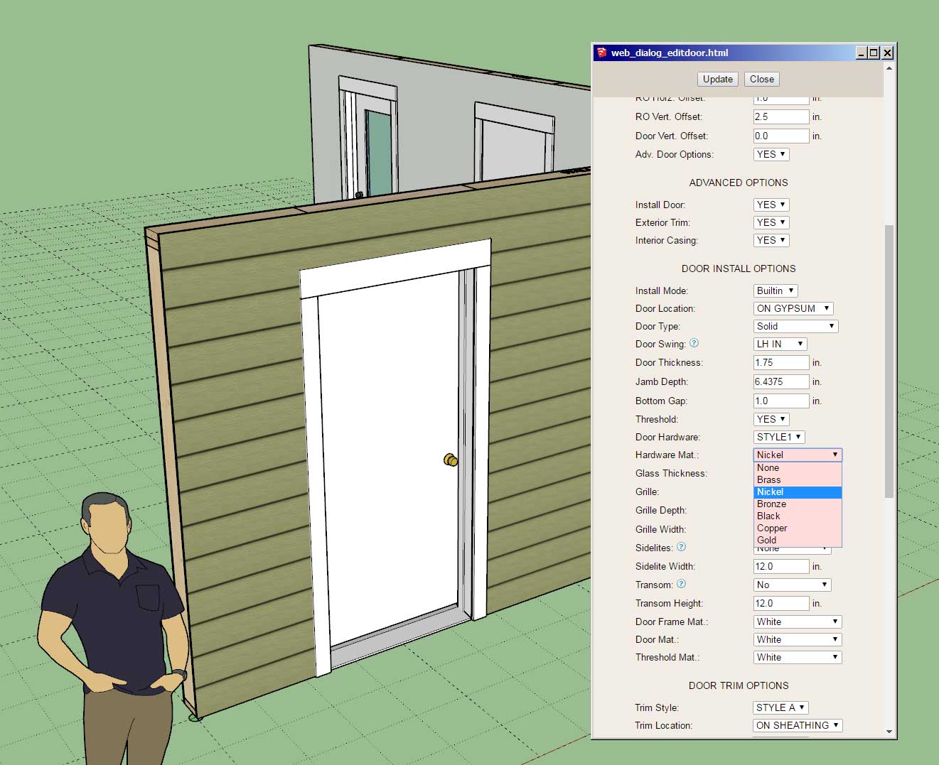

Version 4.1.5 - 11.29.2025
- Enabled Green, Pink and Grey options for XPS headers and SIP wall panels.
- Added an option in the door draw and edit menus to change the door hardware material/color: None, Brass, Nickel, Bronze, Black, Copper, Gold.
- Updated the file/component loading method for door hardware and shearwall holdowns to increase plugin performance.
