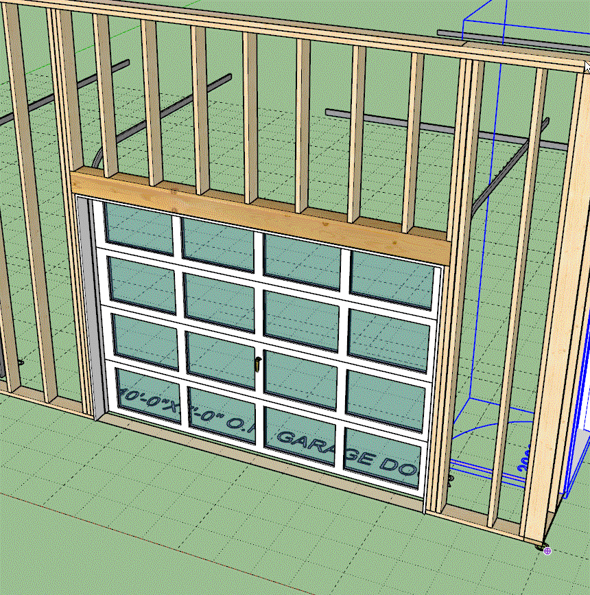

Version 4.2.0 - 12.22.2025
- Updated the opening and closing algorithm for all (panel) garage doors.
Not a customer request, just an interesting kinematic challenge that I felt like addressing at some point.  I found the previous garage door opening animation largely unsatisfactory for panel doors like these.  Hopefully you can indulge me with a little gold plating... now back to the real stuff.

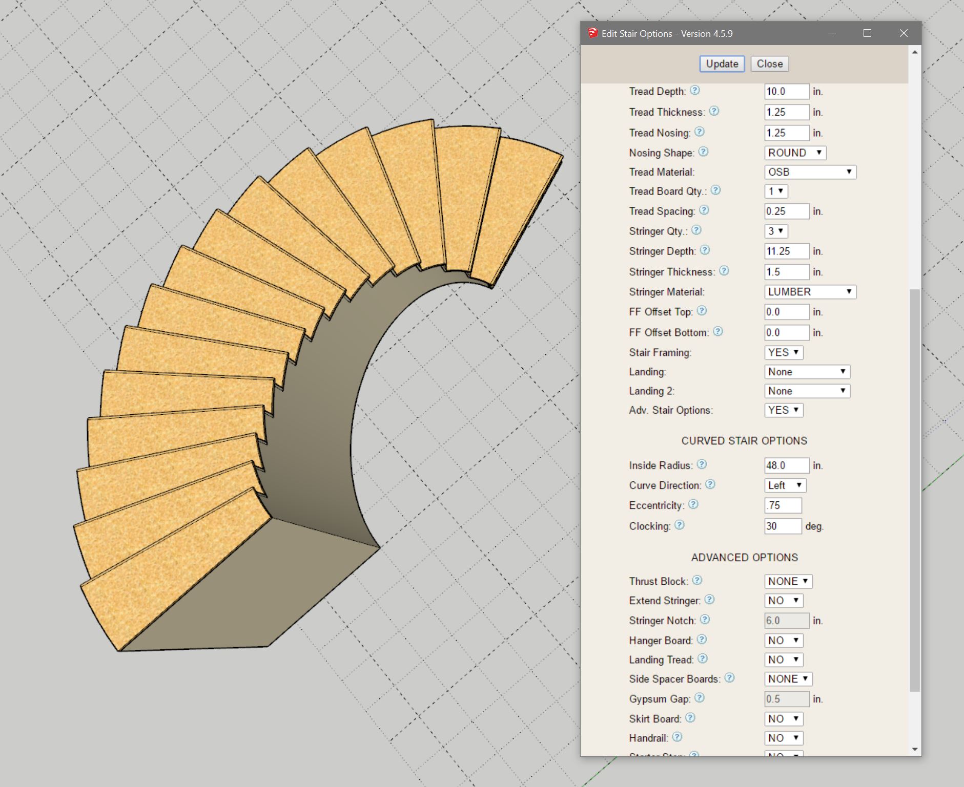

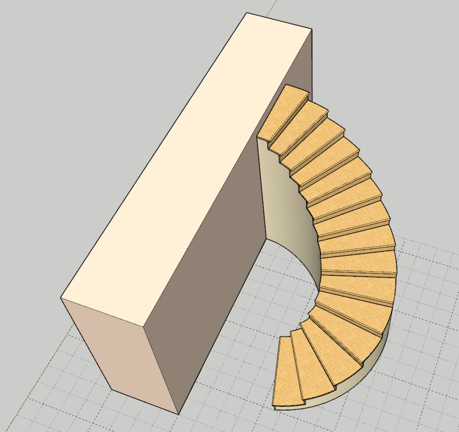

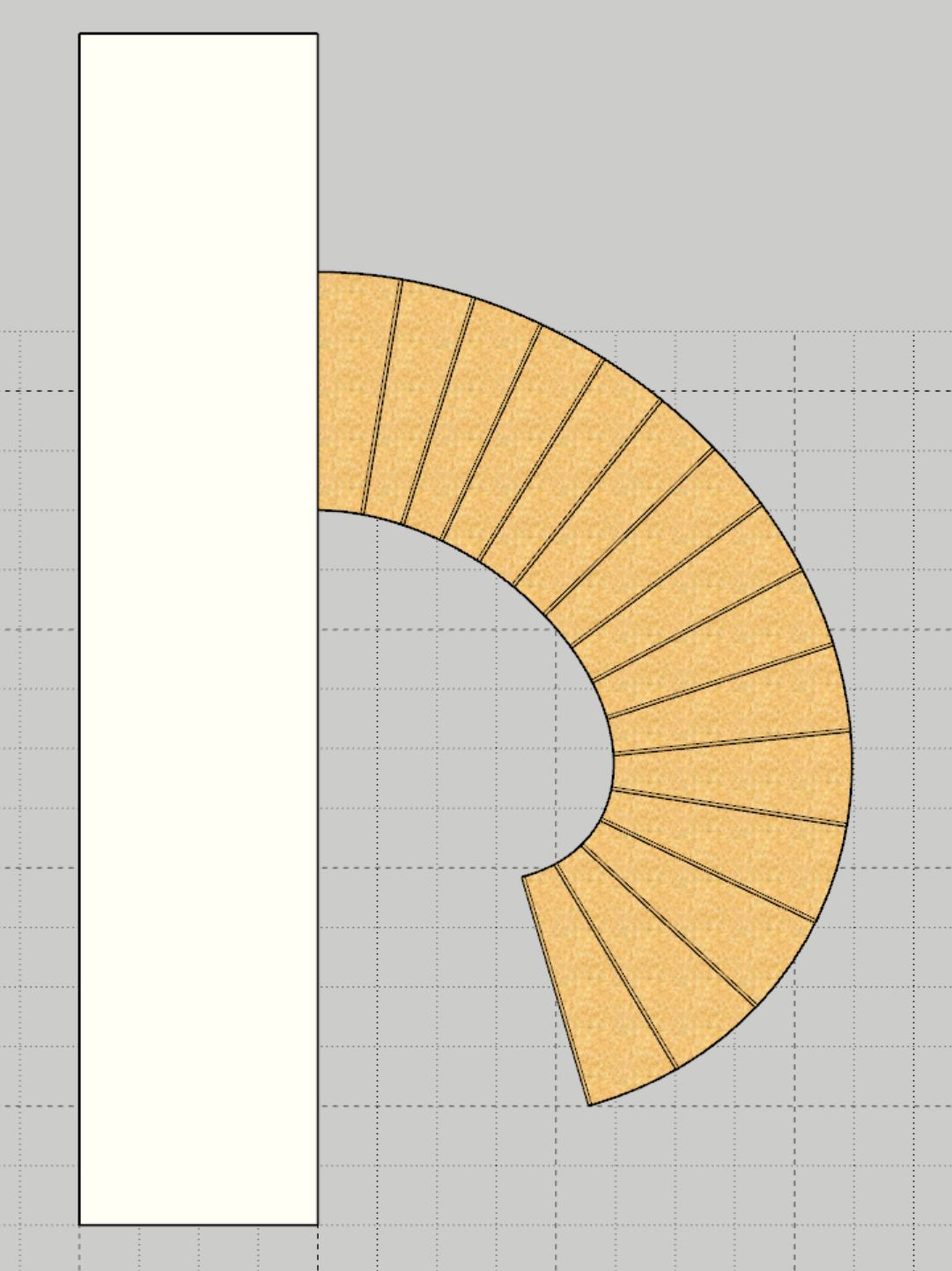

**Version 4.5.9** - 05.31.2026
- Added two new parameters for elliptical curved stairs into the draw and edit menus: Eccentricity, Clocking.
- Enabled treads, risers and framing (primitive) for curved (elliptical) stairs.
Nathaniel P. Wilkerson
Medeek Engineering
Tutorial 87 - Curved Stairs (9:20 min.)
