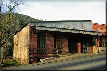

QuoteTrabucco Warehouse
The Trabucco Warehouse was built by Christopher Kerrin, who later sold it to John Trabucco for use as a warehouse. Dating from before the 1866 fire, it survived in part due to its fireproof construction. The brick walls and heavy iron doors were not always proof against the terrible fires which plagued the mining camps, but in this case they proved to be up to the task.
Another piece of information from the web:
QuoteThe Trabucco Warehouse, with the typical Gold Rush brick construction and iron shutters, dates from 1859. After a fire destroyed much of Mariposa in 1866, the fireproof warehouse advertised that it had plenty of supplies for the miners who had lost everything in the conflagration ... at exaggerated prices, of course.
The mortar was either not strong when built or deteriorated over the years with rain passing through the bricks and leaching what little lime that was in it out.  It currently has the consistancy of adobe clay with sand in it.

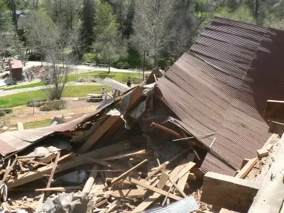

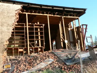

Long successful day today - the building is on the ground and safer than it was - at least.  We managed to keep the common wall which was also part of the Pizza Factory from falling.  Everything went as planned with the exception of the back wall being a bit tougher than we thought it was.
Here is a shot of the failed corner
First I removed the canopy carefully, a sheet at a time until I was able to remove the last sheets and purlins as a whole
Next I cut the rafters loose from the common brick wall that was still in use by the Pizza parlor along with cutting the lower old ceiling/roof joists where they had wrought iron attachments to the wall.  My concern was to protect the owner from liability by keeping the wall from accidently falling or being pulled over by our demolition of the building.
I insisted that the pizza parlor owner let us look in his attic and basement to check the structure before we went any farther.  As I suspected, the roof joists on their side of the common wall were set in pockets in the top of the wall.  I notified the owner that there was no question that if the wall accidently fell half of his building would go with it, and it was imperative that the wall gets shored up.  He finally realized that I was serious and got his carpenter on the project.  The carpenter jumped on it and in 1 day we were able to proceed.
After rushing Caltrans and the police through a few hoops for us we were able to get the building down and make it safe (safer).

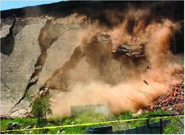

Here is the photo from this weeks paper and part of the  the story below.  It is copyright Mariposa Gazette and presented here for fair use information purposes- they change stories weekly and are hard to find online.  Here is a link to their site. http://www.mariposagazette.com/
Besides, I and the owners provided the entertainment and story. :)  I was standing on top the adjoining Pizza building as this side went down directing the action and feeling the wall for excessive shaking.
Trabucco warehouse crumbles
 By Dan Tucker
Sometime between 11: 30 p. m.
last Tu e s d a y, and 7 a. m.
Wednesday morning, the aged, deteriorated mortar between the five layers of bricks that formed the long outside wall of the historic Trabucco warehouse in downtown Mariposa reached its breaking point. It had had enough of the several weeks of pounding rain, and time took its toll as a huge chunk of the wall came crashing down, leaving the entire
structure dangerously weakened.
The owners of the building, Kitt and Judy Kahl of Le Grand, and their son Bruce Kahl of Mariposa, were quickly on the site to assess the damage and react to the situation. The Kahls purchased the building last November with the intention of rebuilding it with a similar historic appearance.
It was now obvious that the rest of the structure must come down, but the major problem was that the warehouse and the Pizza Factory shared the weakened common wall, and the foundations farther down Fifth Stre e t under the Mariposa County Arts
Council gallery and office, along with Ahern's School of Massage were attached to the common wall as well. That also put those building at risk of collapse, as well as the Pizza Factory, if the common wall didn't stand when the balance of the building was brought down.
The Kahl's hired local contractor John Mabon of Here Comes Mabon Construction, who has done extensive work to the Pizza Factory and other older buildings downtown, to build a bearing wall inside the popular restaurant in case the common wall gave way. They believed that in that way, even if the common wall didn't stand, the ceiling and roof of the Pizza Factory would.
Bruce Kahl and another local contractor, Glen Kangiser, began cutting away shared rafters while Mabon was building the bearing wall. Plans began to take shape to demolish the building as early as Friday m o r n i n g .
Bill Hilton of Hilton C o n s t ruction in Mariposa planned to brace the supporting center beam and wall of the warehouse that faced Highway 140 with his excav a t o r, while Bruce Kahl and Kangiser used pole saws f rom the Pizza Factory ro o f to cut loose ceiling rafters in the warehouse, allowing them to fall directly down.
The plan worked and after t h ree or four re s o u n d i n g thuds followed by billowing dirt and dust, most of the ceiling on the Pizza Factory side of the warehouse was safely down.
That's when Hilton and his excavator went in, tenuously pushing the roof and f ront wall to the center of the w a rehouse. Caltrans and the California Highway Patro l closed Highway 140 during the demolition and re d i re c ted traffic to Bullion Stre e t .
After about an hour of knocking large chunks out of the building, Hilton put the giant bucket of his excavator on the end of the main supporting beam and began to push. The primary fear of the Kahl's was that the building would collapse all at once, and that the common wall wouldn't hold.
As Hilton put pre s s u re on the main bean the building moaned and shuddered, and then, with one colossal
collapse, the long brick wall and half of the back brick wall gave way and down it came spewing a cloud of historic dust.

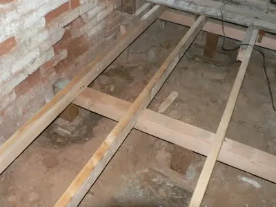

I am working on another one - this time actually getting to restore some of it.
The owner wants to restore the existing floor to original type methods and using all the original materials they could.  I was the only one who would do it the way they wanted.  The building was rebuilt after a fire in 1866 and the ground floor was probably put in around 1909 to 1935 when there was a restaurant there.
The floor had been built with salvaged lumber - 2x4's on 16 to 24" centers wth individual posts every 4 feet setting on top of plain wood pads.  We slipped 4x4's under the existing floor on 4 foot centers using treated posts and pads every 4' and treated 4x4 beams in areas near possible dampness.  In the worst areas we noted a little bug damage to the old pads into the bottom of the wood but not through it.  All foundation post locations were dug to undisturbed soil, leveled with a bit of concrete then a piece of 30 lb felt, treated pad and treated post.  The loading was calced from charts in Charlie Wing's book, "From the Ground Up."
Bad floor joist were replaced as necessary - many had multiple splices.  The object was to keep it as repairs rather than new construction. :)  As  you can see, as many original boards from the old floor were replaced as possible in the sub-floor.  The finish floor will be local t&g pine.  All beams and joists were reset with a laser.

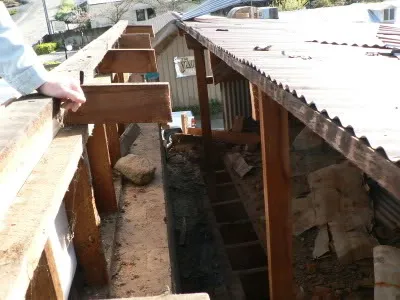

Glenn if possible get some good , great would be better venting setup to vent that space.  That , a unvented space , will be the killer of that new old floor . MTL the street outside / sidewalk's have been built up , happens everytime they pave , redo the street. Use  area wells , lots of um cuz they will fill up with crap from the street,  even with grates over them , over time , a lil bit at a time small crap / FOD. Keep the vent open in other words Clean them out , maintance routine  . G/L PEG
#17
Sounds like a good plan, PEG.  I hadn't thought much about it but the street is 10 feet above the floor on the front with a sidewalk vent grating that is already a problem with leakage.  I'll make a vent out of it possibly ducting up the wall at the back to street level.  Somehow I need to get aiir through the back 18 inches of brick or would it be possible to take it from inside the room.  I hate to put a vapor barrier on the ground as I don't want to build up a lot of moisture under it.  The area stays pretty dry as the entire street and sidewalk are uphill from it and well sealed.  Some moisture comes through the brick wall - 1866 brick so soft and porous - anybody know what the safe waterproofer is for the outside of that - I know the National Park Service has some recommendations.  I haven't researched it in a while though.
I can stop some moisture by re-routing the adjoining building downspouts.  Wet soil and 18" thick walls of brick don't mix as seen on the above building.
The west side is a walkout so possibly I can figure a way to get some air through under the above shown door and the window about 15 feet south.
The vapor barrier up here in PNW is a great idea .  If you build up moisture under it that's no big deal , as long as it can stay under . Those down spouts might be a issue if ya can't reroute um .  Even a vent system that just uses the back wall is better than nothing , if possible dbl up the # , won't be cross flow but with your conditions it will be better than nothing or whats existing , MTL ;)
I just had a revelation, PEG.  There is going to be an inner door a few feet back from the iron fire doors at the back.  I can put vents on the floor to allow outside air to go under the floor for cross ventilation to the back and box a duct up the wall to the existing sidewalk vent. The fire doors have space under them for air flow.

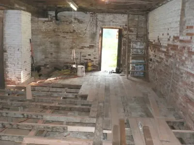

Sub-floor is nearly back together now - I got a lot of nice 1x stock from my other buddie with a sawmill to be similar to the original floor.  He has a lot of aged t&g ready to go for the finish floor.  I have the ventilation details worked out to vent the floor per PEG's suggestion - (See - I benefit from this forum too).
I ordered one of these to put down the t&g.  I could rent one but the trip to town and return it- trip would eat up all the money saved -- the rental company would have my money and I would have nothing -- Instead I will rent it out to the job a couple times myself then still have the tool.
421 Hammerhead - 2 Pneumatic Hardwood Floor Nailer
The 421 Portamatic Pneumatic Floor Nailer is the most innovative and versatile air flooring tool on the market today. This nailer has been designed from the floor up to meet the needs of today's busy floor installer and to protect prefinished and unfinished wood flooring. The tool comes ready to nail 3/4 In. flooring and accessory pads and shoes allow for quick changes to handle 9/16, 33/32 In., Bamboo and 18mm Flooring. One tap with the mallet and your nail is set, tight and in the right spot! This is the only tool in the industry that allows you to add an accessory shoe to convert for Face Nailing and also includes a sturdy carrying case to protect your investment. Our blind nailing shoe is designed to protect the top surface of your floor and our oil-less operating system ensures no oil drops or stains from oil. A quick access gate and clip system allows you to clear a jam without the use of any tools. The nail's wide head and grapple barb design provides superior holding power!
All of the information above was provided by the manufacturer or other websites. It is to be used only to outline the general purposes and features of the product.

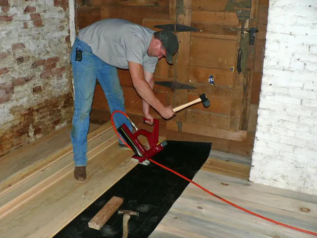

The first half of the subfloor is in and now we are putting in the pine floor.  This is local wood from a local mill just as they would have used in the old days.
The nail gun calls for a felt vapor barrier between the finshed floor and the sub-floor.  It also calls for the first 2 to 4 courses of flooring to be face nailed -it comes with a different shoe for that.  The shoe being used here puts the nails in just above the tongue and just after the rubber mallet hits the head it shoots a nail pushing the board up just a bit tighter, locking it in place.  It uses special cut nails - This one is called Porta-nails.  The nails have teeth to keep them tight.
It started out shooting 2 nails at once, but after a little fine tuning it was working great.  If there are problems be sure to read the instructions to avoid breaking something.  I did it right.  (This time).
Fred nails down the floor.
The hammer and 2x4 are used to knock the boards together without damaging to tongue.  The rubber mallet can be used but the 2x4 is more positive as the board gets a bit tight to get together once in a while.  It doesn't show well here but there are gaps left from the brick wall to allow for expansion and prevent transfer of moisture from the bricks to the boards.
We are continuing to rebuild using as much of the original materials as possible.  (I wonder if they had one of those cool nail guns in 1866?)
