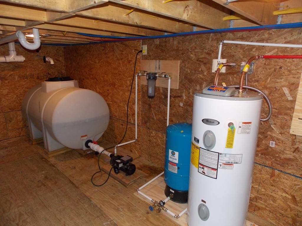

This is my system.  I have a 350 Gal storage tank, Water pump, Pressure tank and hot water heater.  I do not keep it filled in the winter and would have to come up with some form of heat to keep the system from freezing. I also used PVC pipe to create a fill tube that you can see coming out of the wall about the water storage tank.

I found the pressure tank at a Habitat for Humanity re-store, for $50.00, I bought the least expensive water pump that tractor supply carries. I also found the electric hot water heater at Lowes on clearance. My water tank is 350 gal and that is more than enough for my wife and I to be at camp for a week both taking showers daily.

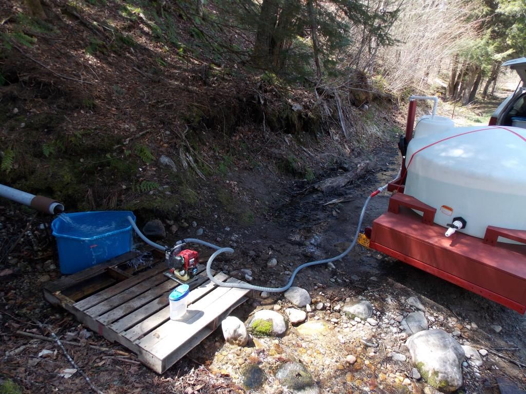

I found a Pick up truck style water tank, for $200.00 on Craig's list, that I have mounted on a small Harbor freight trailer.
It works very well for a budget system. The only issue I have is with water pressure and I am sure that is just a setting on the water pump that I need to figure out. I do not know the size of my pressure tank but it is suited for my system as the pump does not run very often.
