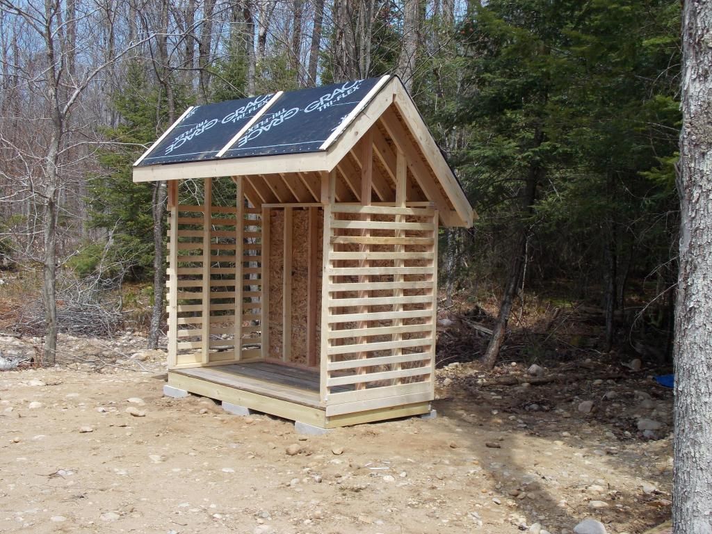

I have been searching Google images and have found the closest thing to what I want to build.
I am planning to make it 10' long and 4 feet deep.  I also want to make the walls out of 4" pine install horizontally and skipping every other one to give plenty of ventilation.
Any thoughts?

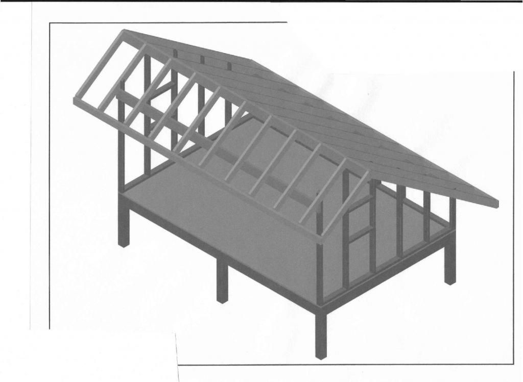

I found a plan close to what I want to build.
The plan had a scale of 1:10, I think it was for a train set?
My plan is to make the base of mine 4' x 8'. I cut down the plan side to Make it 4' deep.

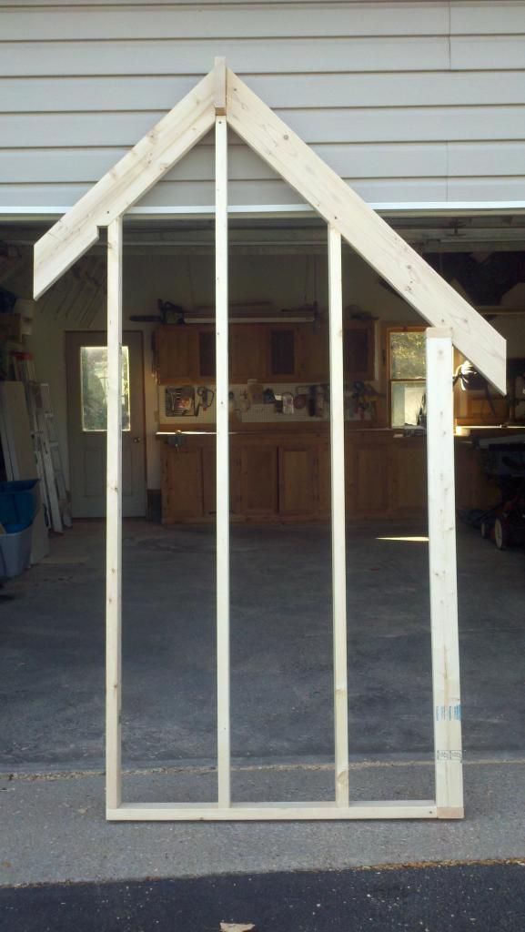

Today I made one of the sides. I guess I will have to take it a part and store it for the winter.  Come on spring.
