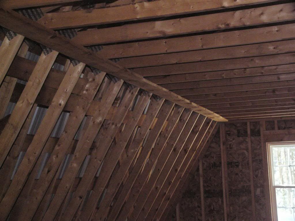

in the processing of trying to buy a place that has a garage with a metal roof on purlins but no sheathing, if I wish to insulate the second floor are there any alternatives to either closed cell spray foam or redoing the roof?
I assume with normal batting I would have serious condensation issues?

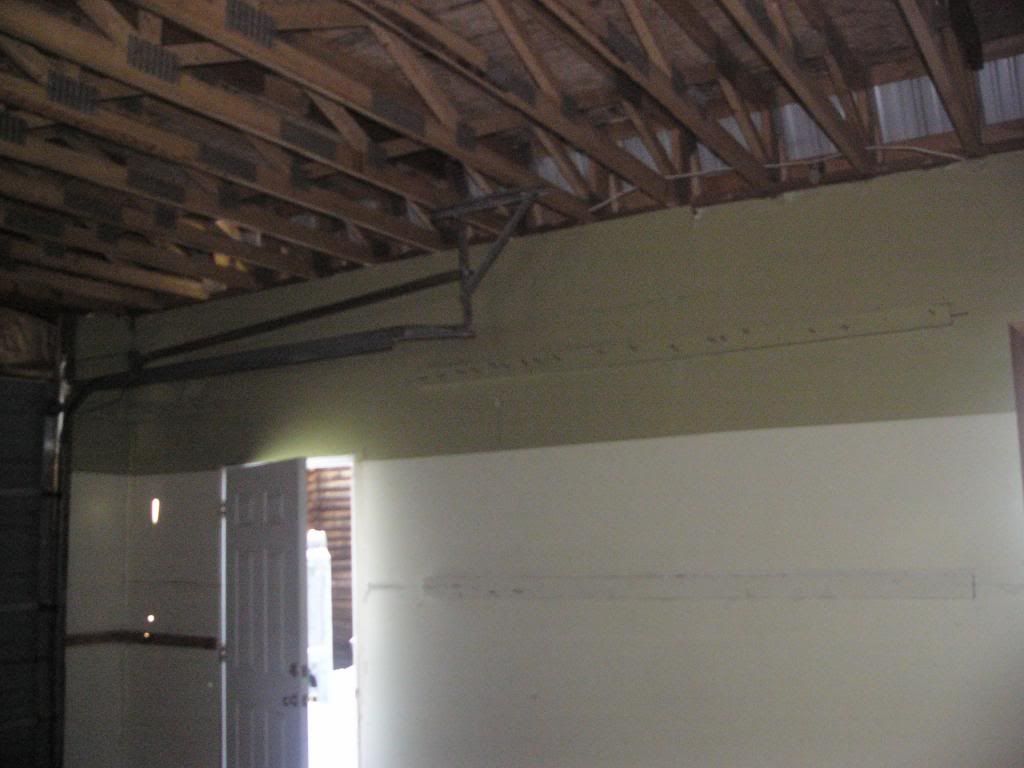

Is the situtation I have ( or will ife the closing ever happens)
I guess for now I could just insulate the garage ceiling trusses, and deal with the upstares space later if i decide to finish it.
(walls are already insulated, apparently the garage had a roof collapse at some point and they removed it and put new trusses on but never insulated the roof or ceiling again)

Don from the photographs it looks like that will be a room upstairs.  The walls are actually the trusses on the inside.  They will sweat as well so I would treat the walls the same as the ceiling.  I would throw caution in the wind that just because walls are almost verticle it will mean that the water will run down those as well .

there is a room upstairs, but it may not be need as conditioned space, I guess simplest for now would be to strap the ceiling and insulate with bats, and leave the attic truss as effectively unfinished attic space, which would also cut by about 70% the amount of space needing to be heated, and make the upstairs easier to heat later if I did get the roof foamed.
