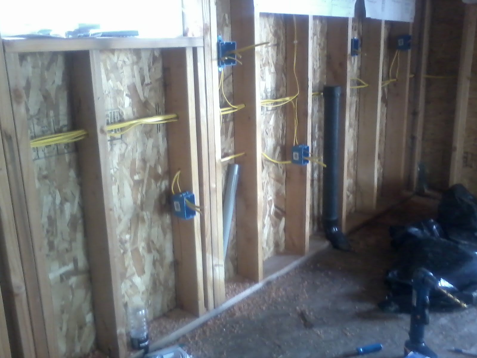

Mia
Thanks, all.
We have looked in books, every library book we can find that might have photos of wiring.  We own 2 books with current code info, & lots of older books that are pretty much useless.  Can find lots of drawings of how circuits should should run, but not photos.
What I am hoping to find is a photo of one whole wall, either living room or bedroom or kitchen, with the rough-in wiring done, like it is supposed to be.  There are photos of wiring mistakes, but not a whole room (or even one wall) done right.
My husband has wired most of the kitchen outlets, & the boxes look right, but the cable doesn't look right to me.  It's kinda slack between outlets.  And I don't know if it is required for the cable to run through the stubs above the outlets, like, at 20" above the floor for oulets that are 12" above the floor.  (kitchen outlets are higher of course)
So, that is what I am looking for & not finding.

As far as I remember there is no stated rule about keeping the wire taut between points A & B, but it is usual practice. The rules revolve more around proper stapling...  sorry no pictures
-- Within 8 in. of boxes without cable clamps or within 12 in. of boxes with cable clamps. Most plastic boxes for two or more switches have built-in cable clamps.
-- Every 4 ft. 6 in. along framing members like joists and studs. This is the maximum distance. Many electricians put them closer as needed.
-- Within 12 in. of where a cable runs through a hole and continues along a framing member, like a ceiling joist.
Because cables must be kept at least 1-1/4 in. from the face of studs, you can't staple them side by side along a 2x4. The electrical code also prohibits you from placing more than one cable under standard 1/2-in. staples.
I work from one point and run the wire through the stud holes, staple at the beginning end, go to the other, pull taut and staple again at the other end.
The ADA does have some height restrictions on switch and receptacle heights, but that does not apply to typical residences.

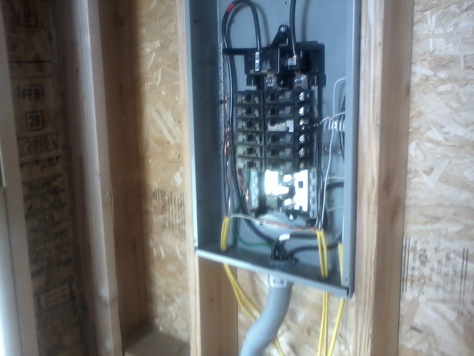

Inspectors I've had seem to concentrate on stapling the right distances / spacing as well as having left sufficient length for all the wires in a box (6" IIRC) and not having too many wires in a box. And grounds with metal boxes.
They also seem to like seeing things neat and tidy in the service panel. Wires making right angle turns and runs being vertical or horizontal, not diagonally from here to there. Not sure if that's code, but it does look neater, makes it look more like you know what you're doing.

Yes, thank you!  I am much reassured.  we seem to be doing it right.  and the inspector will let us know if we aren't.    8)
