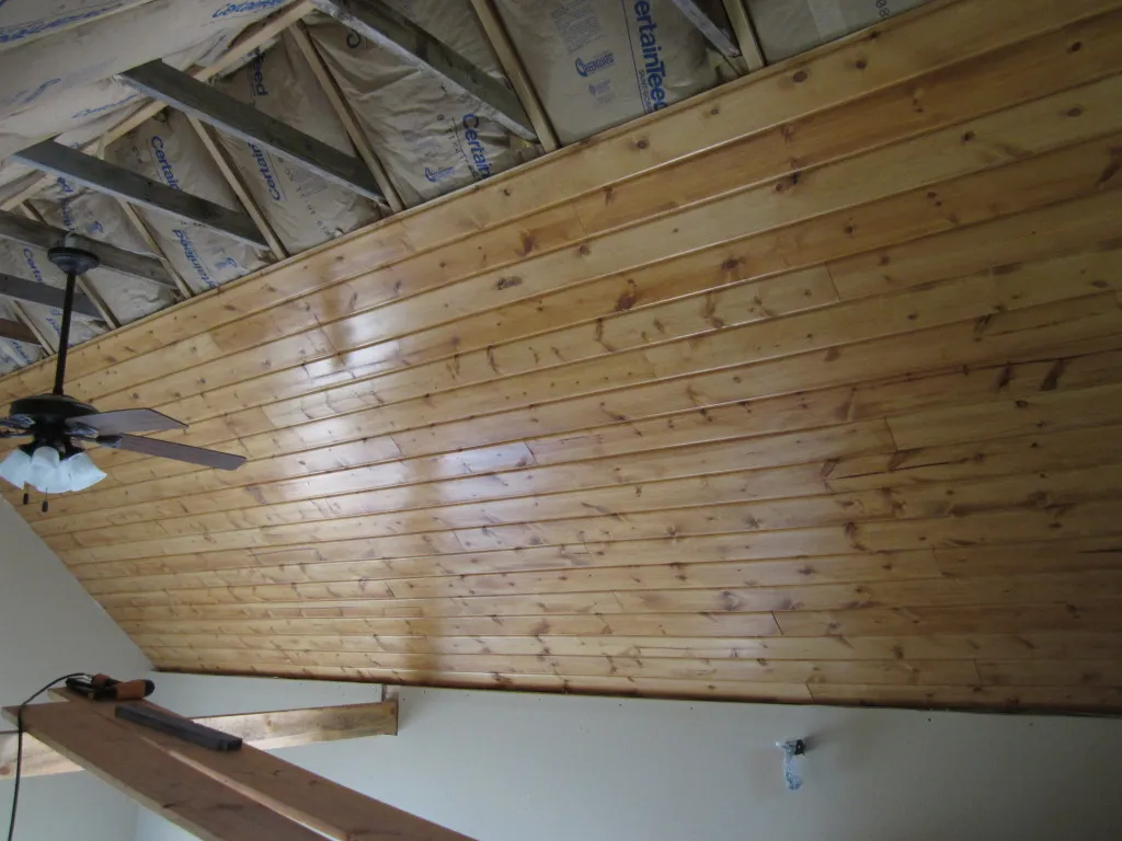

Well after repeated attemps to scan a little sketch of what I was talking about I gave up in trying to convert it so that Photobucket would except it.  I just photographed it and we will see how it turns out.  You might have to make some adjustments to the demensions to fit you particular board width and the space between the jig and what you have already installed to allow the board to slip up into it.  An alternative would be to use a thicker block for attachment to the rafter and the retaining strip(outside block) could be extended to meet (lap over) the previous board.  Then when it is attached to the rafter at the end of the board being installed you could just slip it into the opening.  As you work your way from one end of the present board to the jig you just remove it for the attachment to that last rafter.

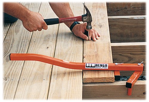

As for the tool Erin pistured is good to pull the bow out but doesn't do much to hold the other end.  I have used one similar and it worked great.  But you will need to cut a scrap piece of T&G to fit up against the pressure point on the tool.  If not you will mar or damage the T&G edge.  The one that I used I could convert it to 4" beams to put my 2" flooring T&G down with but the bars on either side of the beam began damaging the beam side and I abandoned it and went with pipe clamps and chisels to but them in place. But with rafters or floor joist/beams that damage will not be seen.
Here is the basic design that I used.
I had a very nice shipment and wasted less than the 10% I allowed for when ordering.
