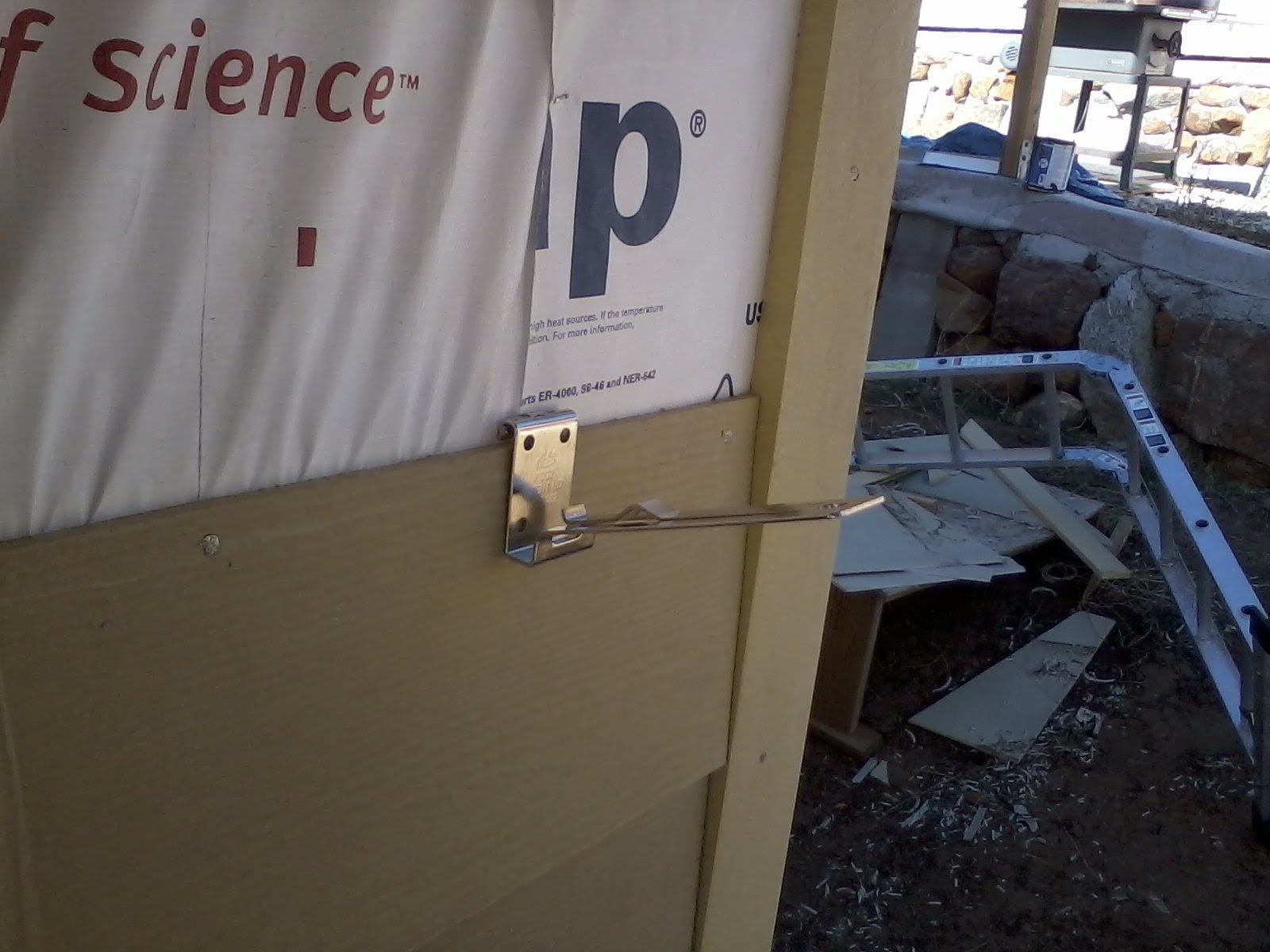

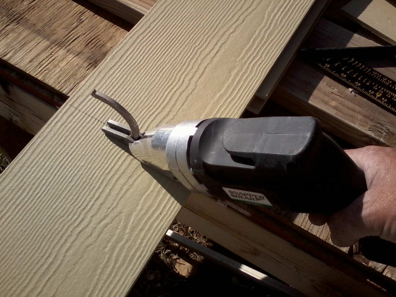

flyingvan
If you use fiber cement, invest in a pair of shears.  I paid $170 for mine--there is no dust whatsoever.  Also you can get this cool hangar/gauge set online, I think I paid $28 for that.
  This clip holds one end of the board
   This guage (adjustable) assures the correct exposure
   You're still gonna need a diamond blade for rip cuts around windows and stuff
Thanks for that post Flyingvan. Very helpful and the pictures are a big help visualizing the tools.
