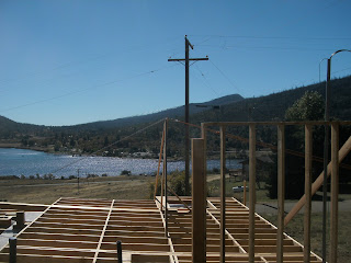

    You can frame a wall multiple stories (It's called balloon framing).  I did it on one wall, where it's open floor to ceiling.  This wall is 17' tall.  You do have to provide fireblocking a minimum of every eight feet.  The pro's are--you have a nice story pole to measure off for everything else.  It's also stronger if there's a wind load (like I have) instead of stacking two frames---unless there is a vertical floor between them.  The cons are---finding straight studs that are 17' long is hard.  Raising the wall was scary and difficult.
