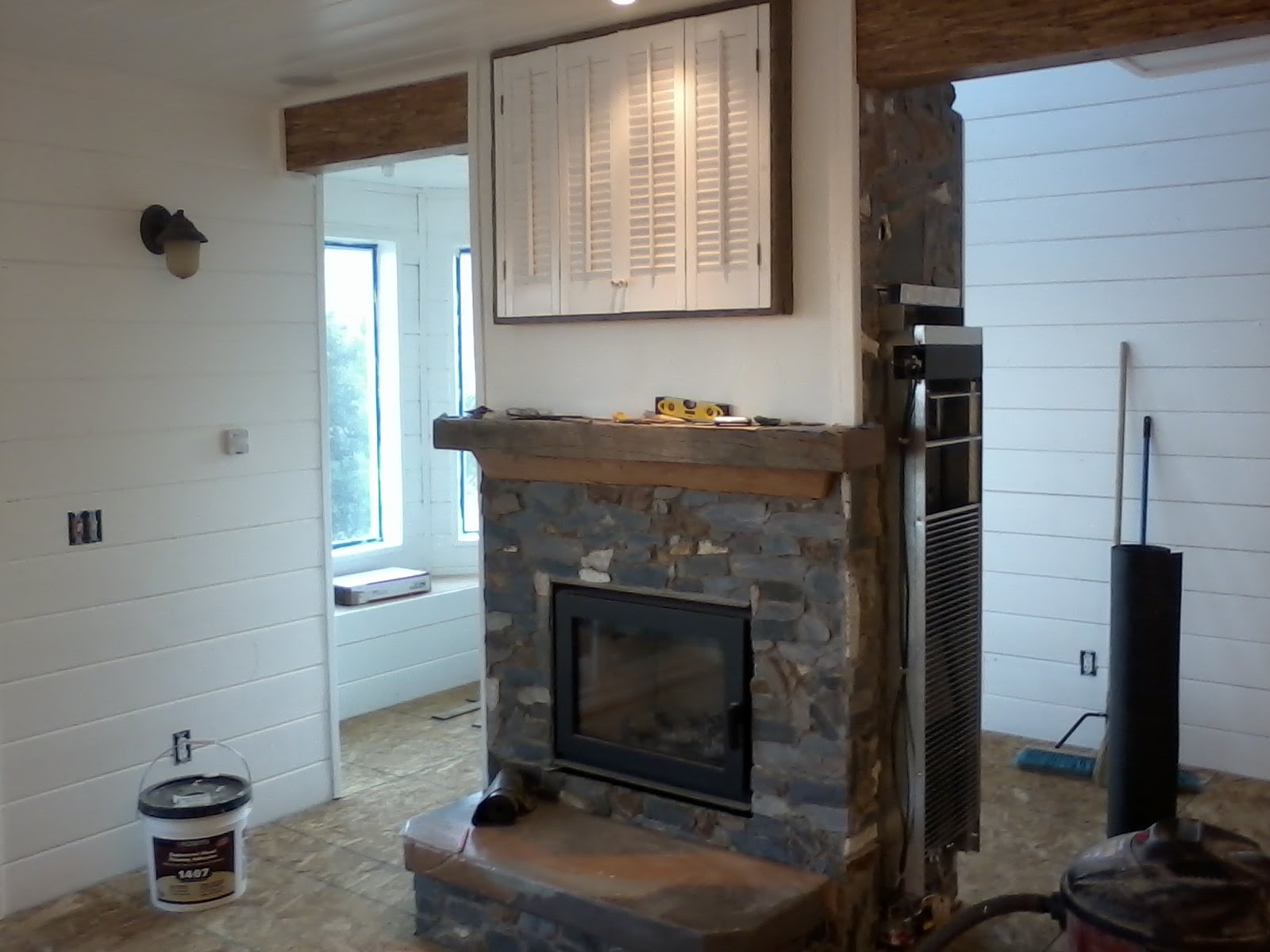

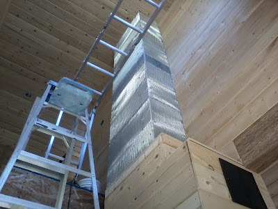

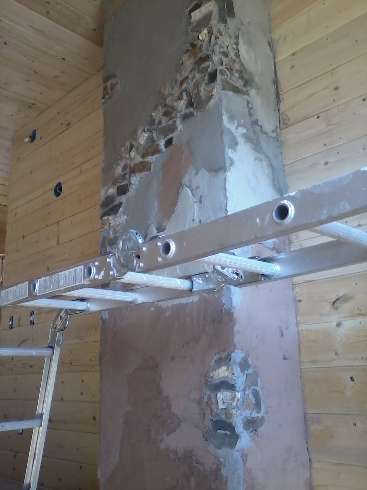

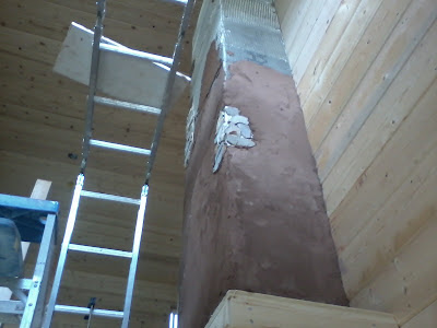

  All the interior tongue and groove is in.  Before I can paint though it has to be trimmed, and before it's trimmed I have to finish the chimney.  The chase was built as flat to the wall as possible so it wouldn't block the view from the reading nook out the picture window, and the clearence was 2" to any combustables so the backerboard is supported in the corners with framing.  The flue for the gravity wall furnace is in the chase as well.  Ceiling height here is 18', one of the features that makes this tiny place feel big.  (There will be a register on the ceiling with a thermostat controlled blower so in the winter when the ceiling gets hot, either from the wall furnace or the fireplace, it'll kick on and the air gets ducted to the downstairs.  Both heat sources are independent of electricity so when we get one of our frequent power failures there'll still be heat just not as much circulation)

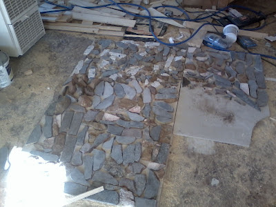

  Spent two days cutting up stones for the veneer.  Tedious.  Laid them all out so I could select them quickly while the mastic was setting up.

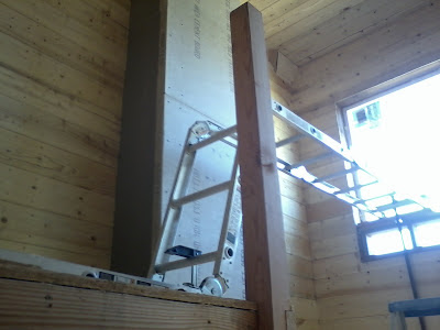

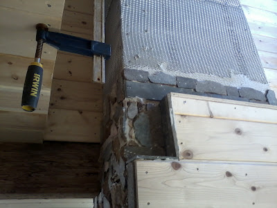

   The chase is clad in hardibacker....These 4 position ladders are worth their weight in gold.  Both ends are clamped so it wouldn't wiggle.
   I wanted the steel mesh to wrap all the way around so it would get screwed into the strongest framing up against the wall.  I added washers to the screws too so they wouldn't squeeze themselves through.   One side was pre-bent so there wouldn't be a lot of measuring or centering once up the ladder.
    Now to start with the stone veneer.  I would have loved to veneer the entire chimney but it would be very heavy, and it would take two weeks just to cut up the stones.
    So instead there are stone outcroppings with a colored plaster making up the majority.  I have to keep it to 25 pound batches---with all the ups and downs and not fallings, it sets up faster than I can use up a whole 50 pound bag.
    The stone outcroppings match the fireplace surround, the rest of it matches the foundation.

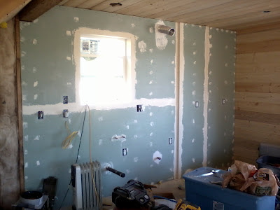

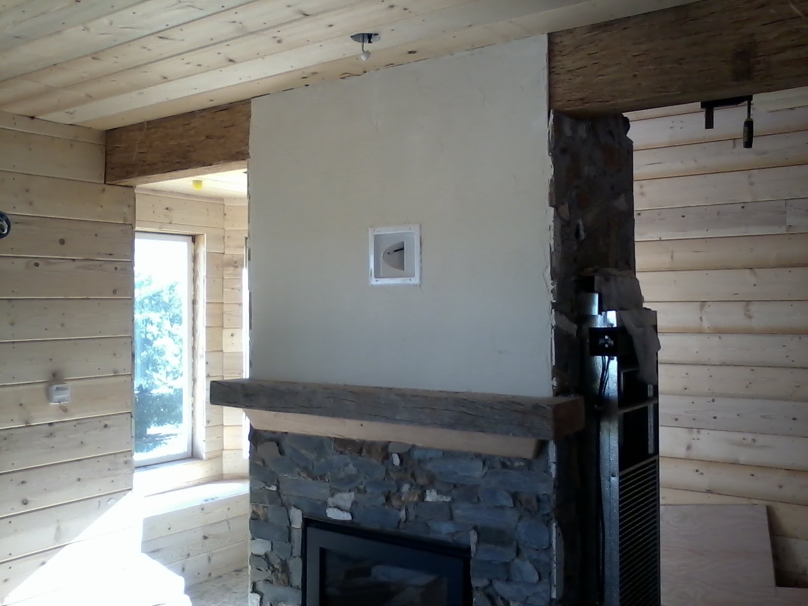

  Not a huge drywall fan, but it made sense in a few spots----the kitchen wall that's covered with cabinets and slate, over the fireplace mantel where the TV will be mounted and hidden behind shutters, and the bathroom walls.
  It all got a rough texture that I think goes with the 'cottage' feel.  My wife thought it too rough so I'll sand it with a wet drywall sponge to smooth is some.

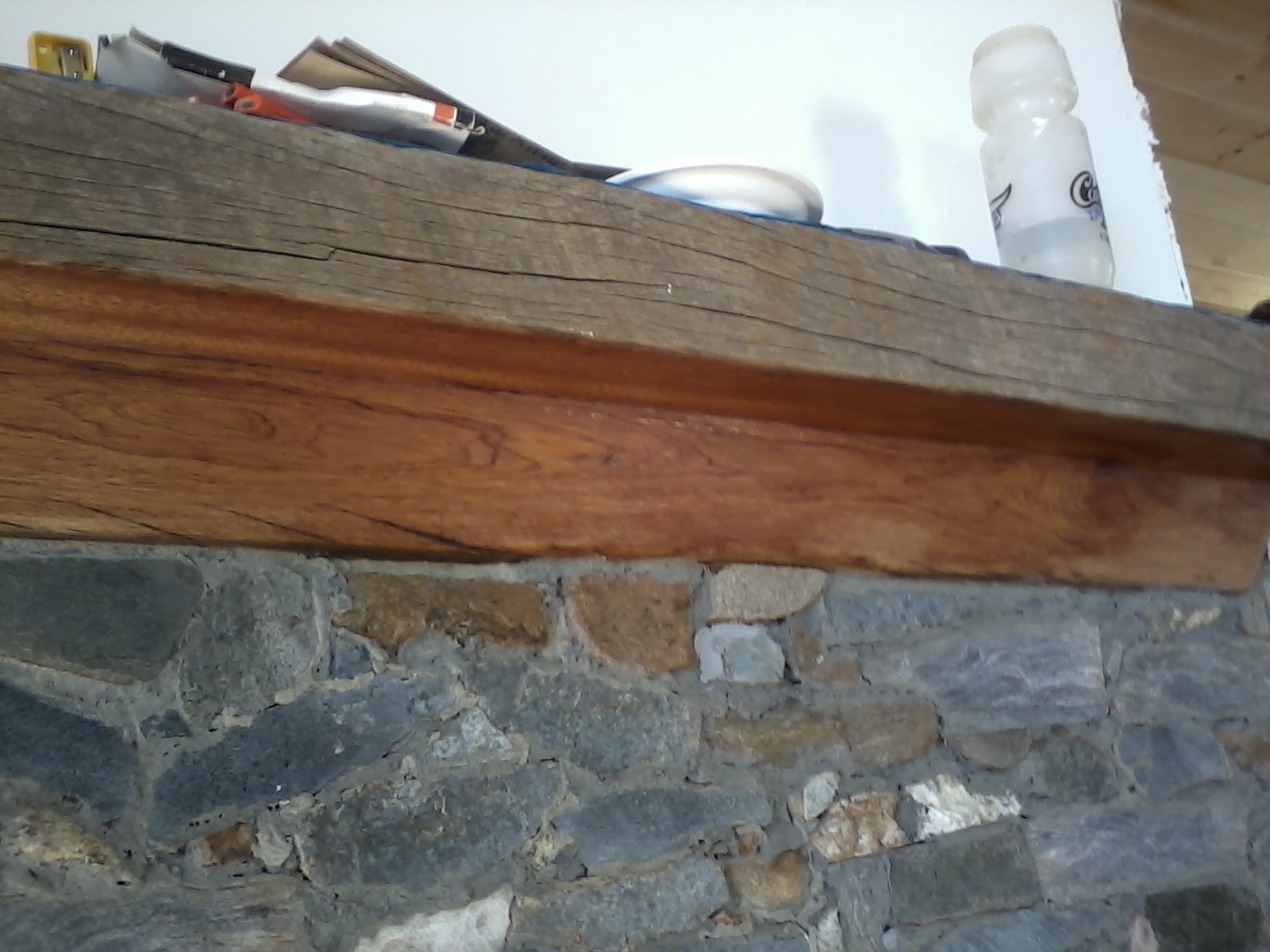

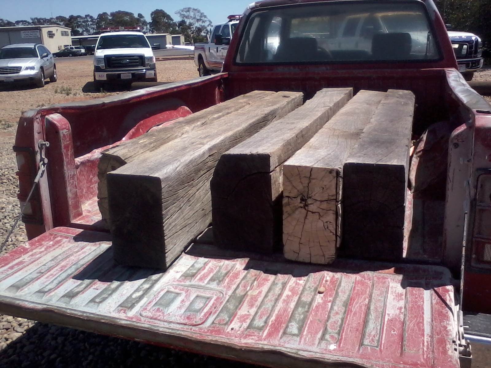

   She loves the mantel that I cut from a solid beam I dug out of a dumpster---I thout it was fir until I cut into it, then thought it was red oak.  She would really like the railing and balusters to all be the same stuff.  I found some naturally weathered oak but none of it looked like the mantel.  Turns out it isn't oak.

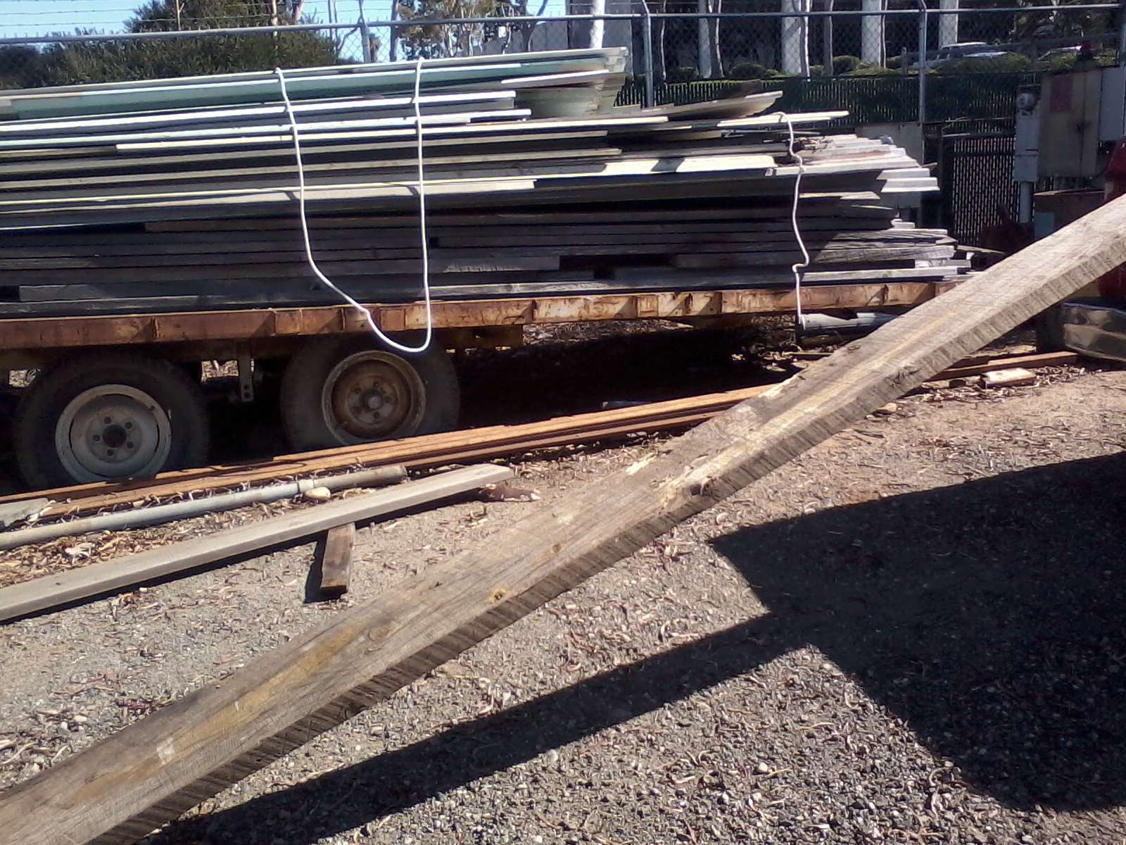

    I went to the boneyard near where I found the original chunk and talked to the owner.  He told me his brother helped build a tall masted ship decades ago and held on to the beam cutoffs, just left them out in the weather.  I had to dig through a lot of stuff and move a bunch of old aviation parts.
   These things are HEAVY.  I found five that were relatively check free and had no bug or rot damage.  THey are 8x12 true dimension and about 7' long.
    I'm hitting a friend up for yet another favor.  He's got access to some big band saws.  I tried every local business----no one wants to mill lumber they didn't sell you.  It's getting cut into 1 1/2"x 1 1/2" for the balusters.  If it seems like stable stuff and the saws get through it OK, I might make the rail and stair treads out of it too.  I'll still have some left over.
    I'm pretty sure it's teak.

     OK.  Now I'm embarrassed.    I used to go to Frost Hardwood just to look at the different species, but this has me stumped.  It's not teak, might be some sort of oak or mahogany.   In any event it's the same as the mantel which is what AnnaMarie wanted, and that's what is important.
      NOBODY in Sandy Eggo will mill stuff they didn't sell you.  Scared of nails, I suppose.  What am I gonna do with 8x12's I want cut into 2x2's of some unknown hardwood?

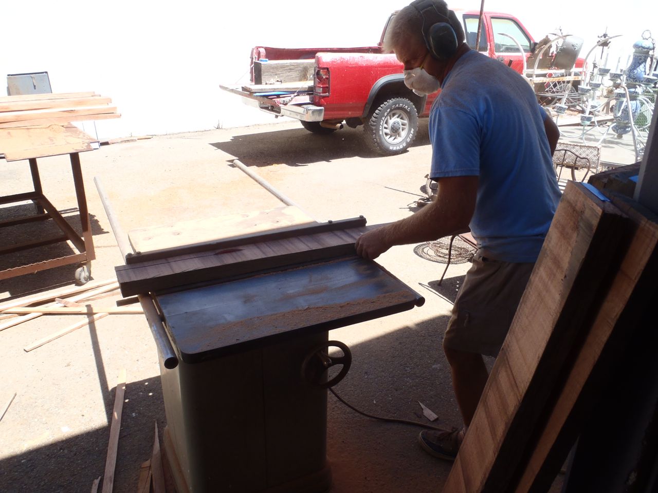

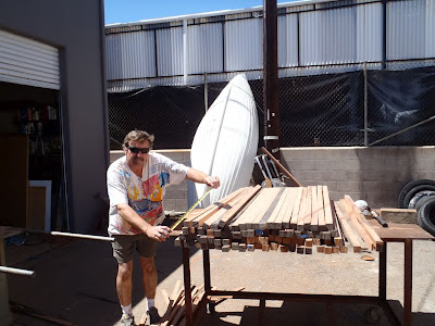

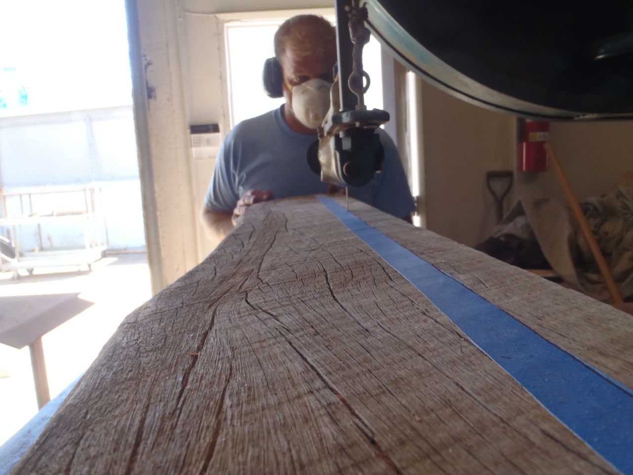

      So I loaded them in the old truck (passed 200,000 miles on this trip) and lugged them up to Newport Beach where a buddy has access to some big tools.
       Here we're ripping the beam into slabs.  It was slow going until we replaced the blade (after blowing the circuit breaker) then it was like cutting butter.
     Then the slabs got ripped down to baluster size.
     This is my go to guy that bails me out whenever something like this comes up.  More than enough balusters, ready to go.

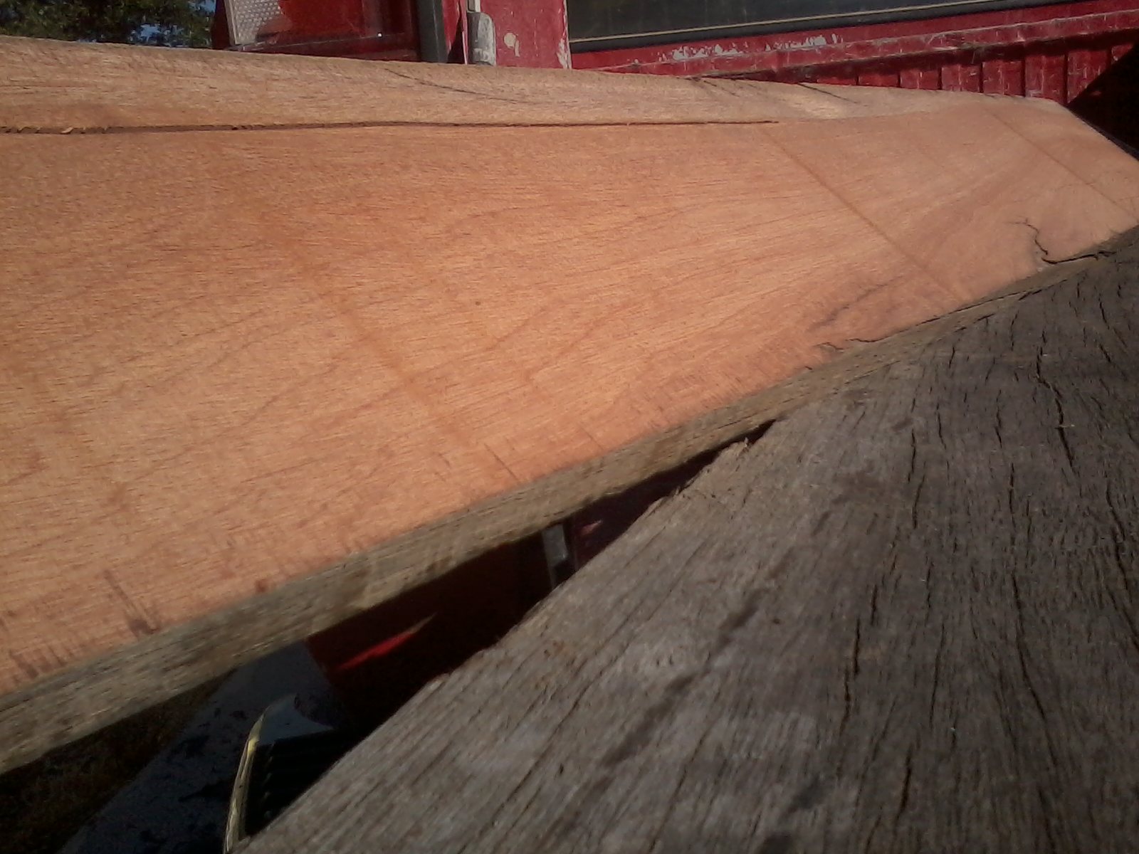

I looked online at cypress, I don't think that's it.  Here's what I know----it's hard and heavy.  It was cut into 8x12 beams for a shipwright 35 years ago.  The surface patina is thin.  It's reddish when first cut and sort of oxidizes to a warm pale after a few weeks.  It is very stable, not twisting or warping even when left outside for a long time

OK here's a picture of it.  If it's oak it isn't the same species I've done stuff with in the past

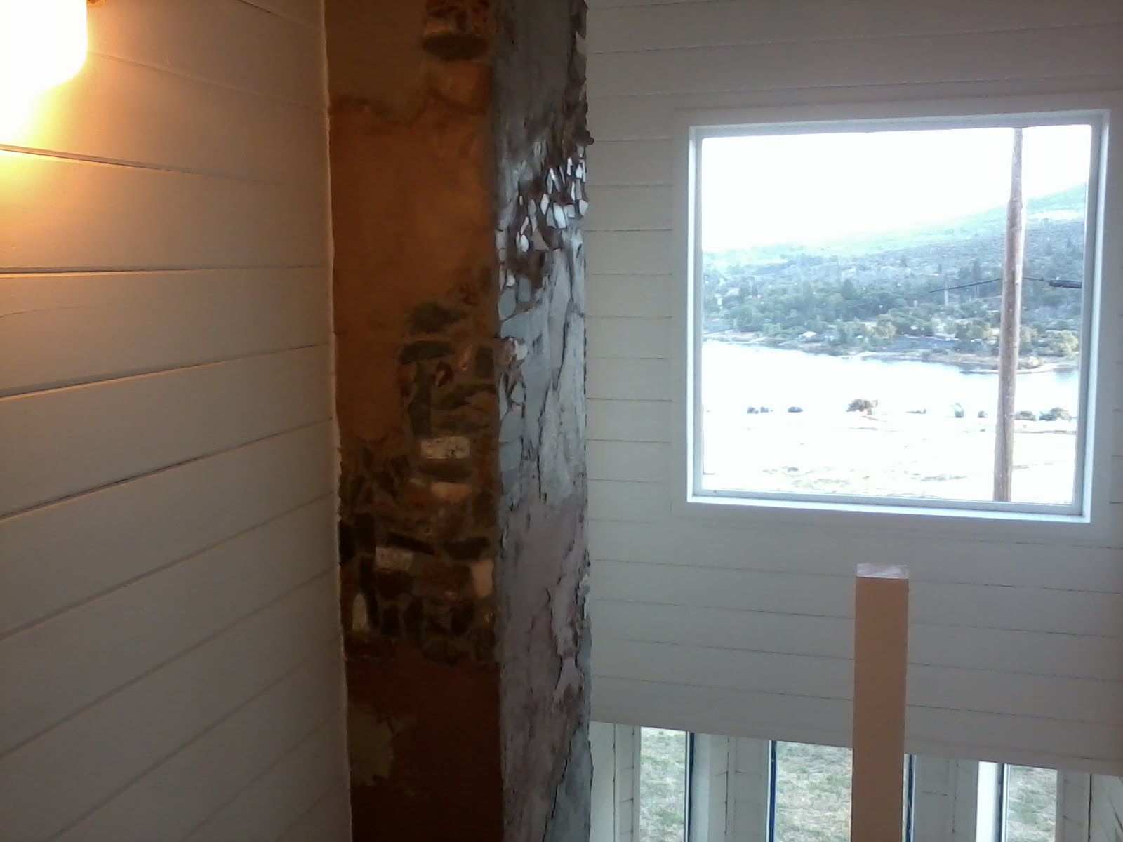

In the homestretch now.  There's going to be a countertop that turns an 'L' and forms a bar...My mom was down for a visit and suggested a pantry behind the bar seating under the stairs.  It was a good suggestion.  Also the parallam beam that holds up the second floor got a deep sanding a a few coats of polyclear varnish.
  The chimney chase was a challenge.  My wife wanted it to match the boulders outside, and have some cut stones, too.  The stones all came from the lot.  This view is taken from way up a ladder.  It looks best kind of edge on, the only way you'll see it from inside.

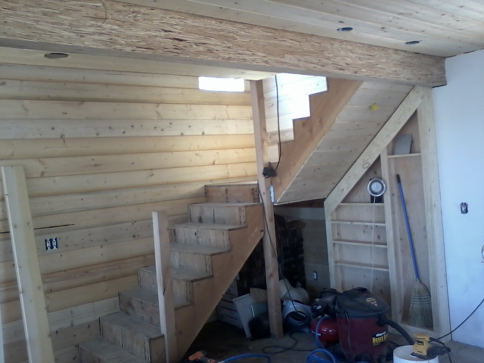

    Here's the mantel.  It's the same mystery wood that I've cut up to use for the stair rails and balusters.  I'm not sure what it is but it sure is pretty with a few coats of varnish on.

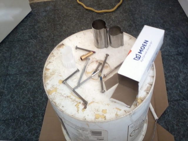

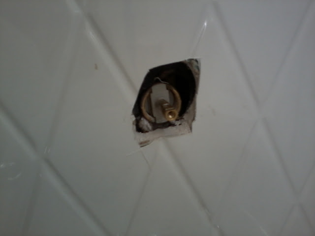

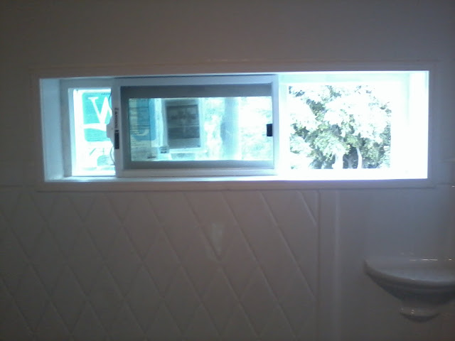

   Plumbing issues---finishing the bathroom now.  THe window had to be lower so my wife could reach it which meant cutting the tub surround and adding vinyl corner trim around the window opening.  The trim is gooped into place with silicone and no voids so water won't get underneath and no nails to corrode.  The drywall mud on the sill is waterproof too.  I wanted to slope the sill so shampoo bottles won't end up there but that would have meant cutting more of the surround.
  Months ago when I sweated in the plumbing mixer I placed it in the middle of the wall so nails couldn't reach the pipes from either side.  So when I went to install the tub handle and faceplate, it was too deep for the screws to reach.
  I got onto efaucets and they offer a variety of extension kits that solved the problem for me.
This harkens back to the 'lessons learned' thread---had to stop working in the bathroom and go do something else until the kit came.  There were plenty of 'something else's' to do.

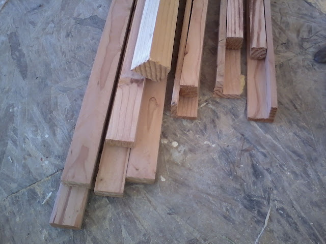

      Really bad boards were set aside for short pieces like fire blocking.  The vast majority, which were just fine, went into framing.  The rare clear board---straight with few knots and good grain---were set aside for the trimwork stage.
      I can just buy a stick of crown moulding for around $14.  Lots of it gets wasted.  With a table saw and palm sander, it's a lot cheaper to make my own (and I get exactly the shapes I need)
        Hidden inside one $8 2x10x12,  there were 5 crown mouldings, 3 outside corners, 3 inside corners, and a funny angle piece for where the sloped ceiling meets the wall (this one actually got cut further for an inside corner piece too)
   They all get sanded smooth.  The outside corners get run through the table saw set at 45 degrees to round off the corners, then sanded really deep---people always scrape against outside corners so the more rounded, the better

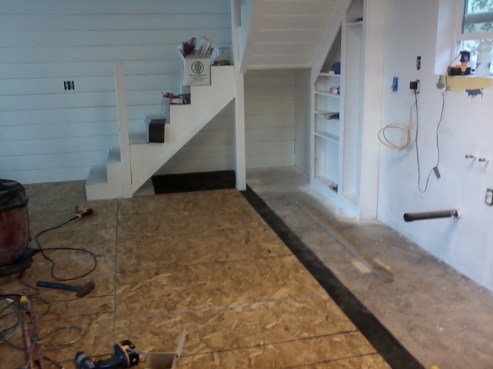

    My subfloor got rained and snowed on repeatedly.  I stored heavy table saws and lumber on it while wet, so I had some dips, soft spots, and swollen joints.  The finished floor is this 40 year old quarter sawn oak I found, and it needs to go down on a perfectly flat surface.  Plus, I had an issue with the first stair riser----when I put the 7/8" tread on it it would have been too high for the first step (only 3/8" difference is allowed) So, I planed all the joints, sanded, put down tar paper, then a whole new layer of t&g subfloor.
   My wife and I both really dislike making a television the focal point of a room, but the only logical place for it was over the fireplace.  The wall mounted box is made from scraps of the mystery wood left over from the mantel, with bifold shutters to hide the TV.  The cables were all run before the siding went up.

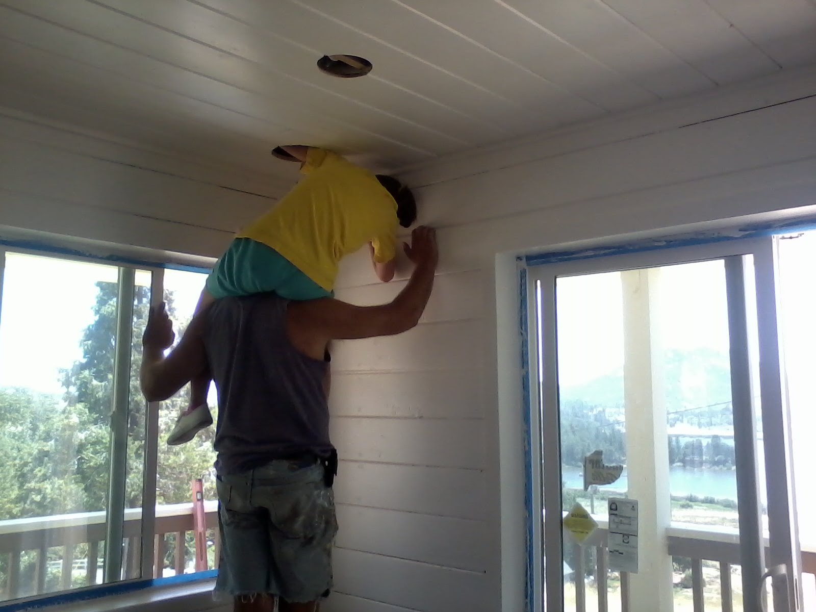

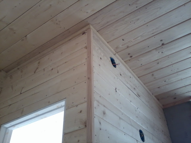

   The flush mount ceiling speakers look great, but one of the wires was on the other side of a joist.  I didn't want to cut a huge hole in it...I drilled a number of different sized holes through cardboard and had my middle daughter put her arm through them until I found the smallest size she could reach through (2 1/2"), drilled that through the joist, put her on my shoulders, and stood on an OSHA approved paint bucket so she could reach through and grab it.

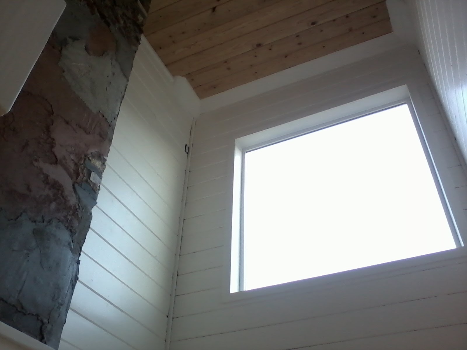

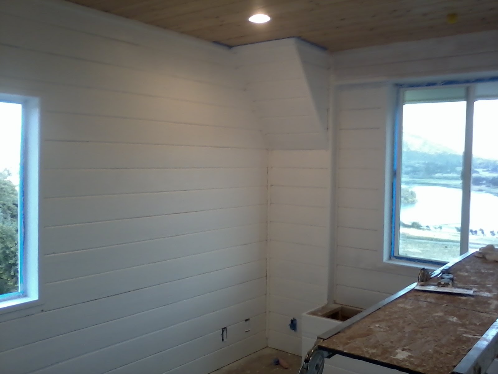

    Our neighbors had strong opinions about leaving the beautiful spruce interior siding a natural finish, but AnnaMarie insisted on white---"This is a cottage, not a cabin"....it required primer and two coats of Behr Plus satin paint, mostly rollered on, then a brush for the joints.  Lesson learned----the Wagner sprayer WILL NOT spray primer.  after 20 seconds it dries on the piston and clogs it all up, even if thinned to water-like consistency.  A little better luck with the paint after adding Flotrol, but still with masking, overspray, and cleanup, it wasn't worth it.
   We varnished the ceiling at least.  It kept the place from feeling like a sterile surgical suite with all the white, and we're throwing the neighbors a bone.

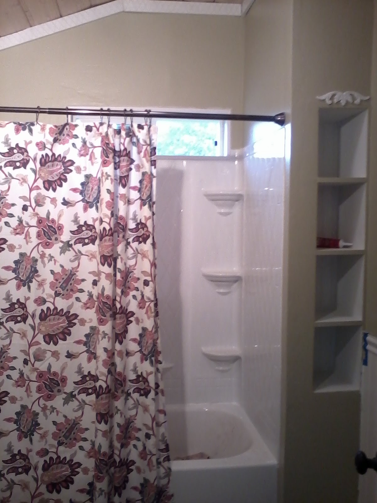

    Here's the bathroom.  My wife chose a tub surround with a diamond pattern, which I matched in the ceiling moulding---just 1x3's with 160 cuts through each 8' board.

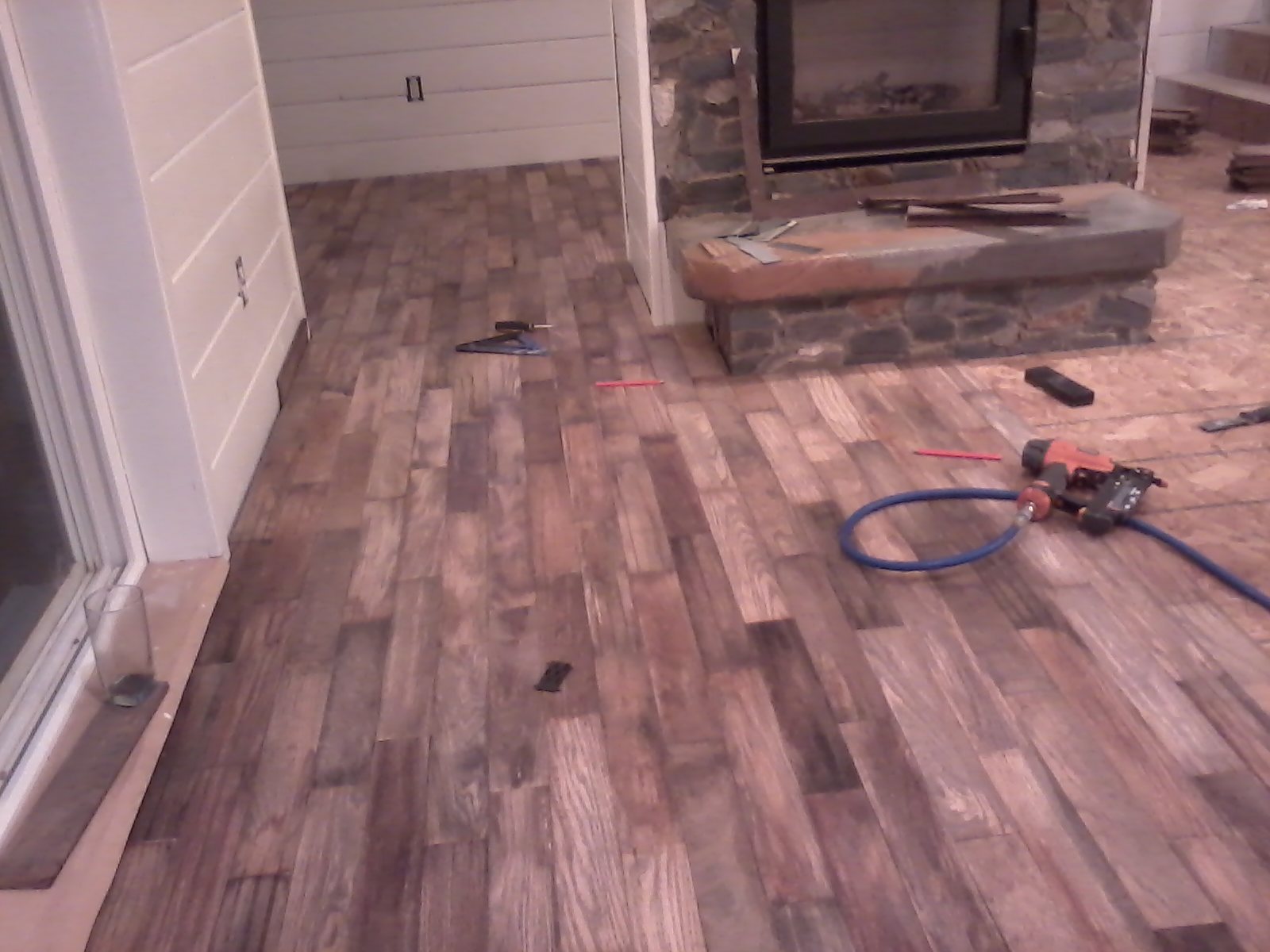

  This is the flooring I bought on Craigslist.  I got 600 square feet for $120.  It's quarter sawn oak that she says she bought 40 years ago in Ohio.  It was stuffed in cardboard USPS boxes and stacked outside.  Most have some sort of rot on one end that looks like the wood got burned, and a few are too warped to use and will become kindling.  So the ends get trimmed, and they get glued and face nailed down.  It isn't going quickly but it's exactly the look we wanted.   I just wish we had enough to do the upstairs too
You just keep outdoing yourselves!  The flooring looks great as does everything else  :)
