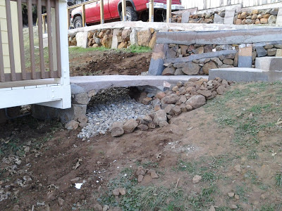

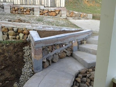

  Finally got a chance to finish the 'potager'.  A potager, I was informed, is a small kitchen garden usually dominated by cooking herbs.  I had to finish the retainer anyway.   Also the bridge to the porch didn't look very bridge-like becaue the soil was only a few inches below it.  That was convenient for when I was forming it but now was the time to dig it out----it's rich soil.  I just shoveled it out and set the rocks aside.
   My 90 year old neighbor, an avid gardener, wandered over and told me to first level the base soil.  It followed the natural slope and would have channeled water away from where it was needed.  So dug that flat.  Also by his advice, I added 3 cu ft of garden mulch and 3 cu ft steer manure.  Then as I added the native soil from under the bridge I just kept stirring it in.  The amended soil goes all the way down to the level of the walkway.
   So now the bridge is higher off the ground.  I have a bunch of this 3" gravel so I'm making a 'stream' under the bridge.  It'll continue down the hill where the porch dripline is.  I ran out of daylight so had to quit, but it was a pleasant work day with a variety of neighbors stopping by all day.  Some hadn't had a tour of the finished cottage.
   AnnaMarie was very pleased with the end result and can't wait to plant.

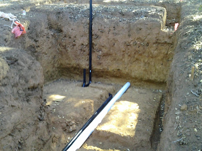

   So here's the start.....I'm digging a 9x8 hole
and dug an upward slope into the hillside.  The idea here is to have the laundry room below and  extra storage room (12x14 with a loft) built above it.  I'm limited to 12' height, so the roofline will follow the slope, and the lanudry room will be dug in deep enough to have headroom

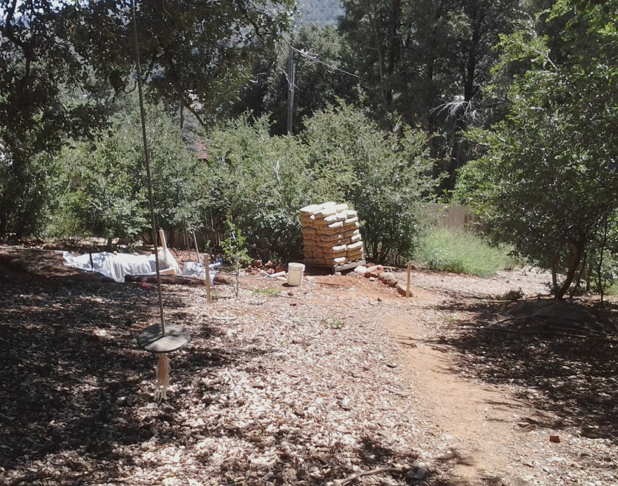

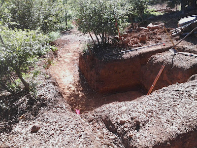

Here's a little update for the outbuilding project at the cabin---
    It's basically a 12x12 shed.  Outbuildings are restricted to 12' height limit and I wanted the laundry room below grade to avoid pipe freezing issues.  The entrance slopes away snd with it a french drain that will go under the slab.  There will be two entrances---one up above for the main shed (with loft) and one for laundry below.  This will eliminate interior stairs which just take up space.  The slope is 4:1 so I'm taking advantage.
     Once you get down about 54", the soil turns from clay to DG.  It's great stuff to build from, very stable.   There IS a layer of expansive soil but it's only about 8" of the layering and isn't an issue.
All hand dug.  Still have fottings to dig for the upper part then time for forms

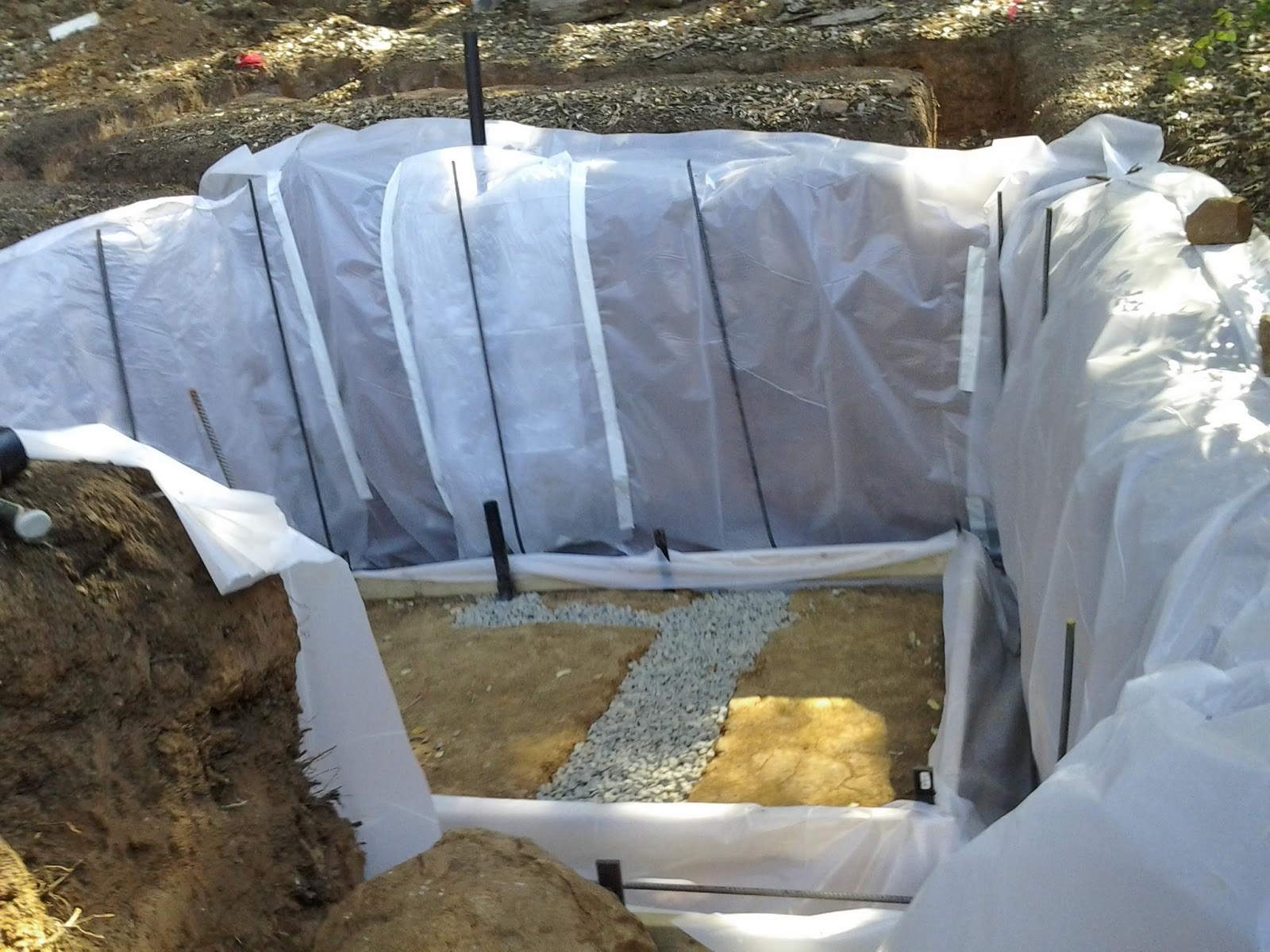

  It's been awhile----mostly because it's been a busy fire season and everyone wants a helicopter.  Also quite a few other things that got backburnered while finishing AnnaMarie's cottage needed attention.

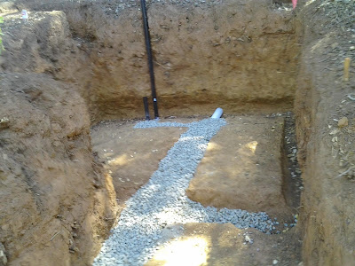

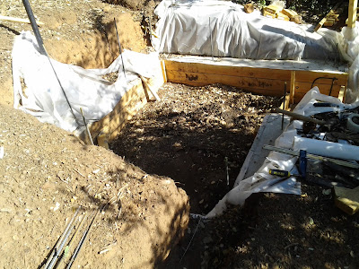

  With the digging mostly done (except for some trenches for the grey water system, which will be infiltrators) it's time to start mixing and pouring.  I'm going to build slip forms for the underground walls.
   I really want to do all I can do to keep moisture out so there's a french drain down the middle with gravel trenches cut to it.  Water shouldn't even get close to the slab...They sell this sock cover thing to put over the perforated pipe that's supposed to keep soil out; sounds like cheap insurance.  I ran the drain ABS through the same trench.

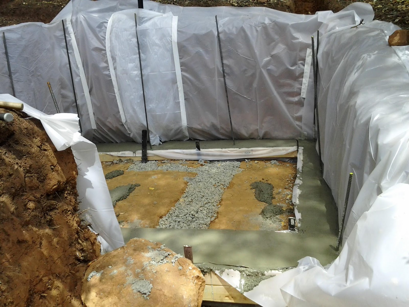

   Next all the trenches got filled up with gravel.  THe main trench under the floor runs downslope to natural daylight.
  Now for the footing, which is the first pour.  It's dug out as an undercut, which my soil held just fine but it's one rainstorm away from filling itself in.  The form is simply a rectangle out of 2x4's temporarily held square by a diagonal support.  It was harder than I thought it would be to get it in the correct position so it lined up with the trenches for the rest of the outbuilding that will be above all this.  Then staked it all level (a trick to getting it perfect---start with a stake in each corner and screw it in 1/4" higher than needed, then tap the stakes in to get the form exactly level) then add more stakes to the middles.  Then line the whole thing with visqueen, both as a vapor barrier and to keep from pouring concrete directly onto soil (which will absorb too much of the water from the concrete).  All the seams of the visqueen were taped with chemtape and the pipe was wrapped where it went through concrete so it can move a little.
   There are two courses of rebar through the footing, with rebar bent into 'L's that are wired to keep the two courses where they belong on the bottom then going vertical for the walls later.

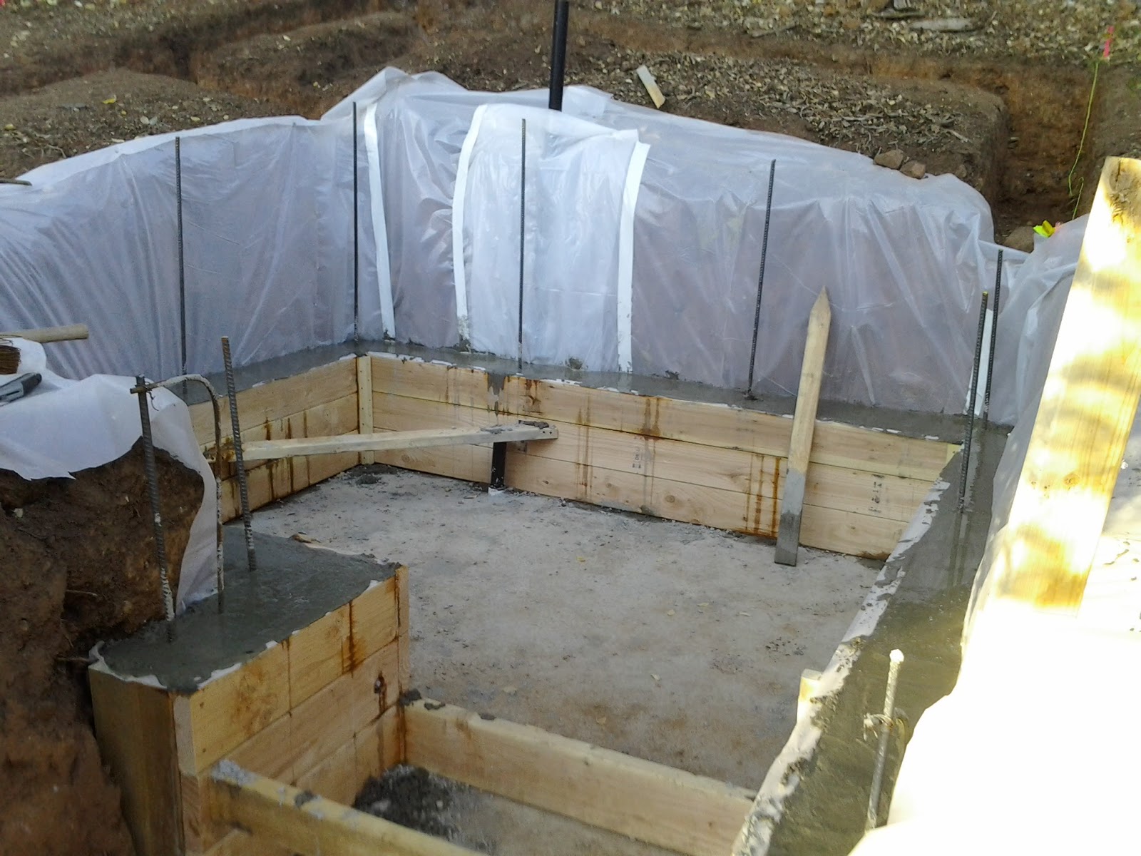

    I really didn't worry about a perfect finish on top of the footing, except where the door will be since the rest of it will get walls poured over them anyway.
  It'll have a few days to cure before I can get back there.  I slopped a little extra concrete onto the floor--it'll support the rewire grate.  Thursday I will pull out the form and pour the floor, using the edges of the footing to screed the concrete flat.  After that sets it'll be time for the slip forms for the walls.
   For the slipforms and floor I'll be able to dump the concrete in with 5 gallon buckets but for this footing it took a shovel,  With the trench undercut like that I couldn't get the right angle to dump a bucket.

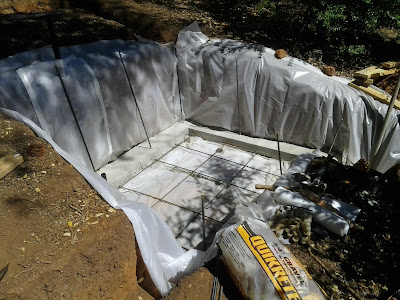

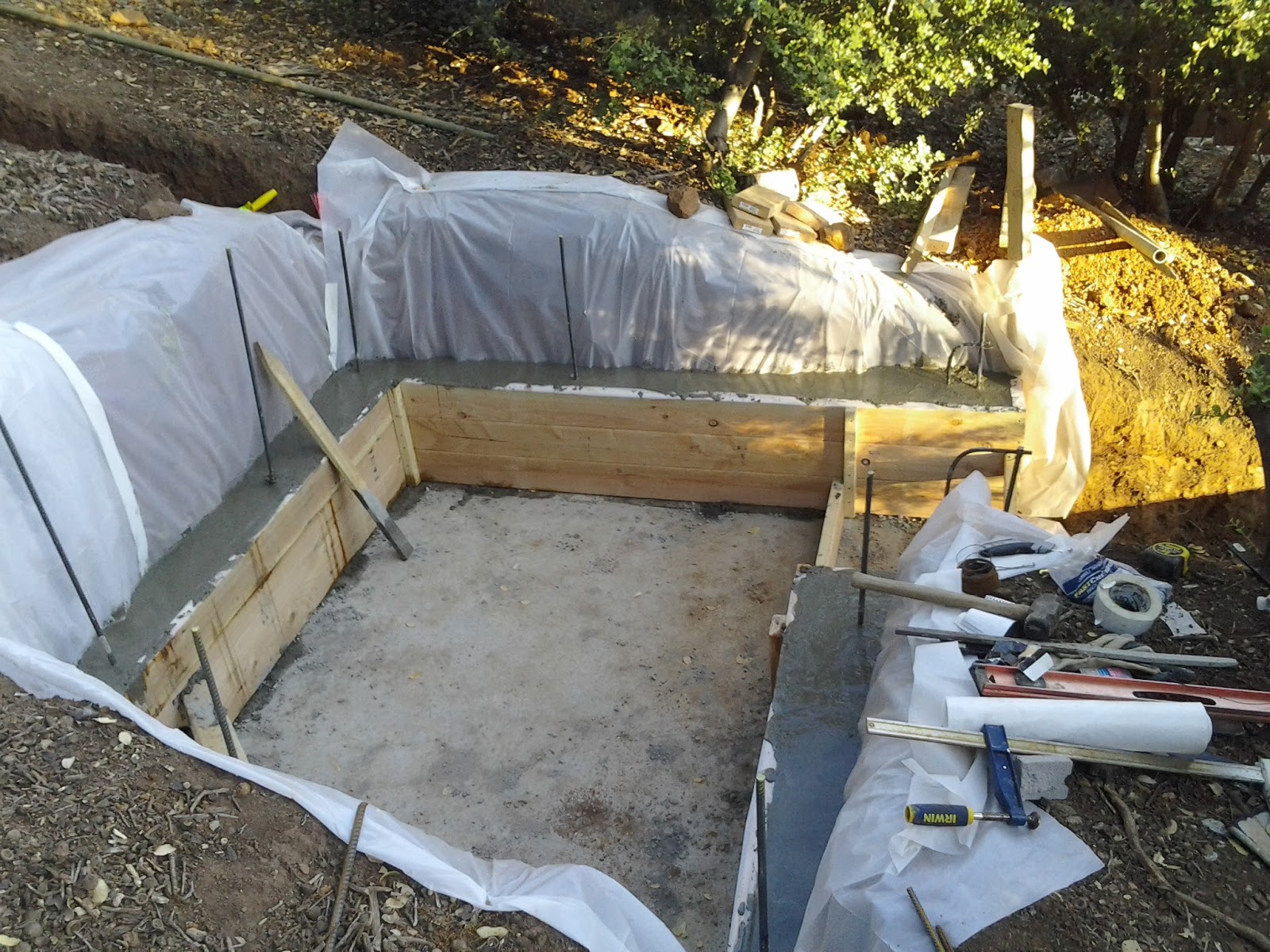

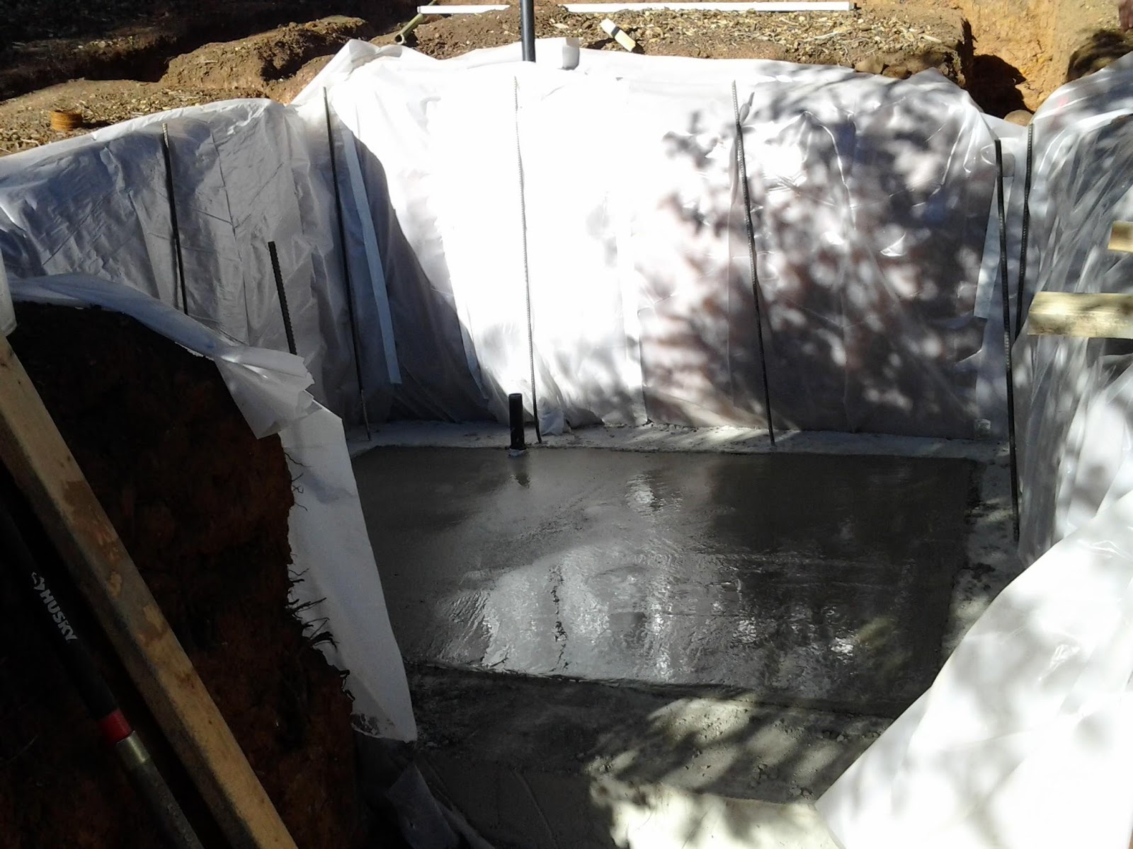

Next step----pouring the floor.
   I stripped the forms and kept one of the 2x4's to screed.  I really hate pouring good concrete on dirt, so there's a vapor barrier down.  I left a gap over the french drain though so I wouldn't trap water under the slab.  This IS a laundry room after all so it WILL flood someday.  The drain ABS has a very high tech wrapping to keep concrete away, an old sock and white duct tape.
   AnnaMarie wandered over to keep me company, and spent her time seeing how high she could stack acorn caps.  Her record was 10.  Her presence always has a profound calming effect and I was very glad she was there.
    All poured.  Since I put in quite a bit of time making sure the footings were exactly level, screeding the floor flat using the footing as the guides was easy, just a bit of a contortion act reaching everywhere to float it.  Next will be the horizontal rebar and the slip forms.

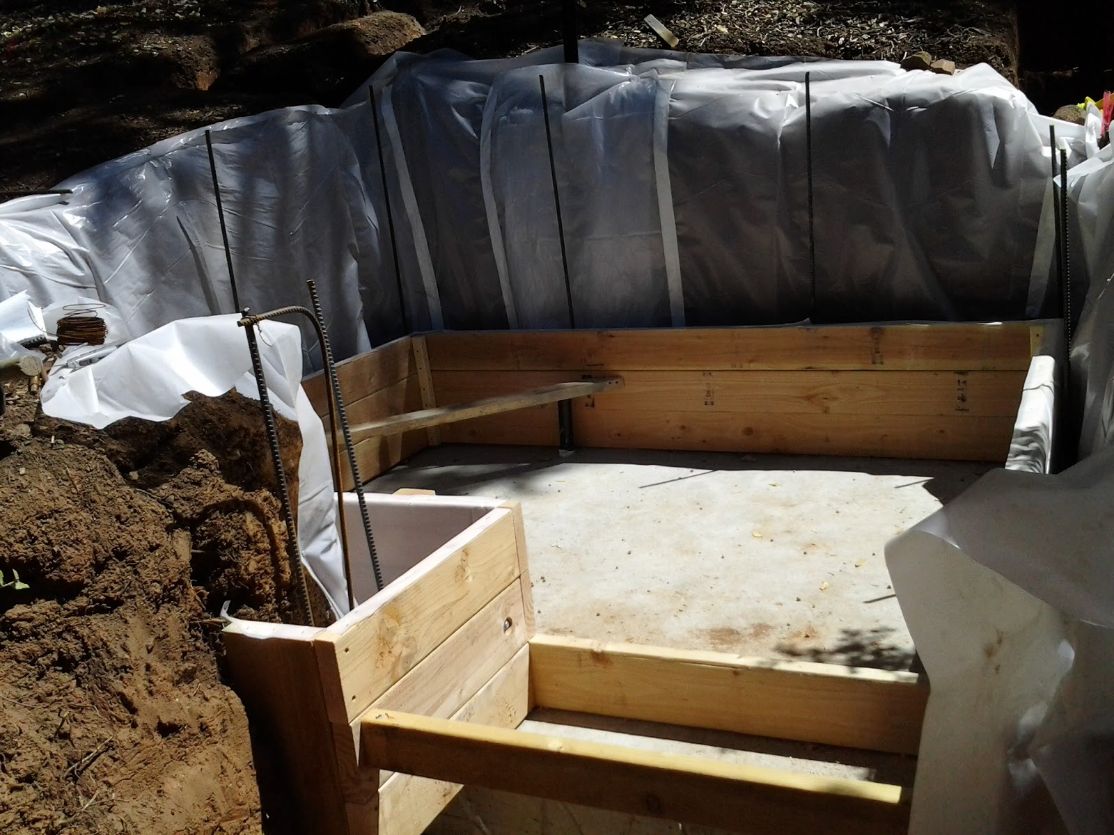

OK on to the next step....Things haven't slowed down at work so they slowed down at this job..
   First step was to get the materials down there.  You can't get a truck anywhere near so everything has to be carried in.  90 pounds is about my limit, and each of these sacks seemed to weigh a pound more than the one prior.  Having the pallet staged next to the drystack wall worked great because I never had to bend all the way over to pick up a sack.  The premix stuff was sweetened a bit with some extra cement thrown in the mixer.

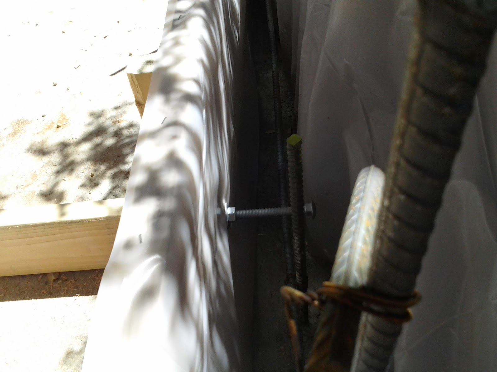

  Here's the slip  form just prior to pouring.  The wood is all plastic lined for a smooth finish.  It also reduces honeycomb voids because the concrete slides down it.  This is right in front of the threshold.  The concrete is continuous well past the door to keep moisture out.  If you look down to the left you can see the stub of a carriage bolt held in the frame---it will give me something to hold the door frame in with.  The door rough-in size is 34" so I have 34" lumber holding the frame to that width.
Here's a better pic of the carriage bolt from the other side.  It'll be well embedded in the concrete and I'll place one every 24" as I go up.
Then, the pour.  I planned to use 5 gallon buckets to pour concrete in the form but the angles were all wrong so I just shoveled it in from the wheelbarrow and tamped and vibrated the forms as I went.  I know it looks like a really wet mix.  I think with the plastic forms there's nowhere for moisture to go but up.
What I didn't get a picture of is, just in front of the threshold.  I wanted really strong support for the left and right walls on either side of the door so I trenched and formed an extension to the existing threshold, with lots of rebar.  So, the concrete goes, in one continuous pour, around the perimeter, then down along the ground joining the left and right like a thick 'U'. That should keep either side from buckling in over time and making the door stick.
  Next week I'll slip the form up 16" and do it again.  THAT will be hard--only because I'll have to lift the shovel a bit higher every scoop.  The third pour will be a more complicated form---I'll be past the point where the existing soil excavation makes the back of the form so I'll form the outside as well, but the pouring will be easier since I can do it from above and just dump the wheelbarrow.

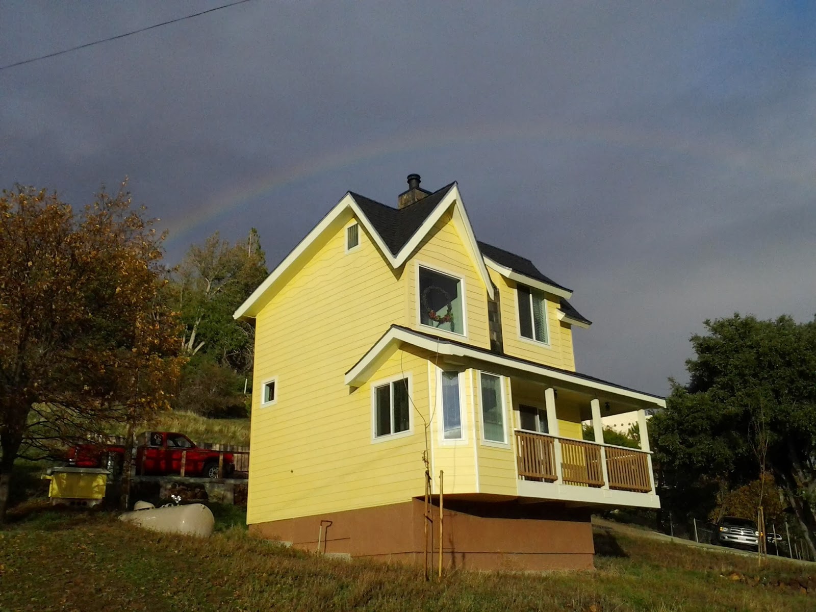

flyingvan
    AnnaMarie and I were just starting the Christmas decorating when this rainbow appeared over the house....I'll have to get some decorated pictures posted, maybe after the first snowfall
   You can see the generator housing in the background there.....Really, it's all plumb---the cheap camera fishbowls things a bit
