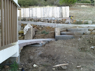

   The final project necessary for completion before the final inspection is the bridge to the porch.  I'd thought about where it would start, where it would end, and how it would be shaped for many months.  Lately I'd been waffling about how complex to make it----I could do a 'just get it done' design of a couple steps down to dirt in a few hours.  I talked myself out of that though.

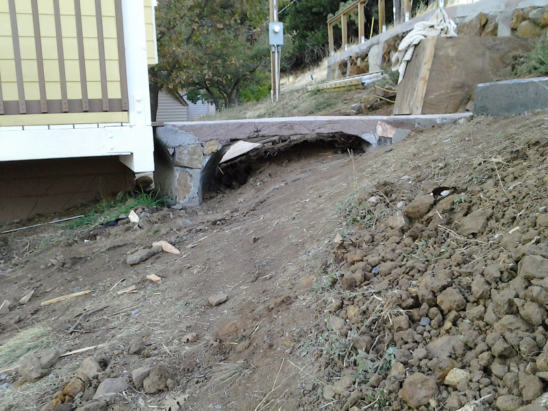

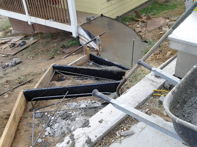

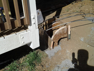

   Here's the difficulty---I wanted the bridge to curve, going uphill, on an off-camber slope.  So I started by digging two footings down to the hardpan, at angles to each other.  I poured concrete in those with lots of rebar and bent rebar from one to the other so the finished bridge would be well anchored.  then I figured out the midpoint between the two and put a 40" board on the ground there, and dug it in and wedged it until it was level.  Then my forms were built from each footing to that board.  The 'joists' were in first, then the form boards on top were just set on them (with angles ripped so they'd fit tight like a barrel) Then I scribed a line on those that followed the curve I wanted, cut them and screwed them down---with screws just long enough so they wouldn't move.  I knew I'd have to demolish my forms from underneath so shorter screws made sense.
I'm kind of wishing I took more pictures of forming the bridge now.  Anyway I matched the arch to curve towards the porch.  The trick there was forming it so it didn't push against the porch beam, making removal of the form impossible.  I screwed it down from the top with a 2x6 that also served to form a pocket for the first deck board to rest its edge in.  Bending the plywood and screwing it into the bridge form was hard.  Then large stones got mortared against the forms.  I decided not to use stones on the edge of the bridge itself---I wanted it pretty thin and thought the stones would weaken it too much, so I just colored it instead.  Worse thing was, it started raining while I was mixing.

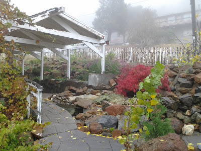

This picture made its way in here for a couple reasons.  It's the first curved bridge I did, over our fishponds.  Also you can see what the weather was like.  Also to prove SoCal can get fall colors.  Also you can see the neglect our pavilion and fence have faced since I've been building.  (The cottage project is across the street, behind this pavilion.  You'd see the roof but for the fog)

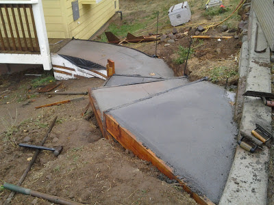

The rain didn't ruin anything---it just made the surface rough, not a bad thing for a foot path.  You can see the color mixed in so it'll match the hearth inside.  Although I milked it with AnnaMarie, it was actually great weather to mix concrete in----hot and dry is far worse, lugging 90# sacks of concrete, breathing the dust, and misting the stuff that's already mixed so it doesn't dehydrate too fast.

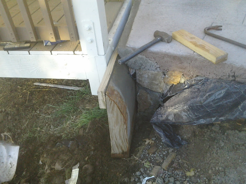

So this is stripping the forms.  This one was pinned to the ground with lag bolts pounded in from under the deck.  Wedges from underneath kept it off the beam, and that 2x6 screwed from the top kept it away too.  You can see how the deck board will drop right in there.  It's a smooth transition from concrete to deck.  After pulling the pins out, it just got pounded out from the other side.  The main bridge form, I just kept whacking the joists to smithereens with the digging bar.  Once one form board came out the rest just fell.  (The whole thing was lined with plastic for a smooth finish and to help with this stage)
The wooden box things are forms for the retaining wall.  It will look just like the ones in the backbround with native stones between the pillars.  This will form a planting area next to the walkway.

  AnnaMarie wants a 'potager' (garden herb planting area.  Had to look it up)  right here.  This is the retaining wall next to the walkway.  Normally I dry stack the stones all the way up even with the top of the pilasters (for lack of a better term) but here I stopped about halfway up following the slope.  I'll make a form with that benderboard then line it with plastic, and drill tiny holes through the form on the steps side, and pull fiber optic strands through the holes all the way up the flight of stairs.  While the mortar's wet I'll carefull set the next course of stone---maybe I'll stick smaller stones in the mortar between the fibers so the big stones won't hurt or dislodge the fibers.
   I wish I had lined my entire form with plastic instead of just the front.  The plastic lined part is wrinly and glossy and awesome,  The long side of that pilaster, which will show from the kitchen, I just poured against plywood so it's rough and chalky.   Fail.
