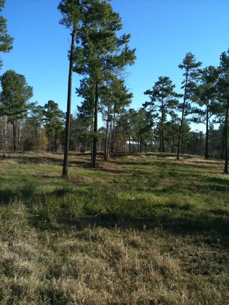

I know how everyone loves pictures so here are some shots of the land.  Sorry for the phone pics but that is all I really do.
thanks
Austin
Up at the top of the hill you can see our explorer.  That is where the main house will later go.  The "garage" will be a little more to the right.
Nice spot in one of the lower pastures.
This is a shot from down the hill looking back up.
The wife climbed on top of the explorer to see what it would look like up on the front porch.  Yes, we already have a power pole there but it isn't hooked up yet.
We really love the property and the kids have a great time.  Can't wait to start building.
