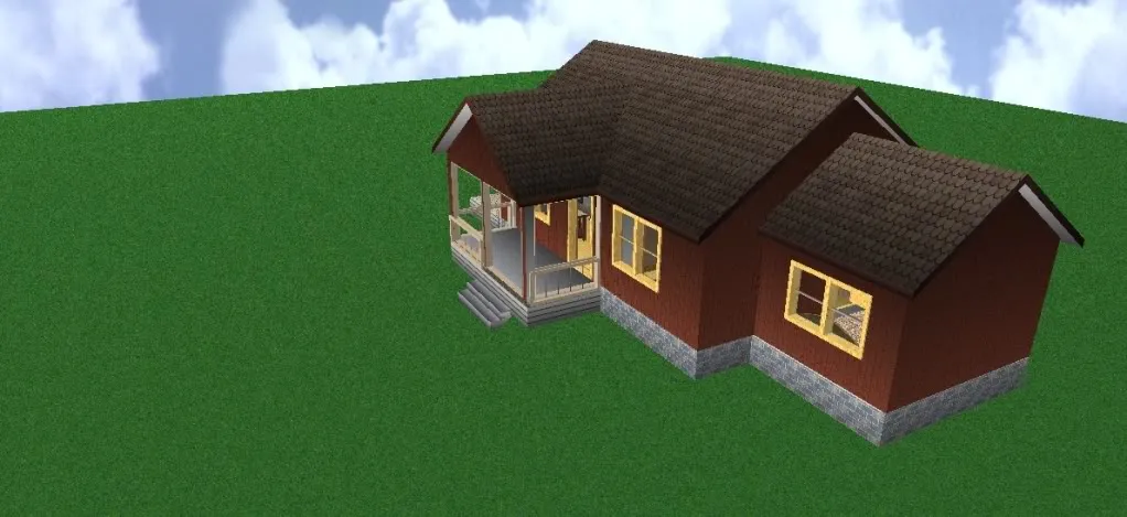

In the spring I intend to add a porch to the front of my cabin.  It will look like this:
My question is what would be the compound cut on the part of the rafter that is attached to the roof line?
I know the top of the rafter wil be just short of 34 degrees but I don't know if there is an each way to figure the compound cut on the bottom.
By the way both the porch and the camp roofs are 8/12 pitch.

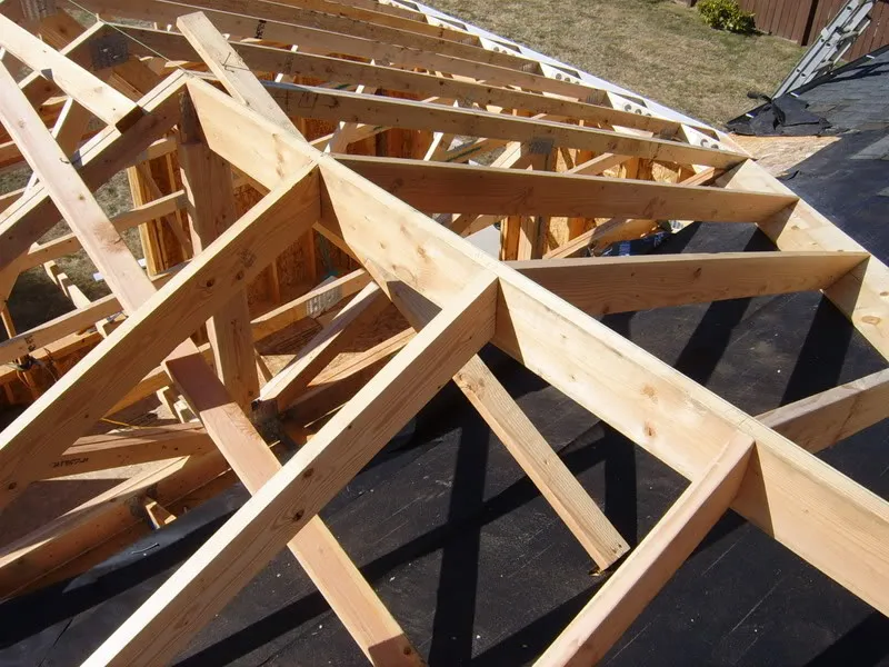

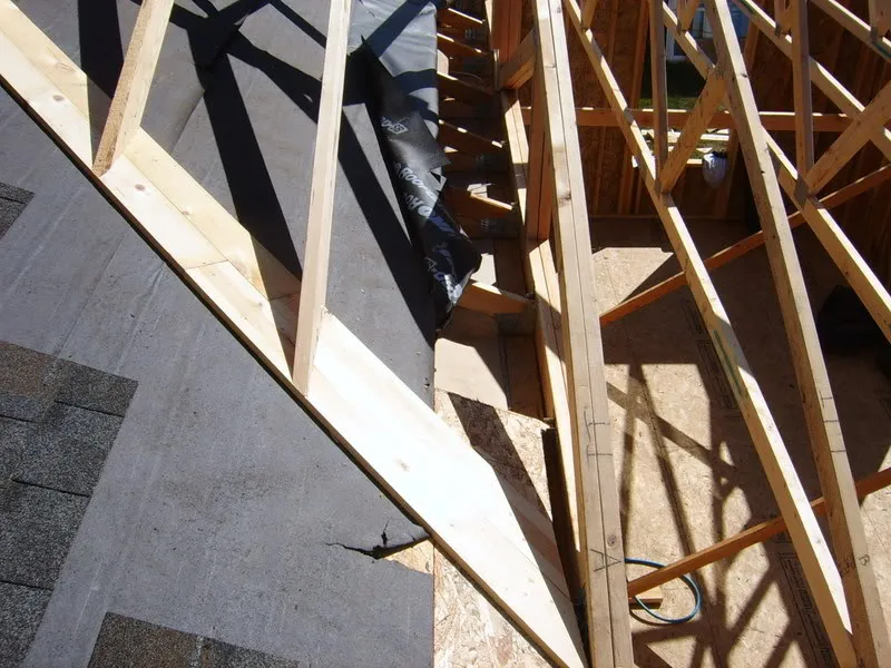

Over frame the gable like this,
new land owner
Thanks for the pictures that is just the way I am going to do my porch roof!
