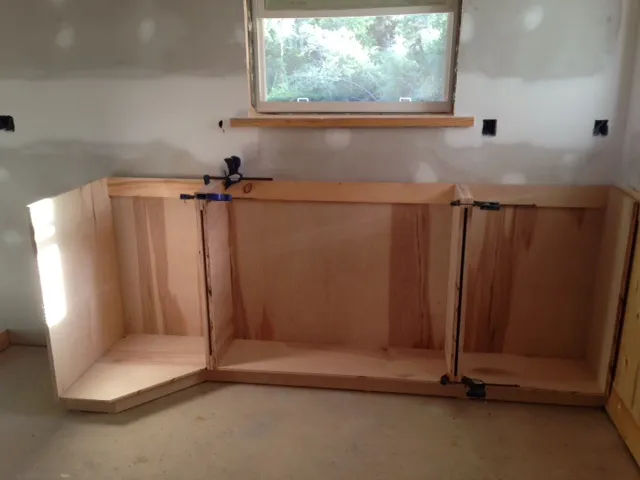

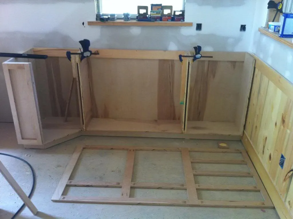

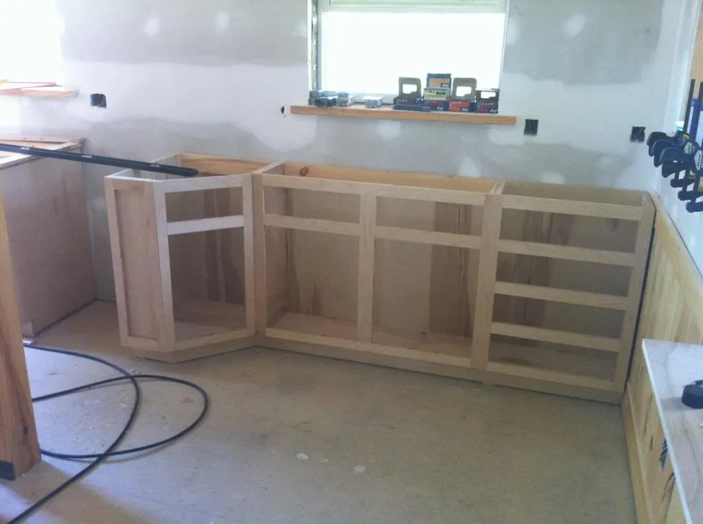

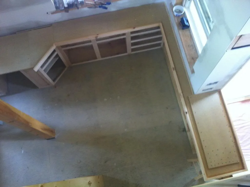

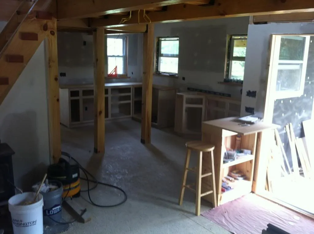

I've built the carcasses for the kitchen cabinets using a Kreg pocket hole joinery device. This thing is really a great building tool. I've never built anything as delicate as cabinets and they are of professional quality.
I started my cabinets by building the base from the wall to the toe kick and shimmed them level. this took a full day but the level platform made things much easier when I was installing my cabinet boxes.
I used 3/4 inch birch plywood for the carcasses.
Kreg pocket hole jig.
putting the face frames together for the cabinets.
I also used 3/4 inch birch plywood for the face frames.

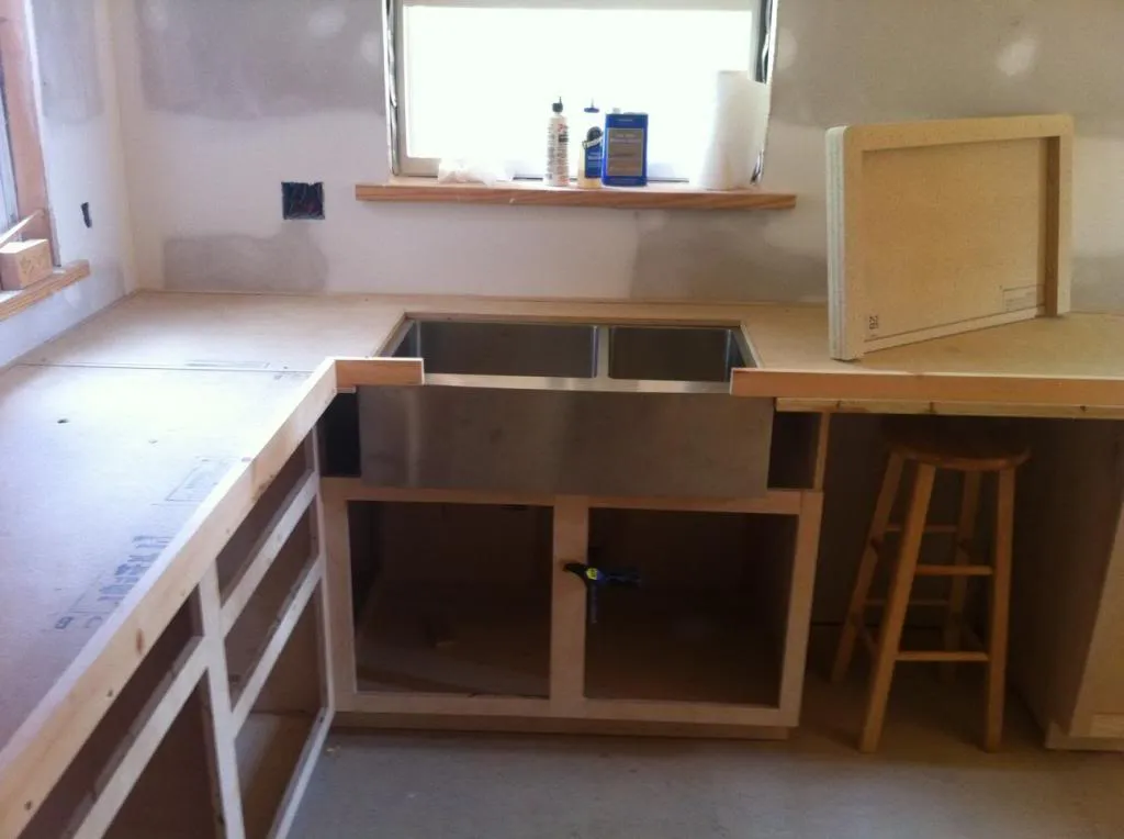

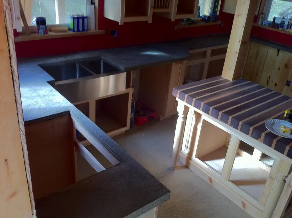

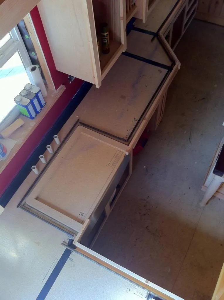

I am planning on pouring concrete for my countertops and have been waiting for my sink and cooktop to come in on special order so I could move forward with building the forms for the pour. The sink is all done and I just received the cook top so the form for that will be built within the next few days.
The countertop forms are built for 2" thick countertops.

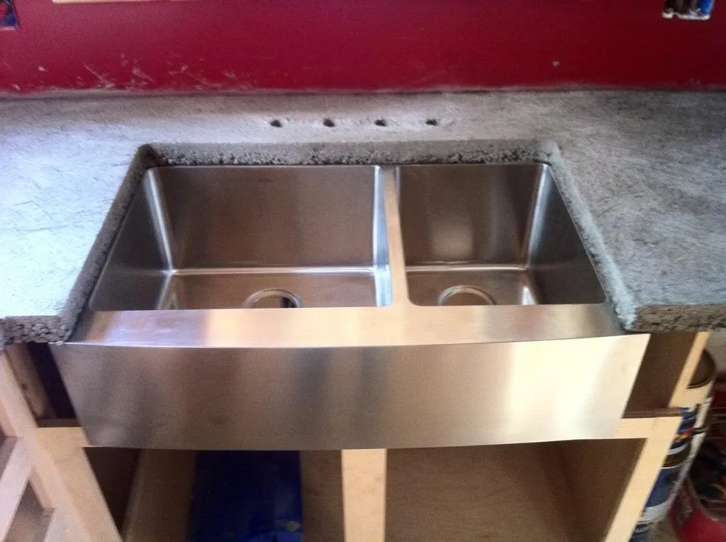

This is the form for the under mount farmhouse (apron) sink.
form installed over sink.
the sink is a 60/40 with a 10" deep basin. Will seem like a swimming pool after RV life!

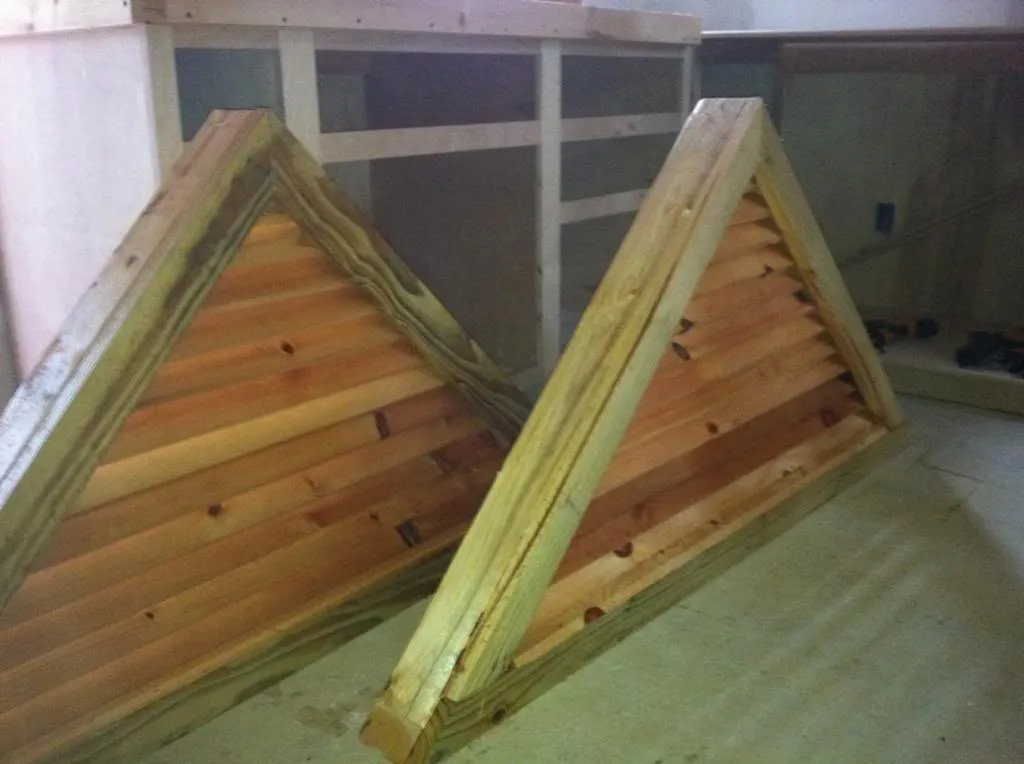

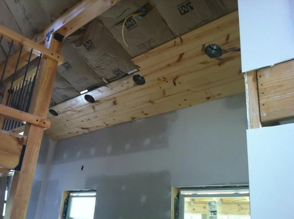

I needed to build the 3 gable attic vents before I could move forward with installing the ceiling. Otherwise I'd have to belly crawl through the attic to install them.

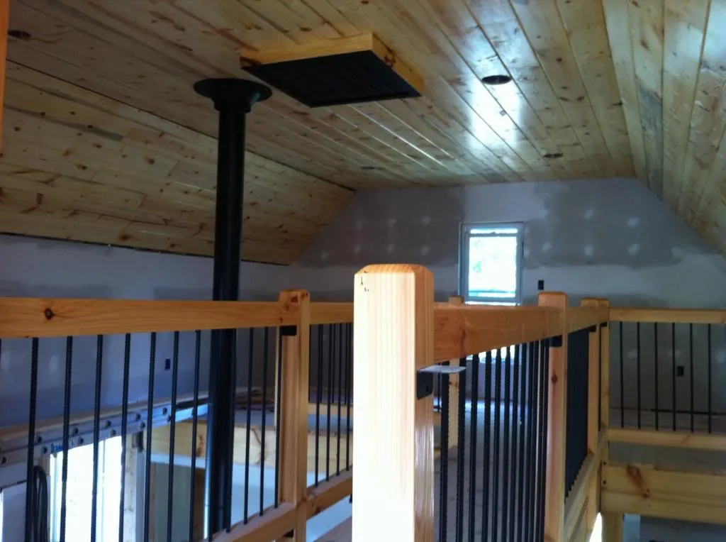

I finished the T&G ceiling. I used 74 1x8x12's and 2 1/2 gallons of semi gloss polyurethane. It's amazing that the house has drank 10 gallons of that stuff already.....will be glad when that process is over!

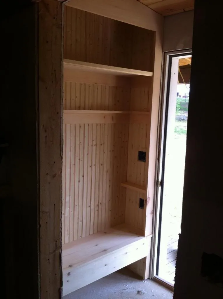

I built a coat rack/bench seat with built in storage for gloves and hats in the laundry room. This was also built using pocket hole joinery.
This is the base to my coat rack. We'll be able to slide shoes underneath and store hats and gloves in the bench seat.

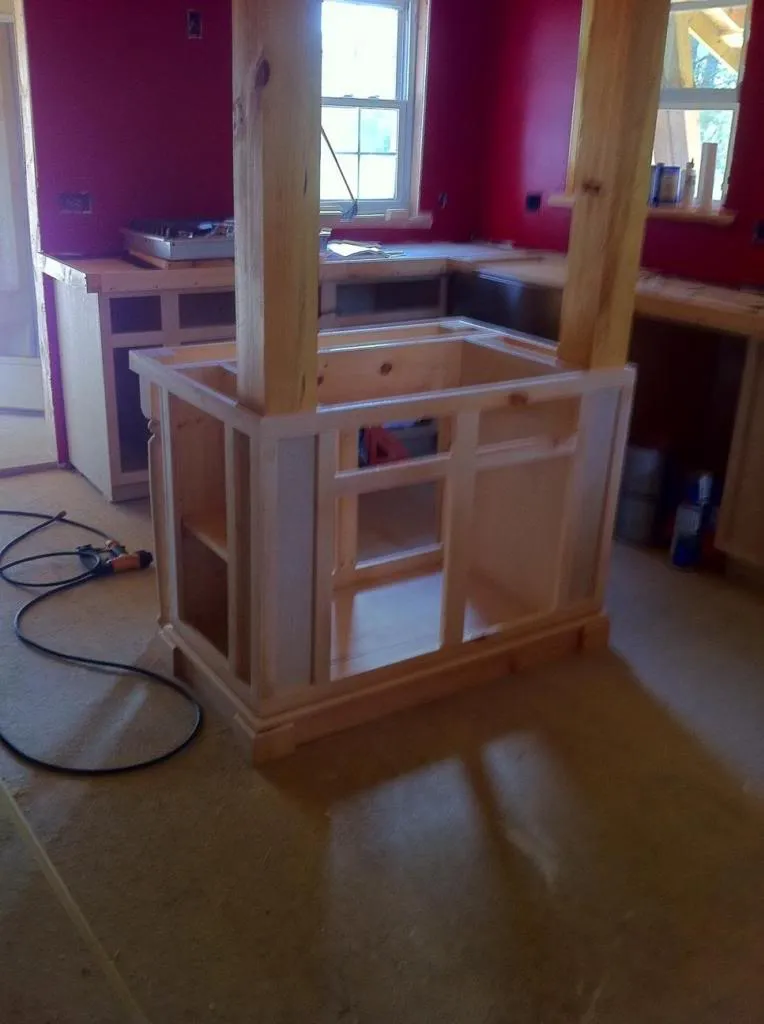

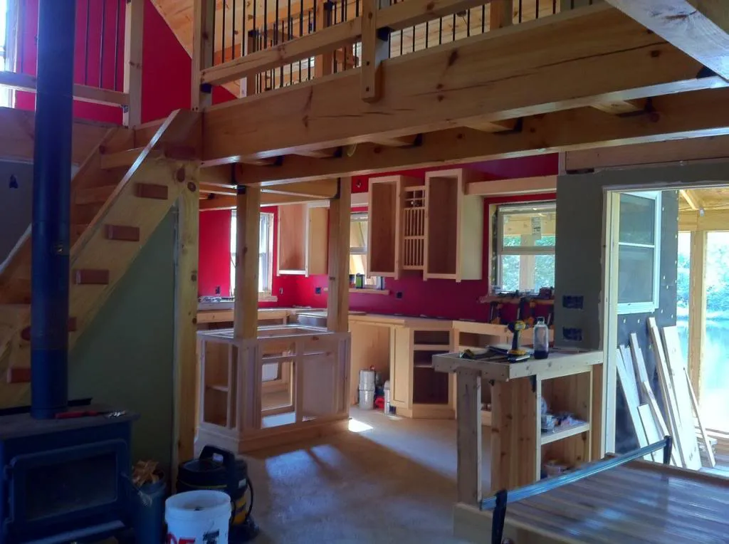

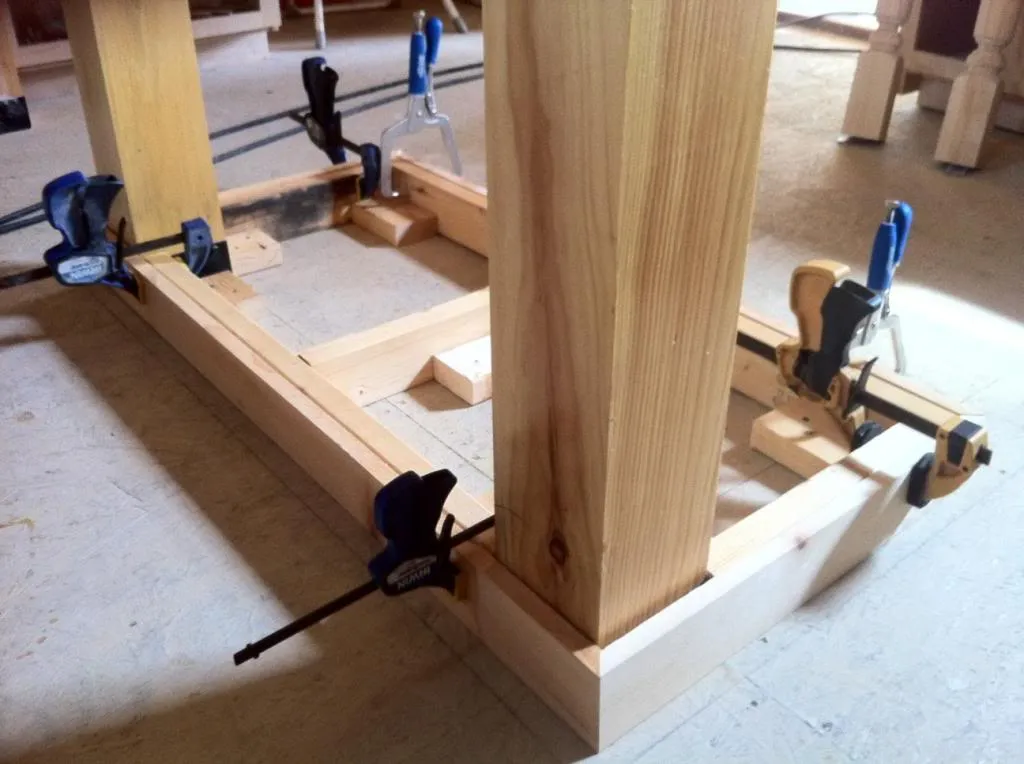

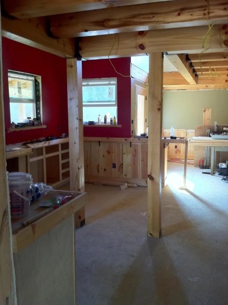

In the past 2 days I've tried to tap into my creative side by giving a shot at building the kitchen island that I've been putting off. I'm glad that I procrastinated and saved this for last because I was able to refine my skills with my tools while building the regular kitchen cabinets and that really made a difference.
Since everyone on here loves visuals so much I've put a step by step pictorial. Here goes:

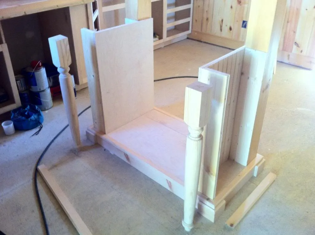

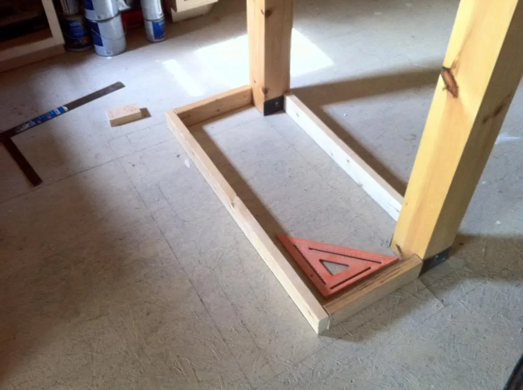

similar to the way I built my kitchen cabinets I started with layout lines on the floor to make sure I was starting square.
I used 2x4 blocking for a solid base and for nailers.
3/4 inch birch plywood for the base and the main uprights. assembled using my pocket hole jig. Love that thing!

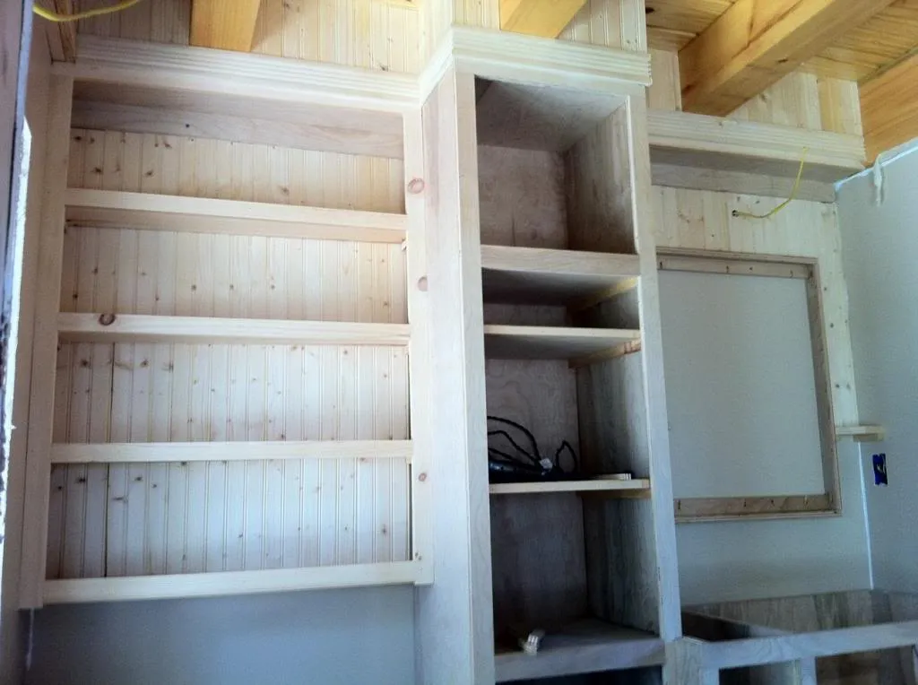

I used 3/8" wainscoating for the 2 sides which will be open shelving. The front spindles are 35 inches tall and are fastened to the floor with a normal 2 1/2" screw with the head cut off so it could be threaded on. The corner blocking is made from 1x4 stock.
face frames cut to fit.
face frames were assembled. The indentations of the structural 6x6 posts were filled with 1/4" birch plywood. The shelving was installed into the 2 side shelves.
The last thing I did was make some trim to dress things up.
OK, so my wife asked me what the point of the spindles are and I said "uuuuum they look good" after she mentioned it I thought, they really serve no structural purpose other than decoration. I told her that they were screwed and glued into place but that isn't something that a power saw wouldn't fix. We are playing the spindles by ear for now though.

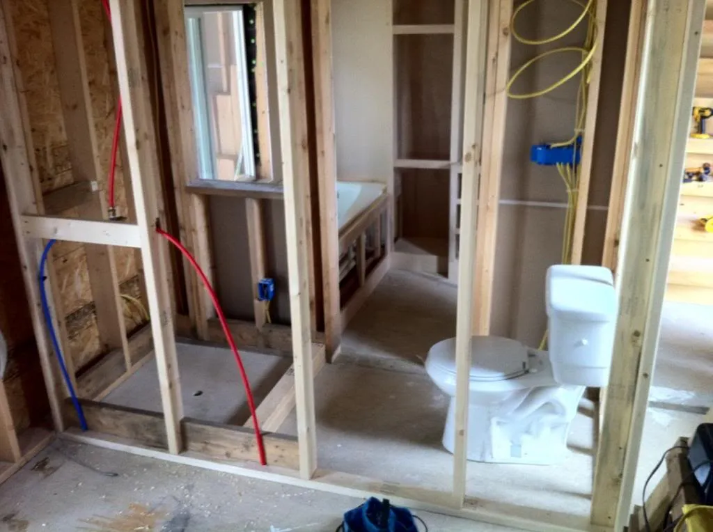

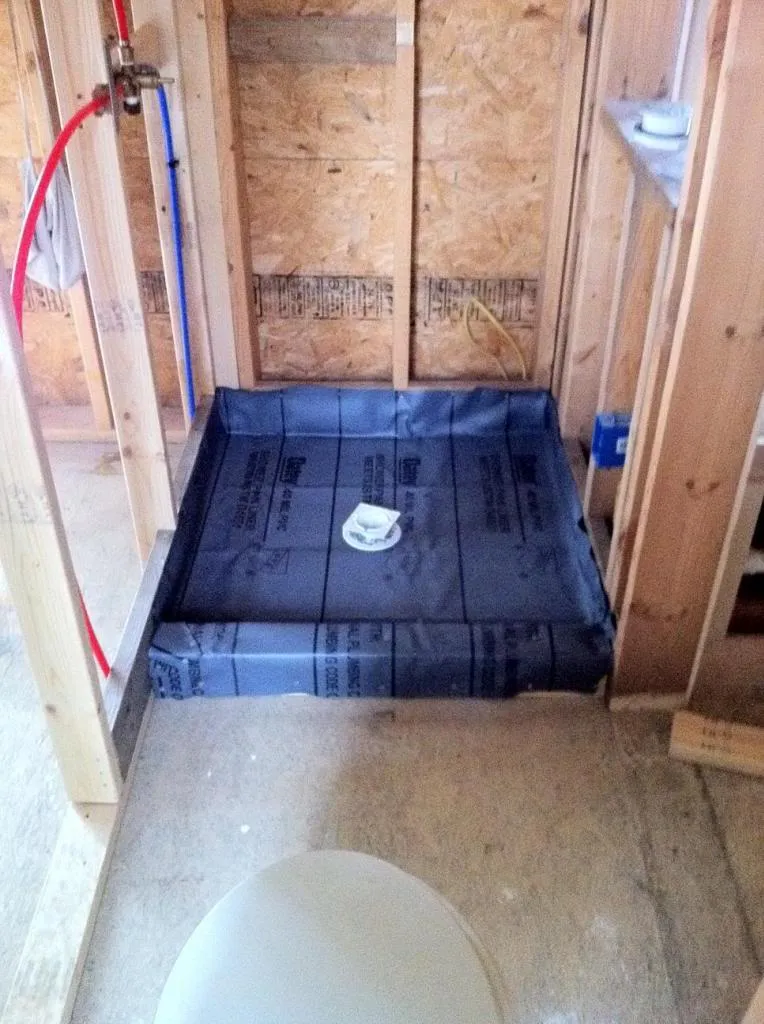

In the past week I've been working on the bathroom and have made some significant progress in a fairly short time. I built the Jetted tub base and tested the jets out to make sure they worked before I framed the surround (tub was bought used for $125). Then I built the sink base and linen closet carcasses before framing the shower and toilet wall, pouring the 2 layers of the shower pan and starting the shower surround. I also finished my butcher block on the kitchen island and built a medicine cabinet and some decorative shelving in the bathroom.
Tub base framed with 2x4's and shimmed level. Tub surround face frames built using 3/4" plywood will house 3 access panels for tub plumbing.
Sink base and linen closet carcasses.
Shower and toilet wall framed. This took up 36 inches from the bedroom addition.
30lb felt paper on the sub-floor and wire mesh on top. 2x6 blocking along the floor will give a solid backing to pour the mortar.
The first of 2 layers of sand mix (mortar) graded at 1/4" per foot.

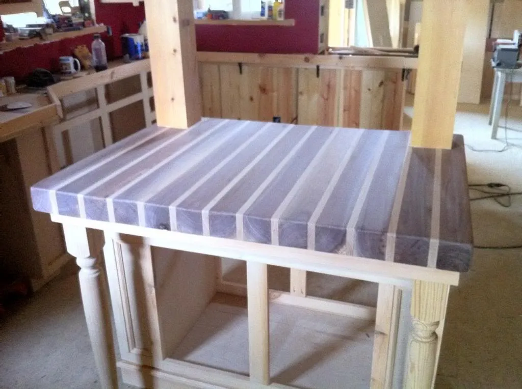

While waiting for the first layer of mortar to set I finished gluing my butcher block.
Then I sanded it smooth and rounded the corners using my orbital sander with first 60 grit then 80, 120 and finally 240.
And finished it using linseed oil. It turned out to be a little darker than I imagined it would but looks good.

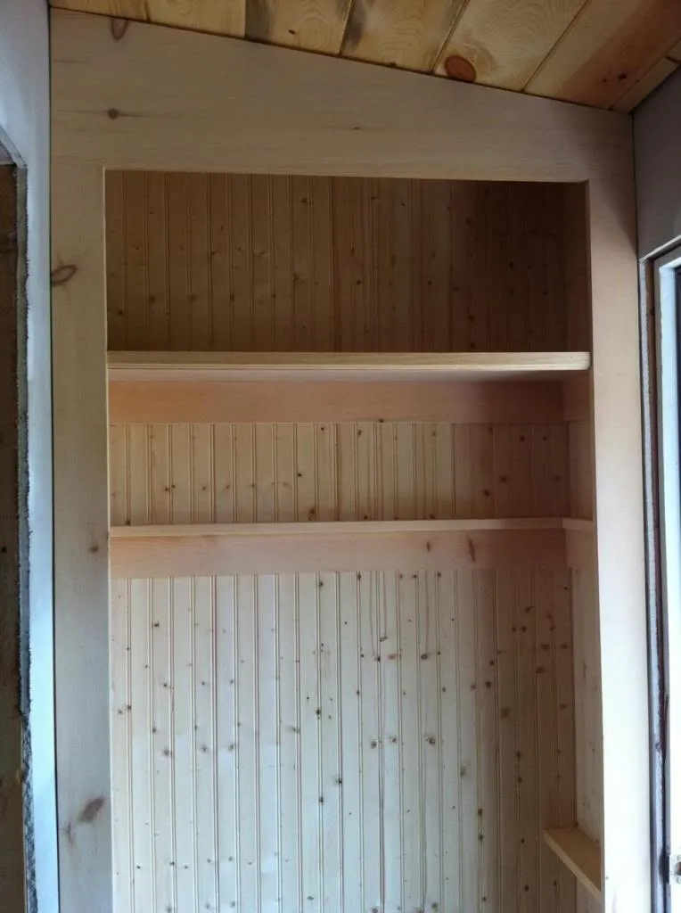

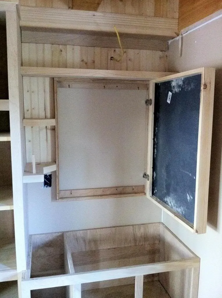

Shelving above the foot of the tub and the back of the medicine cabinet to the right.
Finished medicine cabinet.
Later i'll build 3 1/4" shelves inside.

Mike870, The picture of the tie down straps that I used to clamp the butcher block is kind of deceiving. I didn't use the strap to clamp the entire thing. I first glued and clamped the center portion that would be between the 2 6x6 posts using regular wood working clamps. Then after setting that portion between the 2 posts (after the glue dried overnight) I was able to determine if i'd need to notch out the outside material to fit around my posts. Luckily it fit almost perfect and I had to notch out very little of the outer stock. The pic of the straps shows how I had to clamp just the portion that fit around my posts. A little bit of redneck engineering but turned out to work really well.

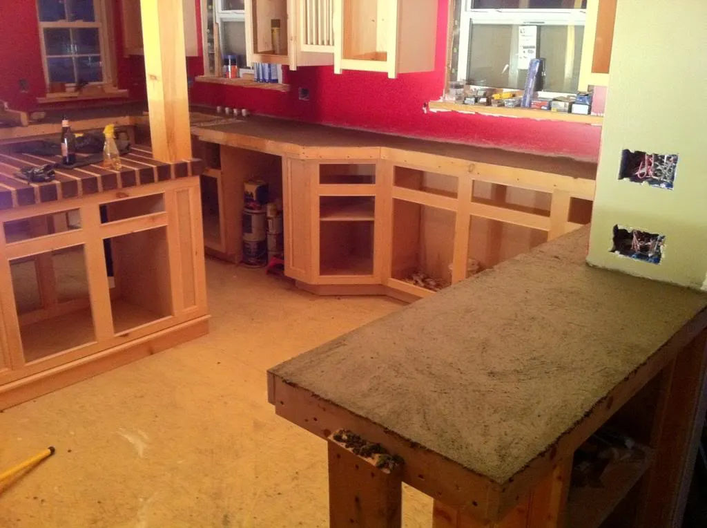

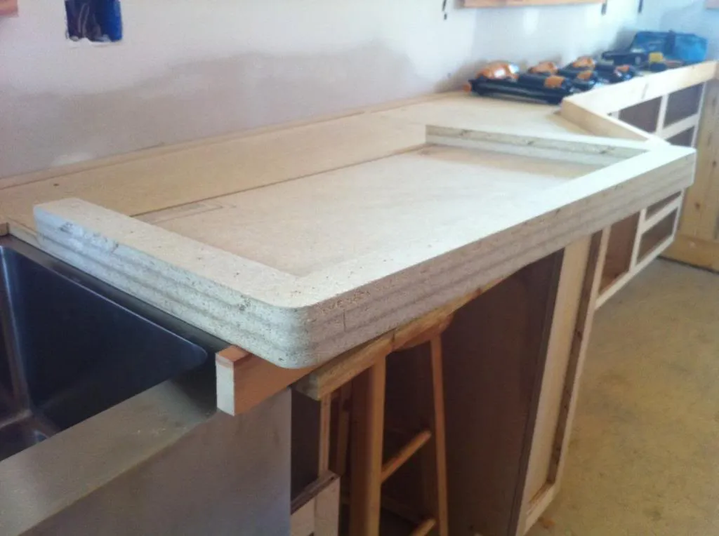

I'm finally through with my concrete counters except for the polishing and it's definitely been an ordeal. We used a 5000 PSI concrete made specifically for countertops by Sakrete. I mixed it on the dry side because too wet a mixture weakens the cured concrete. If I were to do it again though I would have added a bit more water so it was a little easier to work with. I used rebar along all edges of the countertops and all cutouts. I used a sawzall with the blade removed to vibrate under the counters and along all the edges and it really did a good job filling the voids.
Empty countertop forms with rebar reinforcing the edges and pvc siliconed in place for the plumbing fixtures.
I was the mixer.
while the wife helped with the finishing.
and after a long day the kitchen was done.

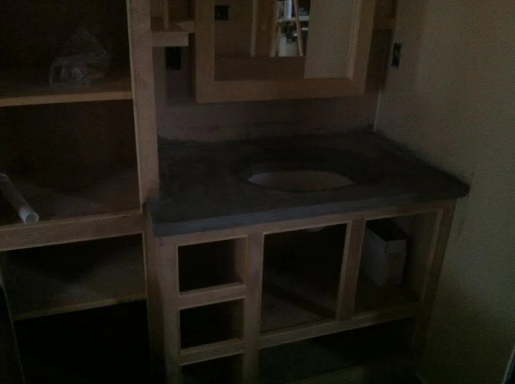

the next day I poured the bathroom concrete.
I waited 2 days to remove the forms and was pleased with the results. The edges had some rough pitting but read that it was fairly normal and also read to remedy this you can mix a "slurry" of 2 parts Portland cement and one part sand bedding mix to a fairly soupy mixture to fill in the rough spots.

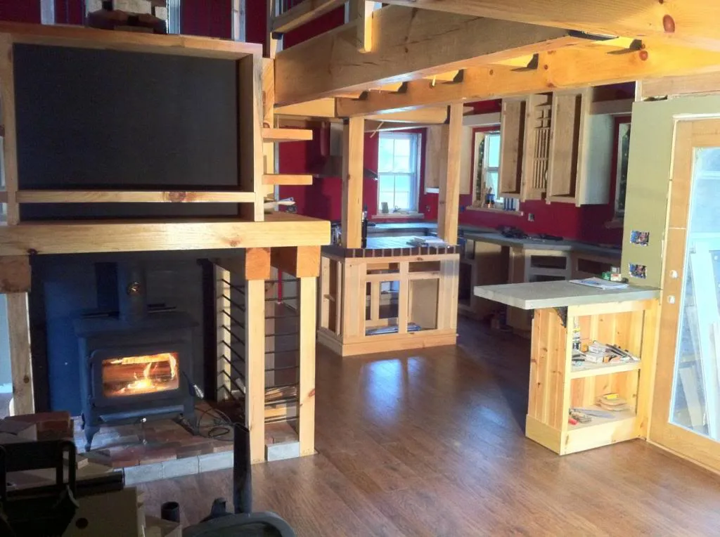

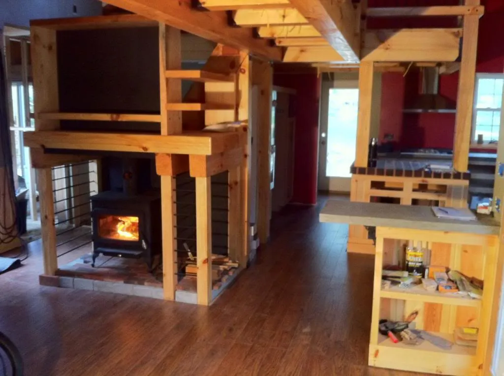

For the hearth I used 4 inch block and paver bricks as a base. The upright posts are 4x4 with 6x8 cross members supporting 6x12s used as a wide mantle.
I used rebar painted black to dress up and shield the surround and used a piece of 1/2 inch hardie backer painted with high temp black paint to shield the stairs and wall.
Here's the finished product. More 1/2 inch hardie backer in back of the TV surround and above the stove.
The right side of the enclosure will be used to hold wood.
In back of the TV enclosure I've used brick around the stove pipe to act as a heat sink and a partial heat shield and also is a decorative addition. It's dry stacked for now but will soon be mortared into place.

southbalto
OK...I'll be the one to ask.  What are the minimum clearances on that stove??  I'm shocked if the manufacturer/UL approves such a small distance to the top of that alcove.  And the connector pipe?  Is it doublewall or single?
NavyDave
The minimum Alcove height (if combustible) is 54 inches. This alcove is 24 inches above the stove with 1/2 inch cement board (not combustible) and a 1 1/2 inch airspace between it and the combustible mantle. the stove pipe is a single wall 6 inch pipe with 2 larger 8" stove pipes around it with 1 inch standoffs from the 6" inch pipe and 2" from another layer of cement board which has a 1/2 inch stand off from the combustible mantle material.
You are correct that this application isn't per the manufacturer but given the first trial of 3 hours sustained burn time and the second of 5 hours of sustained burn time (this trial I purposely over fired it to 700F) I'm satisfied so far. More trials of higher intensity and longer burn times are coming and if i'm dissatisfied with any of them I'll either put another layer of cement board above the stove with another 1 1/2" stand-off and or replace the single 6" single wall with 8" surrounding pipes and stand offs with a triple wall pipe where it passes through the mantle. So far testing is going well though.
Here's a picture of the alcove shield and stand offs. You can also kind of see the 8" stove pipe meeting the heat shied.

What was the determining factor on the laminate vs hardwood?  Home Depot has some hand scraped solid wood flooring for, I think $4.89 per square foot.  Pretty expensive but not too bad considering some of the other flooring.
I have no idea about your TV/woodburner setup but it looks a little scary.  I would wonder what your insurance agent would say?
grover
The rebar on the sides is a really good idea especially if you have toddlers/kids around.

For the wood stove surround...fire scares me as well but the testing on the heat shielding is proving to be successful. I definitely will not need to add any additional layers of shielding above the stove but have decided to replace the 6" single wall and 8 " shield where it goes through the mantle with a length of triple wall pipe. I've decided to do this not because of any heat build up I've noticed but because I believe the triple wall pipe will offer added protection to the mantle. Like I said, fire scares me too and I'll sleep better at night knowing the triple wall length is in place.
