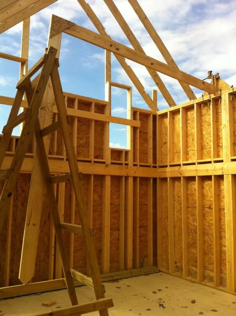

Today I hung 8 of my trusses on the main 16x28 structure. I used a pulley system on the first truss but ended up using my A-frames and manpower on the remaining ones. The L-brackets that I made were life savers. When clamped to the top plate they provided a VERY sturdy place to clamp my trusses to until I got them screwed in place and the hurricane ties installed.

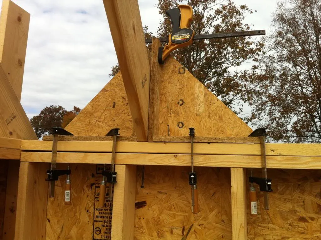

Here's how I used my A-frames and L-brackets to raise the trusses. The L-brackets were clamped tight to the top plate and were clamped to the truss leaving about 1/8th of an inch play. This allowed the truss to slide easily for me while raising the other end by hand. Once the other end was raised a 6 inch Timberlok screw was screwed through the double top plate from the bottom and hurricane ties nailed in place. Then the other end was fastened the same way.
A close up view of the L-bracket supports. Notice the Timberlok screw ready to be screwed up through the bottom of the double top plate.

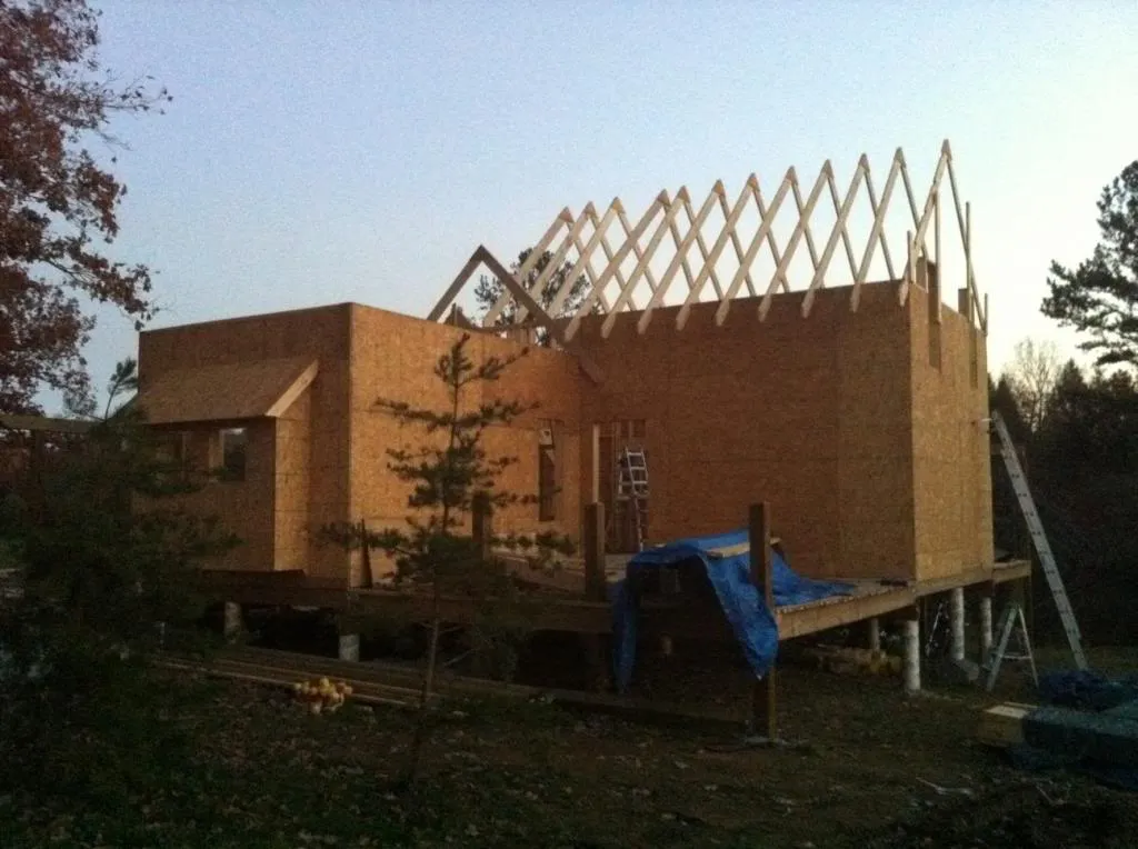

You can kinda see the hurricane ties in this pic. Pretty sky too!
Almost looks like a house now!

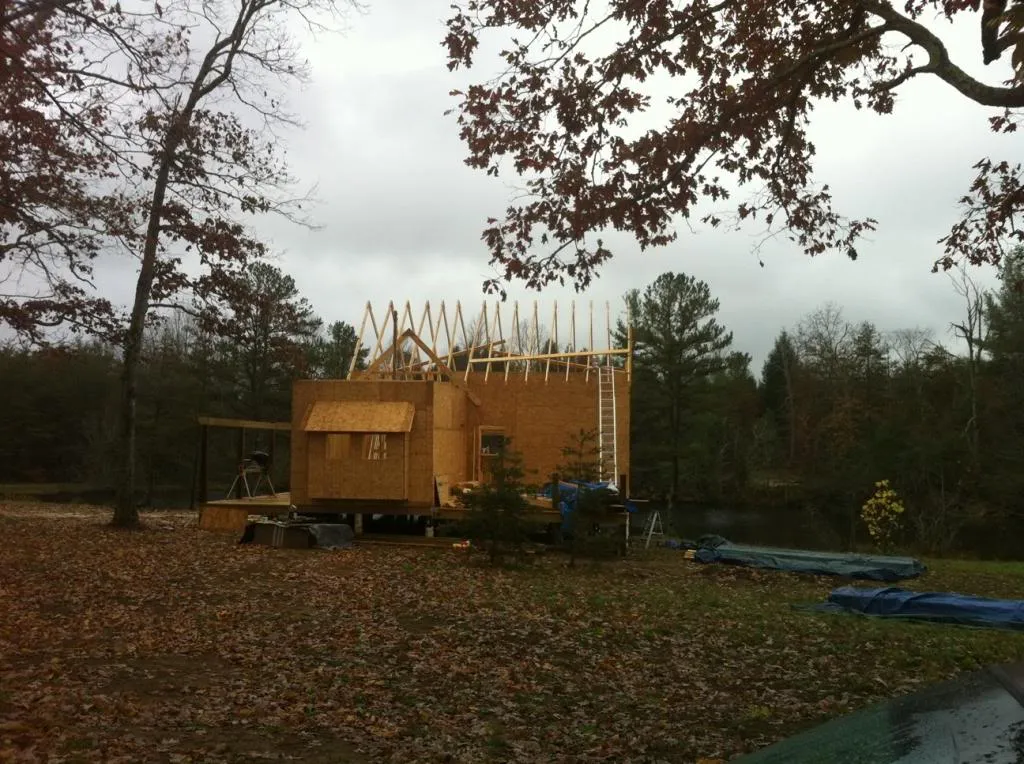

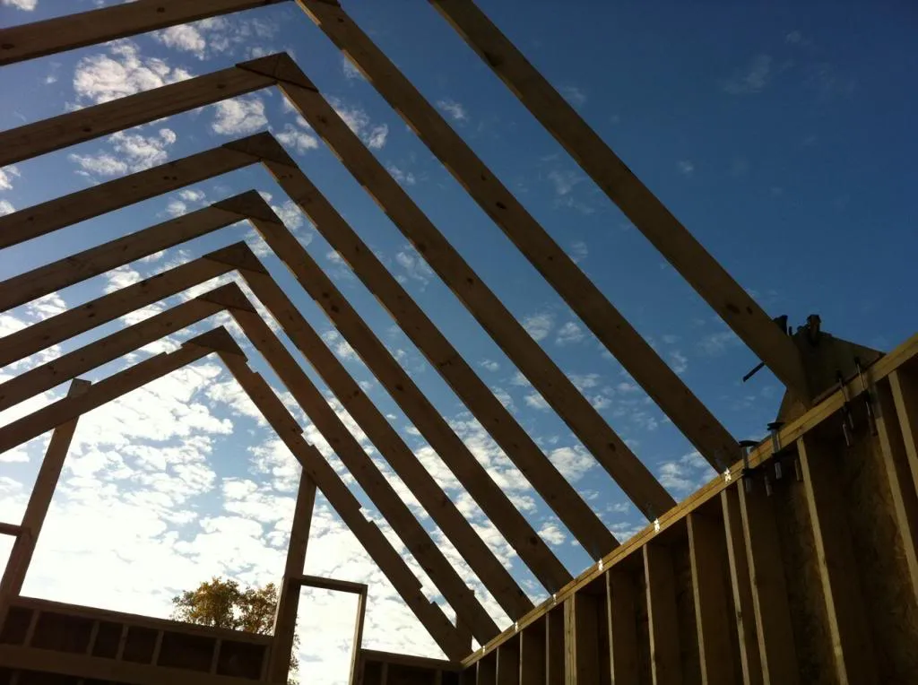

I got all of the trusses built for the main 16x28 portion of the house and hung 4 of them. I also hung the end truss on the bedroom addition where it meets the main house. It's much easier to visualize framing the valley with that up. 3 more trusses to hang on the main portion and then i'm building my 8 bedroom ones. I'll tell you what, i've used muscles that I haven't in awhile because my body aches AND use of motrin is going up!
nysono
please put some temporary bracing on the rafters ASAP, I'd hate to see a wind gust come up and over they go like dominoes....
NavyDave
I'll be bracing once I get the whole section installed. Luckily the forecact calls for winds that are light and variable and the prevailing winds are out of the north which affects the current trusses very little. I agree though I'd hate to see dominoes. The 6" timberlok screws I used through the top plate holds them pretty stiff right now though.
I strongly echo  nysono's comment. Strongly!   I've been traveling and have nor paid much attention to a lot of the postings lately, (over the entire summer actually) so I have some past due comments. But I have to catch up first.
Those rafters, they are not trusses, BTW... those rafters are just ripe for falling over and possibly killing someone. maybe the builder or maybe a bystander, innocent child, etc. One is leaning already in one photo and that is an indication of how unsafe that practice of no construction bracing is.
Many years back there was a DIY builder here who started an A frame cabin. I don't recall how many frames were positioned when everything toppled down in a heap. Luckily nobody was injured IIRC. Bracing that is planned for tomorrow sometimes never gets done.
Above comments are aimed as much at future readers, future builders who might walk away from seeing photos like that and think that the practice is fine. It's not. I don't want to hear that somebody got injured / killed. Construction is dangerous enough as it is.
Rafter vs truss:  Those are rafters with the top points held in alignment with plywood; a gusset. They are not trusses. There is no bottom chord. A bottom chord is required to enable the truss to restrain all the horizontal forces within the truss. The exception would be a scissors truss; they limit the horizontal outward forces but do not totally eliminate them.
The plywood does not offer much structural strength in the grand scheme of all the forces interacting in a roof. They make it possible to erect each rafter pair and that is about it. The "lok" screws do offer some uplift resistance, but won't help a lot tp prevent the rafters from laying over if a stiff breeze comes up during construction.
Which brings up the next question. That looks to be a 12/12 pitch. That means for every 100 pounds load (including the weight of the roof components) placed on a rafter there will be 50 pounds vertical down load on the exterior wall and a 50 pound horizontal outward force on the tops of the walls. What is restraining that outward force? The HU connectors are designed to support a downward load and an uplift load (equal to about 1/4 of the down load). Simpsons specs make no mention of using them or other joist type hangers to prevent horizontal wall spreading. If nails are used to mount such hangers to the walls those nails are being used as a tension device. Nails are lousy (no good) in tension.) Nails are meant to be used in shear load conditions. Screws are not really meant to be used in tension either. They work better than nails to be sure but then depend on the strength of the wood fibers to resist tension pull out. They are probably weaker than we might think.  Add to that, the horizontal outward force at the wall top is multiplied as we move down the wall. The wall is a lever. Assuming the bottom of the wall will not move 100 pounds applied horizontally at the wall top will become something like 400 pounds four feet down from the top...
Once again, I'm not an engineer. However, there are elements in this wall and roof design that may be future problems and, once again, I simply want to make readers aware of these points. As it sits I don't see anything holding the walls in plumb. What is keeping them plumb as the construction continues? If I've missed seeing internal wall to floor bracing I apologize.  That is without saying anything about anything below floor level, and the seeming lack of horizontal structural bracing with the piers.

I used 2x6's on angle to tie the rafters together to eliminate flex from winds. Possibly inadequate to some but definitely proven to be effective in the last two days with the sustained 20 mph winds and gusts upward of 30-40 mph.
bedroom rafters.

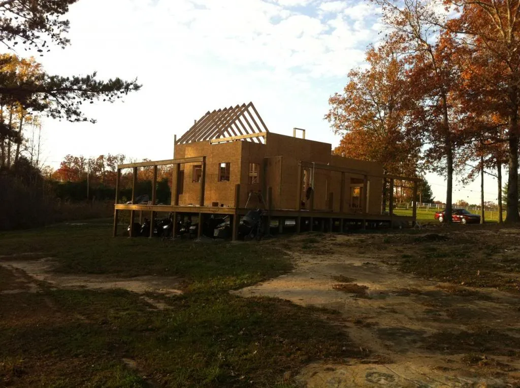

Well after 4 days of feeling the fallout from Superstorm Sandy the winds have finally subsided and let me get some work done. It was nice and chilly this morning though at 28 degrees but the sun was out and it warmed up quickly to a high of 55. Luckily it is supposed to be a very nice next couple of weeks so we should see some roof progress.
I hung the 8 rafters in the bedroom using my A-frame with a pulley system attached to it. The last 3 were interesting since I ended up having to pull them up from the outside end of the bedroom. Those L-brackets I made continue to be a VERY good investment in time. Extremely helpful. I also got 2 coats of polyurethane on the 8 foot 6x12 exposed beam that spans half of the kitchen and got it hung.

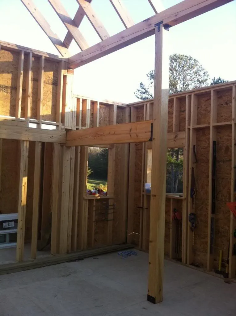

This is the west side of the bedroom addition. Notice the exposed beam materials on the lower right corner.
East side of the bedroom.

I really like the way the Poly brings the color of these beams out.
