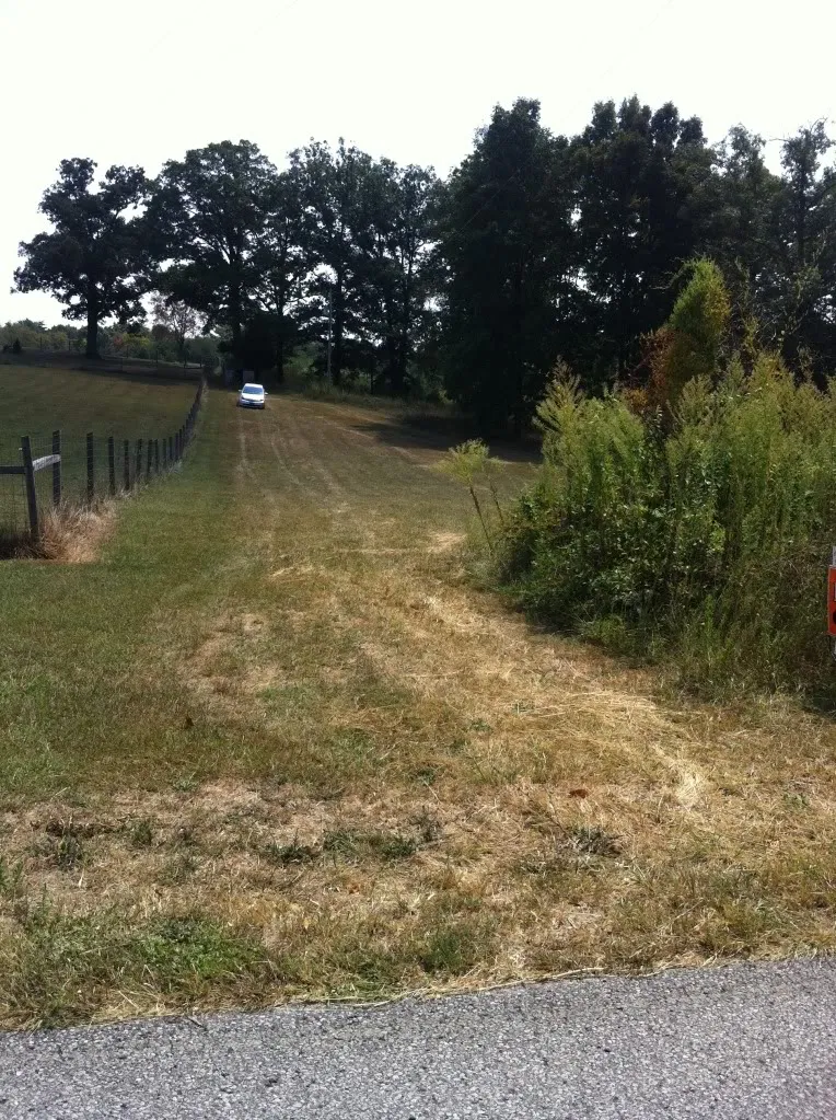

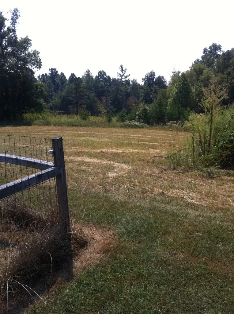

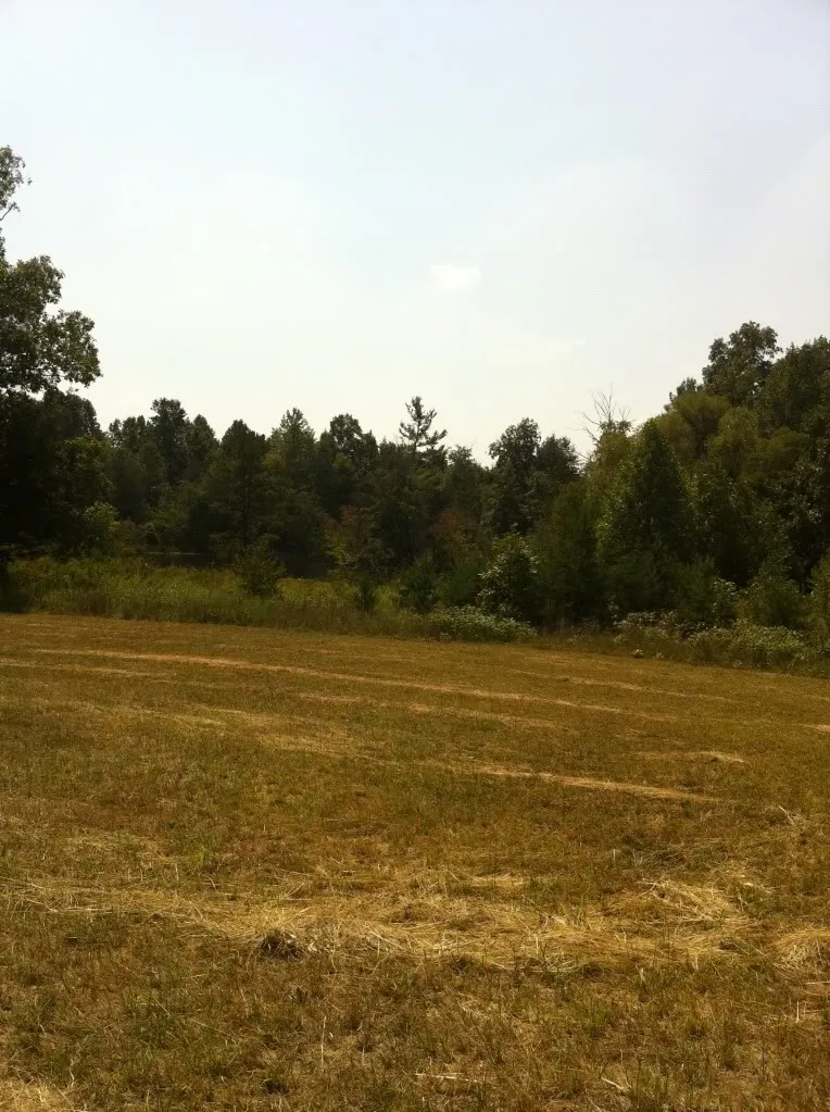

This will be the driveway onto the property.

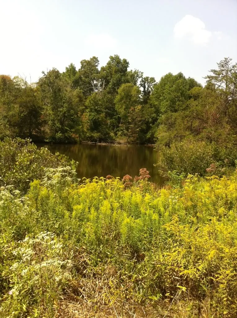

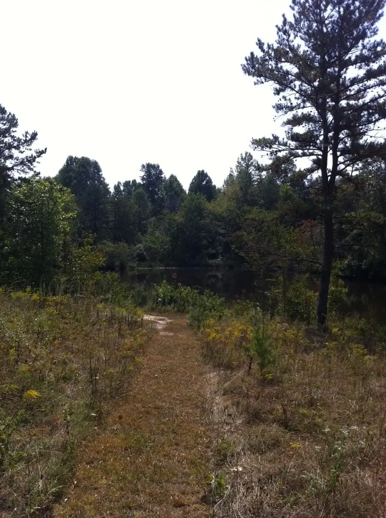

A different angle of the driveway. You can barely see the pond back by the woodline.

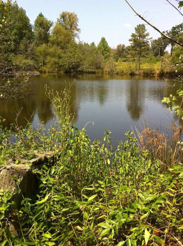

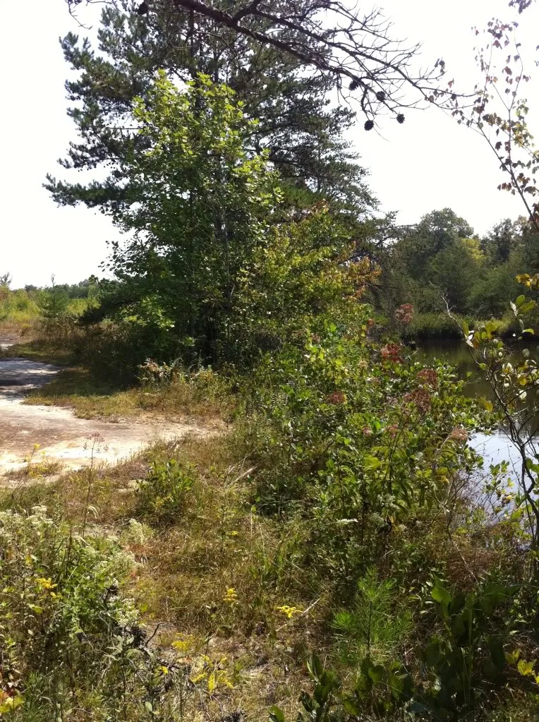

The pond. The home site will be to the right hand side of the pond. The driveway would be almost in direct view of this picture if the knoll wasn't there.

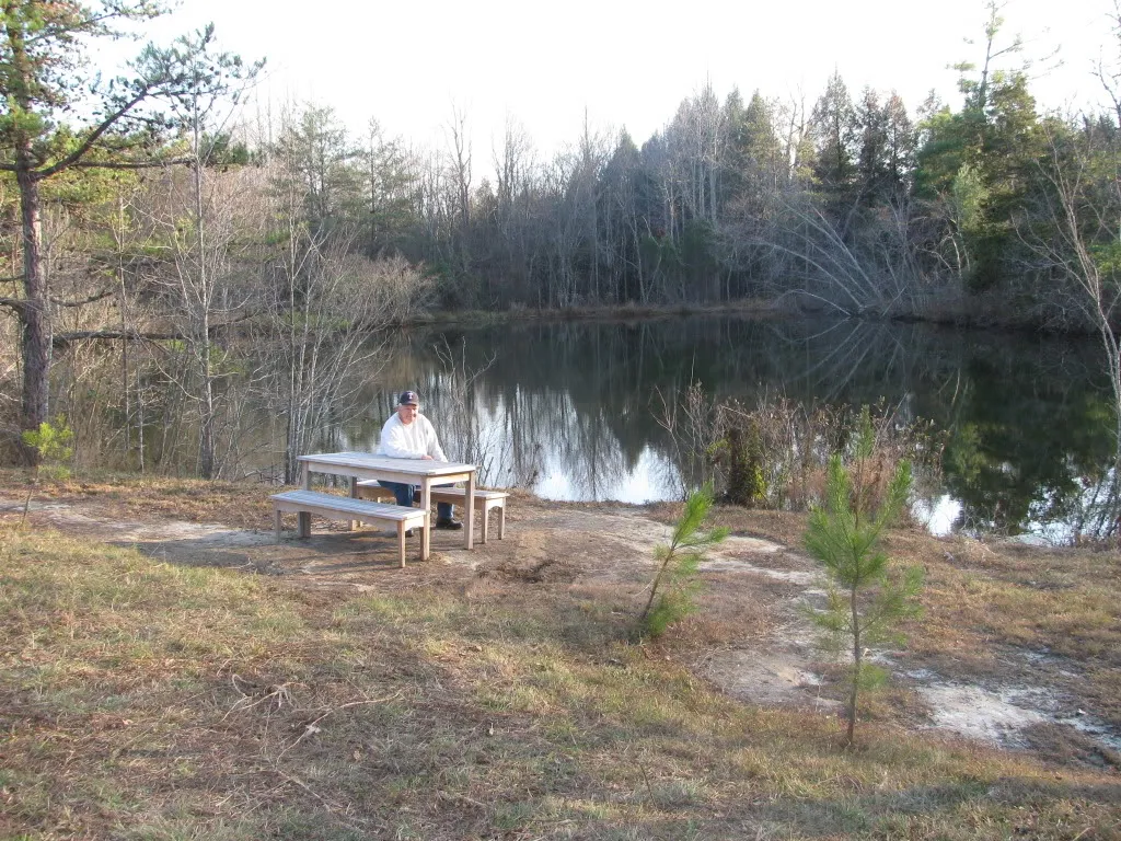

Another pond shot. The homesite is located in back of me and to the left a bit. Notice the rock ledge in the pic, this should make a nice solid foundation.

awsome pond - I can see you enjoying that in the future
as a note some shales are expancive - check what you have before designing your foundation

Nice looking place. Do think about the shallowness of the soil when thinking about bracing the piers. There isn't enough soil sitting on top of the ledge to provide any rack resistance to the posts to resist the wind pushing on the walls above.

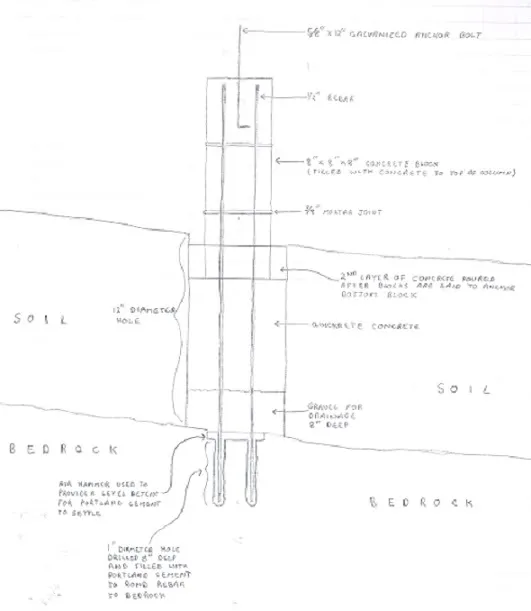

Here's a rough sketch that I think may be what some of us would call the "final plan" of my piers. Hopefully the quality is ok.

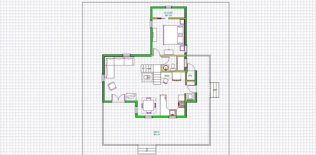

Also here is a floorplan of the main floor. The kitchen bumpout is facing South and looks to the pond.

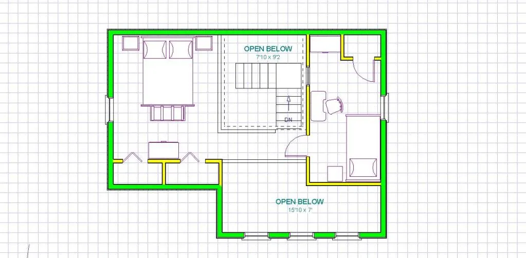

And here's the loft floorplan. I kind of copied Scott Lemay's idea on his Michigan 16x26 and added a touch of personalization.
If you have bedrock that you're digging down to, I don't understand the gravel layer at the hole bottom with concrete poured on top.  ???  Why not just concrete right on the bedrock? I don't think you need drainage if you have solid rock available at the hole bottom.
Also if you can angle the drilled holes some they will provide better uplift resistance.

I wasn't sure about the gravel to be honest. You actually answered one of my uncertanties. Now I have a new final plan!
I've read about angling the holes also and I'll see if I can make that happen while i'm drilling. Should be interesting as to how i'll be able to get that done. Thanks Don.

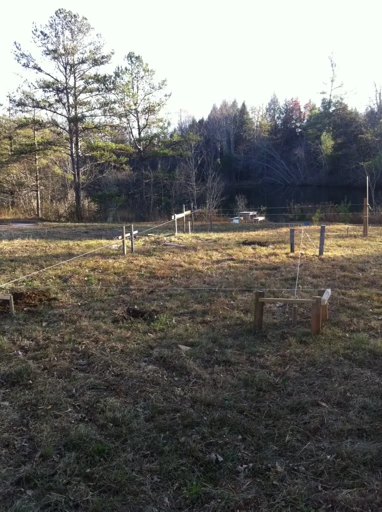

The progress begins! I spent all day yesterday pulling my 10 foot trailer filled with my tools from Wash. DC to the site in TN. My parents met me here and today Dad and I spent all day long clearing/preparing the site, building batter boards and figuring out where each of the 25 piers will be situated. We are pretty happy with the progress so far.
Tomorrow we'll be augering all of the holes and figuring out exactly how much topsoil is above the bedrock. I'll be renting a rock drill to drill 3 holes into the bedrock about 12 inches. I'm going to try to angle my holes for my rebar as much as possible to help with uplift resistance.

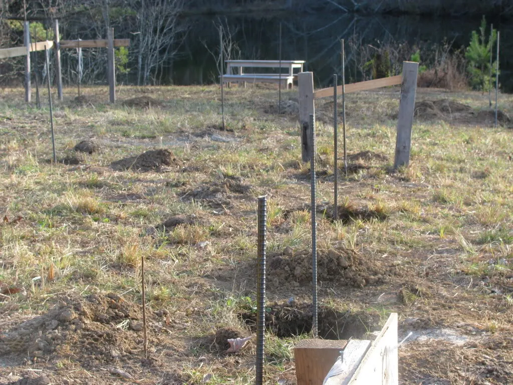

Jeff, I read through your entire build and you do great work. I just hope mine turns out with similar character. Long hard day today. I augered 25 holes down to the bedrock and widened the holes to about 14 inches in diameter and cleaned them so the bedrock was bare. Tomorrow dad and I are drilling and mortaring in the rebar.

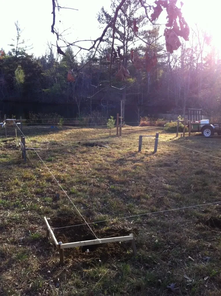

I'm back in DC now and the week was a very busy one. We made almost as much progress as planned except for not being able to por the piers because of the septic situation. We got a lot cleared on the site and were able to get all of our holes drilled in the rock and the rebar cemented in. We also were able to build all of the beams. Lots of nails in those beams! I can't wait to get down there full time in March. We made good friends with the neighbors and made some good contacts in the small country town. Can't wait to start our new life in the country!

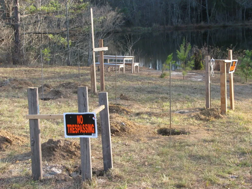

augered and rebarred holes

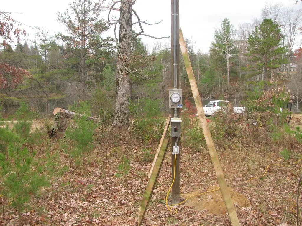

Temporary electric service

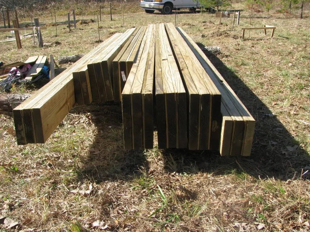

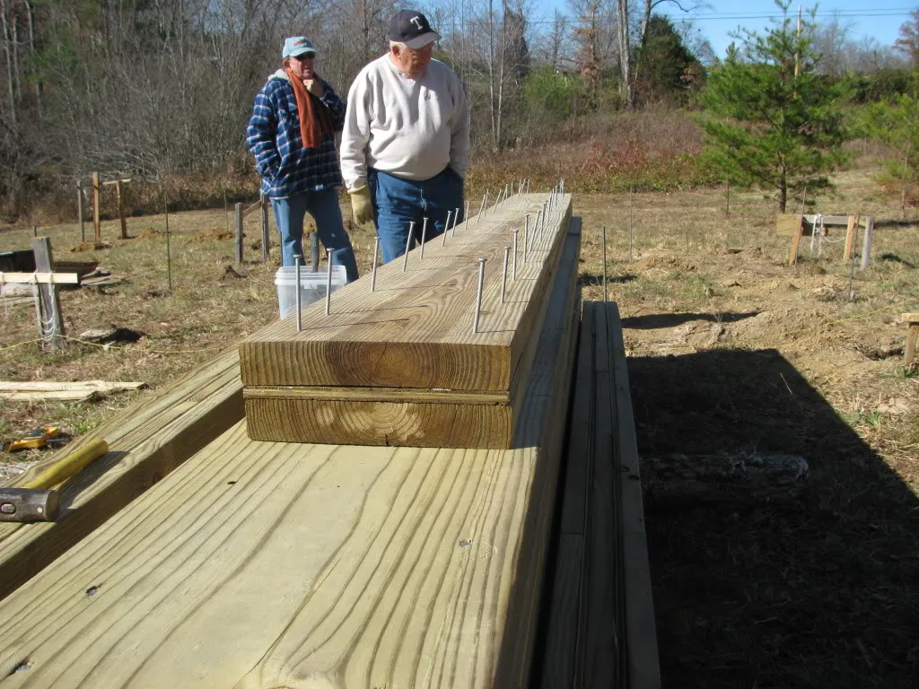

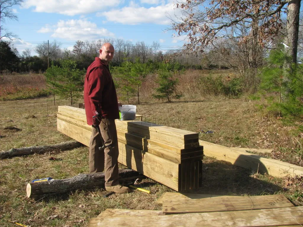

Building the beams
Lots of nails!
Finished beams
Breaktime for dad

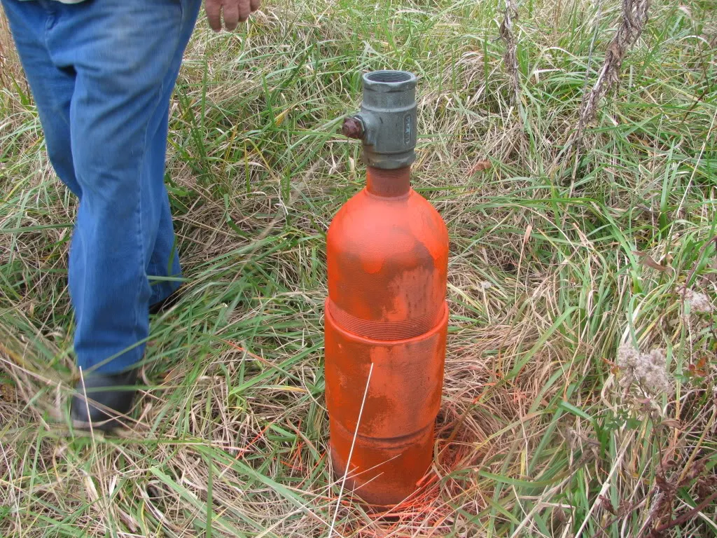

Bonus of the week! we found what we think is a natural gas well on the property! we still need to have the pressure tested to see what the output is but this may be a real find.

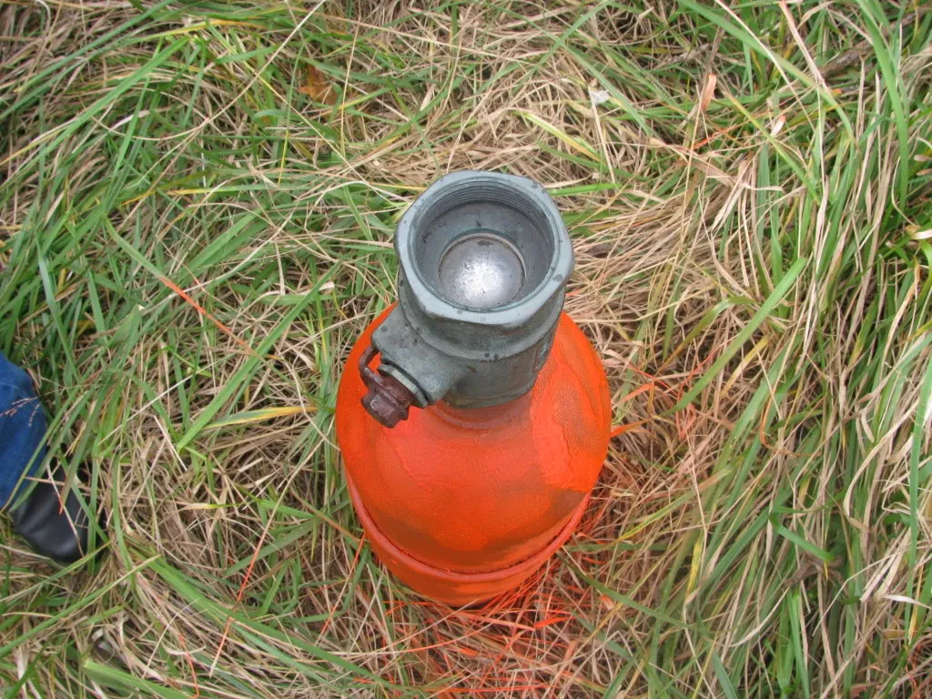

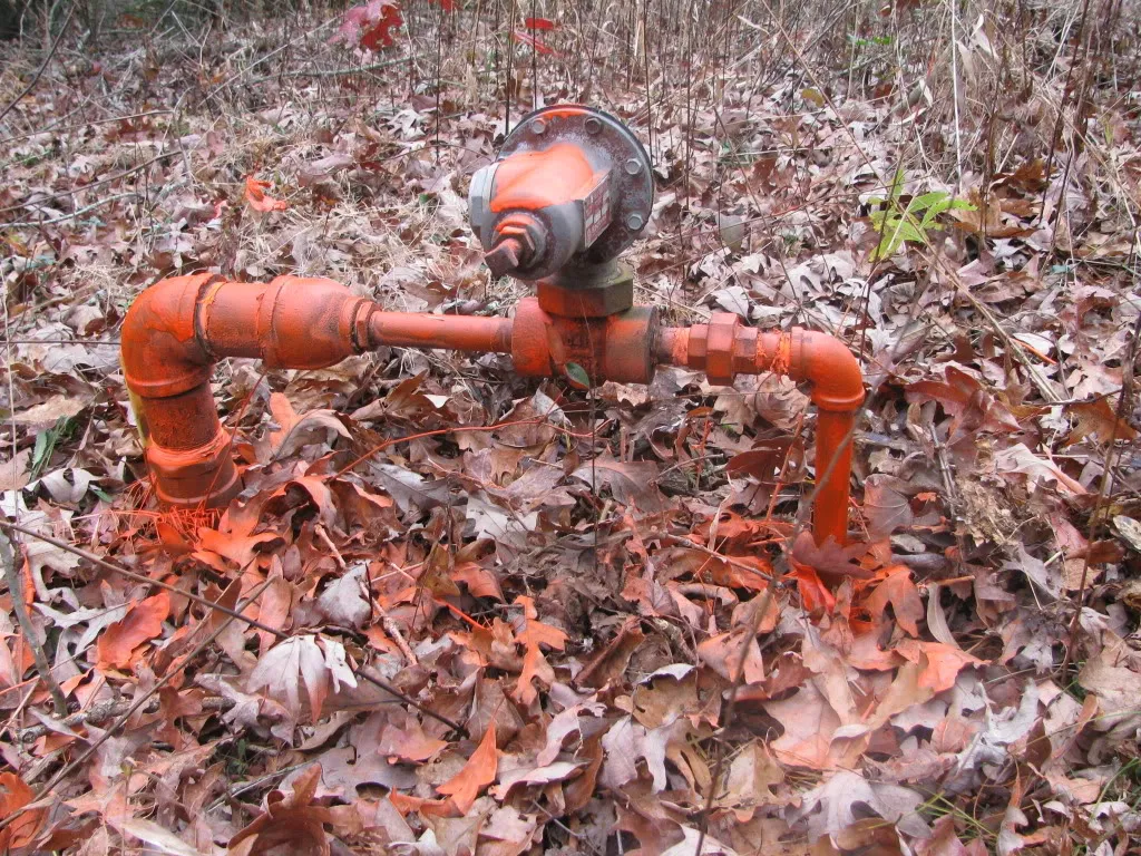

I'm not 100% sure what this is?? It's a couple hundred yards from what I think is the gas well. It's in the woods and not by any structure. Any ideas?

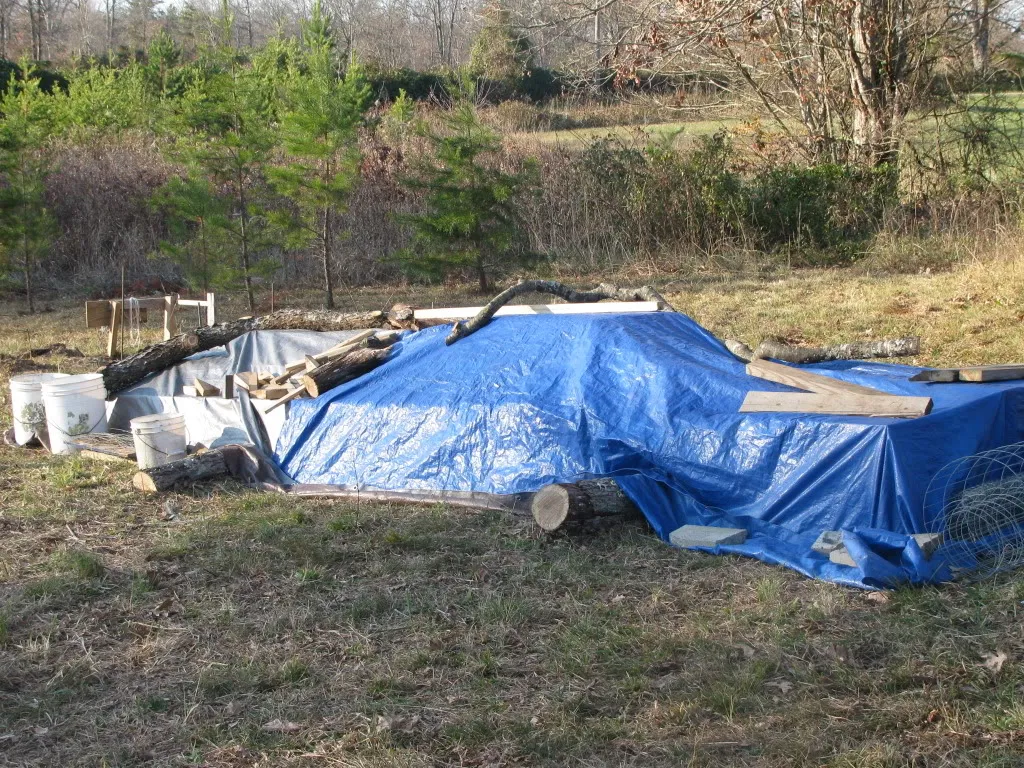

Beams all covered for winter. Be back in March!
#23
Check your deed and the county tax office for an easement.  I'd have Miss Utility come out and flag the line... and don't blast till you straighten this out.
Barry Broome
Looks like a cut off valve, perhaps for the lp.
