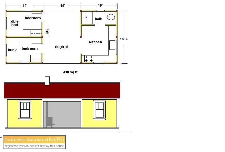

Here's my rework of the plan, with one tiny bath instead of two (you could do an outdoor shower in the Bahamas, couldn't you?) and some built-in bunks with bookshelves.

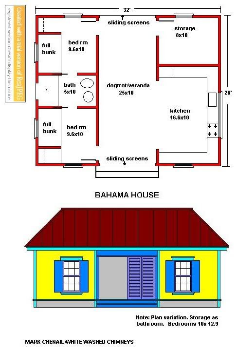

Heres a couple of quick sketches I pulled from my files to show what I meant.  Now lets see if I can post these. :P  :-/

Nice workup Mark! You have a good sense of space and a practical design sense.
The Dogtrot is an inexpensive and easy to build structure with a maximum amount of privacy in a limited footprint.
I have a version of the design (a bit bigger) that I've played with for some time. The dogtrot center is a sunroom type space with a glass roof. (Not for the topics but great in the temperate zone I'm in.) The right side is the public and social space (eat, cook, sit) and the left the private spaces (two bedrooms and bath). It could all be built on a post and pier foundation.

I like that rework you did Ailsa ! How'd you do that ! Your suggestion, and Marks', has me thinking of making the two bedrooms into one, and incorporating the 'dogtrot' concept. Ventilation is a serious consideration (hence the windows in the baths and closets), and I have an adversion toward central air - on many levels. Yet, as you might imagine, screens are essential; the mosquitos and no-see-ums are preposterous here, at times. (just when the bonefishing heats up !).

Beached  and Ailsa:  I really need to pay attention.  I naturally meant those designs for Beached but saw Ailsa's rework and thought the original post was hers.  Sorry for the confusion. ;)

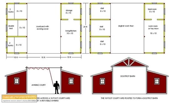

If you like dogtrot designs perhaps you will enjoy the attached.  This was done for a couple from texas who have recently bought land near me in Missouri. They wanted a structure they could camp out in for the better part of a year while they built a permanent house that would lend itself to conversion to other uses later on.  I gave them a sort of dogtrot compound sheltered with an awning that would convert to a drivethrough barn later on.  The structures will probably have dirt floors to save money, except for the storage room, but  I suggested they might lay a bed of sand and put down patio blocks, which could be re-used later. The storage room will have a temporary sawdust toilet.  Comments are always appreciated.
Here is a printable gif file of the first diagram: http://www.countryplans.com/Downloads/DBLSHED.gif
and the outline framing diagram for a pole buiding: http://www.countryplans.com/Downloads/DBLSHEDFRAMING.gif

Oh good.  I like that plan.  Very practical.
rita
wow!  I love this dog trot barn.  Are the ends completely open?  could this be altered to be usable in colder climates?  I love the comcept.

Rita:   Theres no reason you couldnt close both ends of the barn by putting in a good sized header and installing sliding or swinging doors.  You might want to install some clerestory lighting in the short upper walls as well.  A barn of this type is called a monitor barn.  Heres a pic of a modern version.
