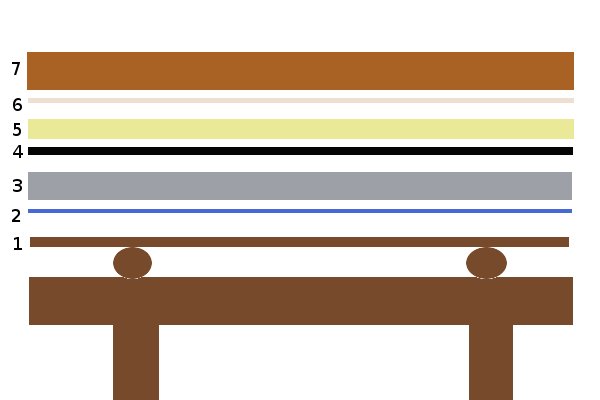

Also, I currently have about 7 layers in my "roof lasagna" and I'm trying to decide what order to put them in.  Any suggestions welcome.  Also, bit of a side note but I know there are rules about which side of the insulation to put your vapor barriers on depending on whether you're in a warmer or cooler climate but our winters are about equal to our summers imo.  Gets up to the high 90's in the summer and down to the teens in the winter  ???.  I basically have no idea what I'm doing here but this is what I have in my head...
7)  Earth (6-8"?)
6)  6mil PE "umbrella" layer extending 10-20' beyond walls (the only layer I'm 100% confident I've got right)
5)  Sand drainage layer (1-2" of sand to drain off anything that makes it down to the main membrane and protect main membrane?)
4)  Main membrane (maybe that billboard tarp?  I've been collecting used 25mil pool liners as a possibility.  Bite the bullet and do real EPDM?)
3)  5" Styrofoam insulation panels (best way to secure these in place?  Someone mentions duct-taping the seams for thermal reasons, overkill?)
2)  Regular old tarp (bought a huge tarp to cover the roof so I could store stuff under, any reason not to just leave it on there as a layer of last defense?)
1)  2" of wood planking that everything goes on
Any input appreciated.  Layers to add?  Subtract?  A better order to put them in?  To be honest I'm all researched out at this point and just want to get on with things.  Thanks!!
Mike told me that there is a good safety factor in the engineering tables so, close is good especially with reduced loading.
I have found the billboard tarps to have some wear and the pvc in them to be a bit brittle leading to cracking at folds so I would prefer using them as a secondary and using real EPDM as a primary.
A friend purchased from this lady and had a good experience.  She has drop points in several places and is about half price of many places.
Layers look good other than the EPDM.  I think we talked about French Drains - use them.

I also understand the agonizing your going through with the way the layers are arranged.  I think it looks pretty good (as far as my RESEARCH i have done).  THE Duct tape i think is overkill and i dont think really improves it any.  IWe did it on our project but I had was trying to create another barrier between the 2 layers of insulation.  You have one layer so I believe the big thing to get right is the two membranes above and below the insulation.  These two membranes should seal any cracks or joints you have in the insulation.   The big thing it to make sure there is no way for outside air to get in through the sides.  Being that you are completely underground I think that should be fairly easy?
One thing to consider is something like old rugs to protect that top poly layer?

Most of the general building research I did stressed on and on about things like roof ventilation and making sure the vapor barriers didn't sweat into the house and it all sounded very intense.  But now that I'm here I can't really remember which, if any, of those concerns were pertinent for underground/living roof set-ups.  I don't think the ventilation concerns or keeping air out will really be a problem though like you say.
I'm still wondering how well I need to secure down the insulation.  If I screw in each corner with a 6" screw and washer that might work but would put holes in the tarp below (maybe not a huge deal since I wasn't even planning on having that layer originally?).  I'm guessing with all the weight on top the foam panels aren't really going to want to move around once in place but I'm not really sure.
Thanks for the EPDM link Glenn, confusing site but the prices look great.  I do remember now you saying the billboard tarps have brittle corners, that's a shame but thanks for being the guinea pig.  French drains are the first thing I did on the house and I will continue to put them in everywhere I can.  A lady recently gave me 200' of perf pipe and I've still got several yards of gravel lying around so I'm armed and ready.
Thanks for taking time to respond, I know you're busy so no rush with anything.
My pleasure, guys.
I will use the billboard tarps as a secondary vapor barrier - covered up they will not deteriorate more.  Worst case would be a gopher  directing a flow right over a small hole - not too likely and 99% will be deflected leaving only a little for the EPDM or other barrier to take care of.
No need to secure roof insulation - just lay it from the bottom up having plenty of membrane to get to the top and cover it with a bit of your sand or whatever was the next layer.  Start at the bottom and work up as Mike instructed - no problem.
