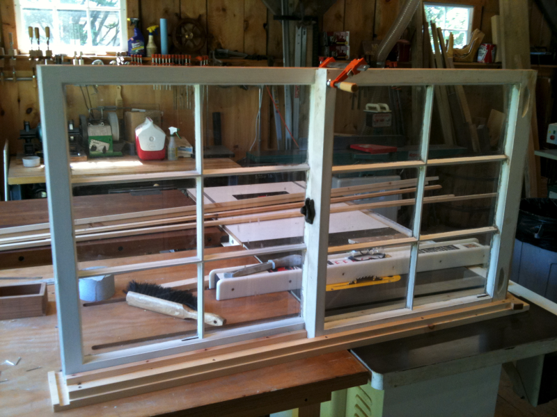

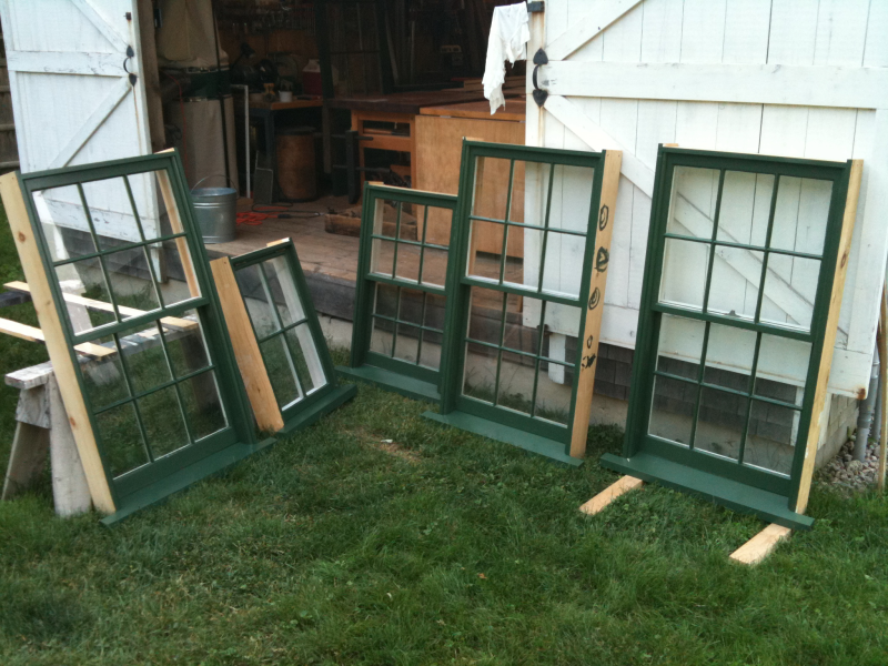

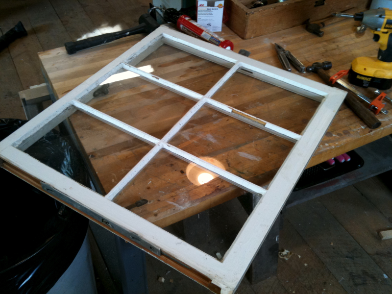

For our cabin, I was able to score (for free) 12 real divided-light wood double-hungs my neighbor was throwing away during a remodel. The frames and sills were either too rotten or too damaged by the renovators to be usable, but the sashes themselves were still fundamentally sound:

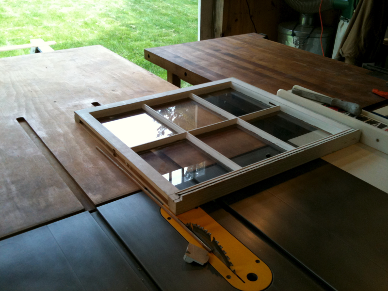

I removed all the hardware and squared them up on the table saw:

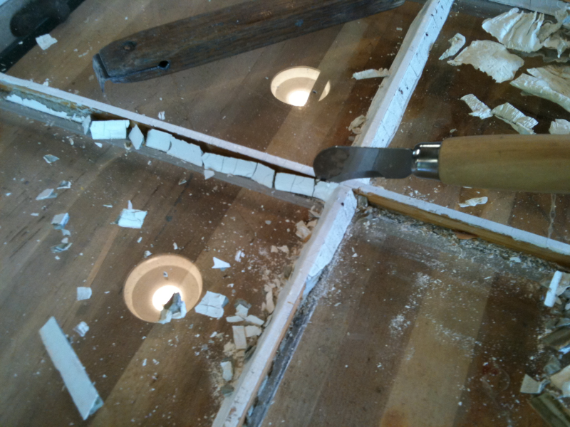

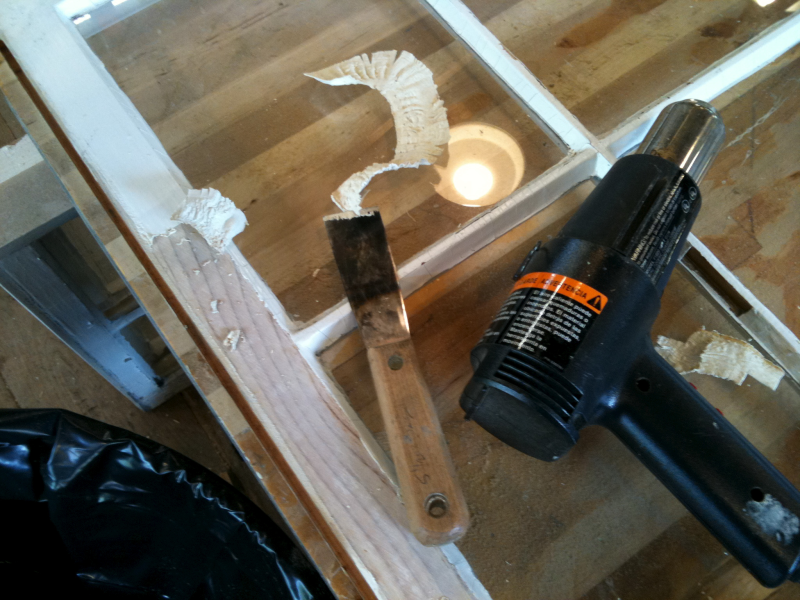

Paint and putty are pretty easy to remove with heat and scrapers. Cracked panes were pulled out and replaced, and the wood given a good sanding with a random orbital sander.

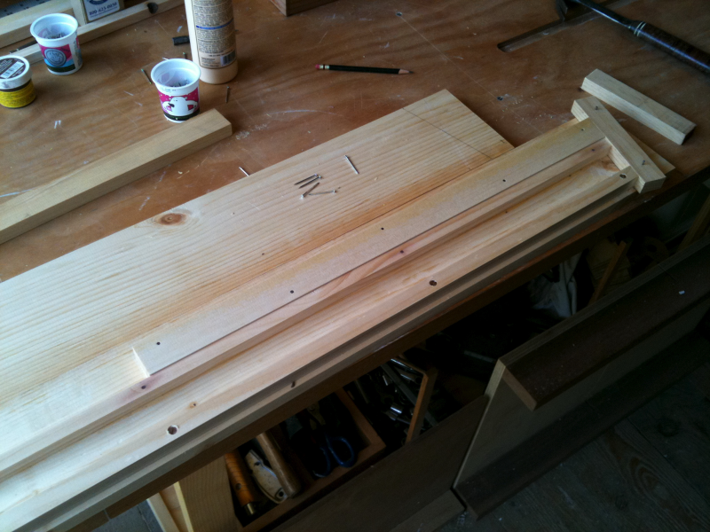

To keep it simple, I rebuilt the windows as "single-hungs"; the upper (outer) sash is fixed in place. Only the lower sash moves up and down. I built the frames out of 1-by pine, fastened with silicon bronze screws and stainless finish nails. Two guide strips allow the lower sash to raise and lower; the upper sash rests on a filler strip and is held in place with 1/4 round moldings.

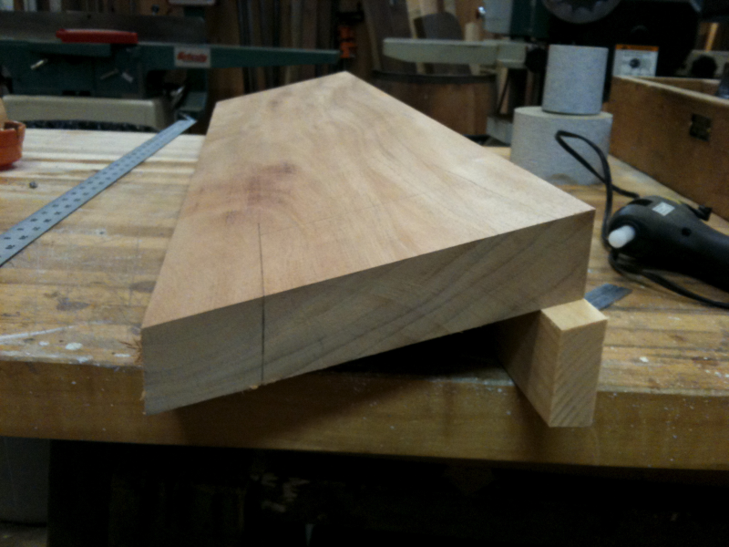

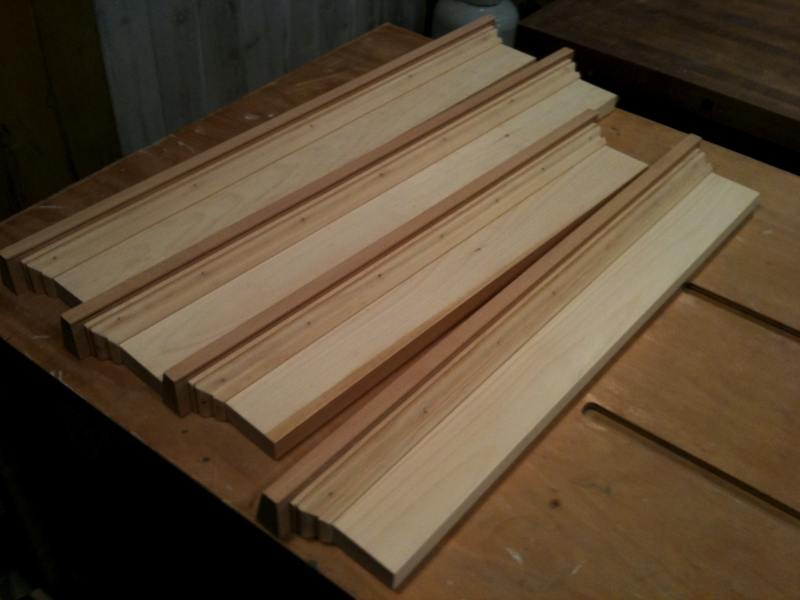

The sills were milled from 6/4 mahogany (I'm a boatbuilder, so I have a pretty sweet offcut pile to pick from; any decently rot-resistant wood could be used for the sills). I bevelled them at 15 degrees and notched them to fit around the casings.

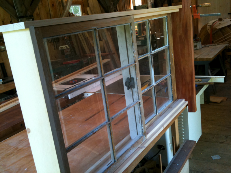

I notched the meeting rails to fit around the outer guide strip, then dry-fitted the whole assembly.
Then I disassembled everything and pre-primed all the parts with CPES epoxy followed by oil-based primer, and re-glazed the sash with Dap 33.  Everything was permanently assembled with Titebond II and marine-grade sealant, then given one coat of finish paint. (The small window in this pic is a single sash unit, hinged at the top and intended for the sleeping loft):

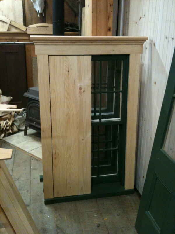

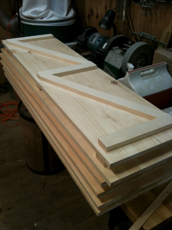

I then built all the trim and the shutters from cedar and pine.

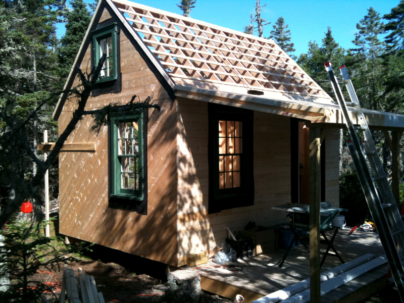

Finally, installed on our cabin in Nova Scotia:
Besides aesthetics, the main advantage of building or rebuilding your own windows is cost. All in all, I was out no more than $100 or so in materials for all 5 windows. There were quite a few hours of labor involved, but I totally feel it was worth it. Modern windows just look out of place on a rustic cabin, IMHO.
As far as disadvantages, these windows are definitely not as weather-tight as modern units, and the fact that the lower (opening) sash isn't held up by springs or counterweights means that it will come crashing down if you don't support it. We plan to use expanding window screens to hold them up when opened.

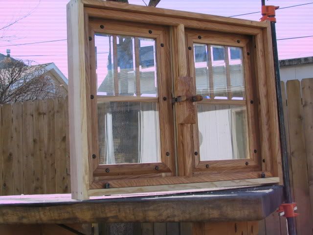

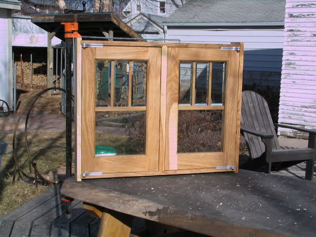

I managed to get a few pictures of the window that will go over my kitchen sink.  I made it out of Ash that I milled my self.  Its a casement style window that will have the screen on the inside.  The trim and screws around the glass act as a clamp to compression  seal the double panes of glass.  There is a frame sandwiched inside the 2 panes that hold the beveled lights in place.  I need to install the screen mesh before I can install the hardware that allows you to open and close the windows.
This is a close up shop of the center of the interior screen frame. I needed something to mask where the window locks protrude through the mesh. Seemed like a fine place to use some of the cut offs from where I had to cut loose knots or other structural defects while I was cutting the parts.  Its a shame that the really cool grain patterns seem to go hand in hand with some of the worse defects.  I will be using this kind of stuff to make all my cabinet door knobs and drawer pulls along with any other little do dads like this that I end up needing.
Between this picture and the first I think you can get an idea of the simple lock I made.  They are 1 eighth thick aluminium stock made in to a hook that catches a pin in the door.
Here is a shot of one of the simple scissor hinges I made from 1/4 aluminium.
And this is where my camera crapped out!   I knocked it into the door frame carrying the window back in to the shop and after that all my pictures look like this. d*   Sorry Rob when I figure out the problem I will post more.
