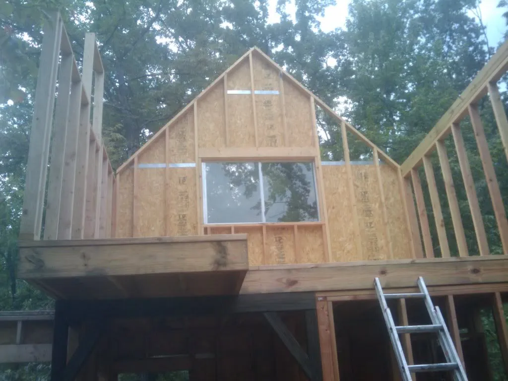

Hello All, not sure what took me so long to register, but here I am!  I would like to share my project with you that my wife and I are building in East Tx ( 2hrs away from our home in Dallas).  I have done much research in preperation for building but I am still learning more everyday.  So with that being said, any and all input is welcome ( critiquing, concerns, ideas, etc.)  I will try to post as many pics as I can as I go along, and if you have a question about something that is not clear in a photograph just ask and Ill be happy to give details.  Enjoy!
This is my progress to date

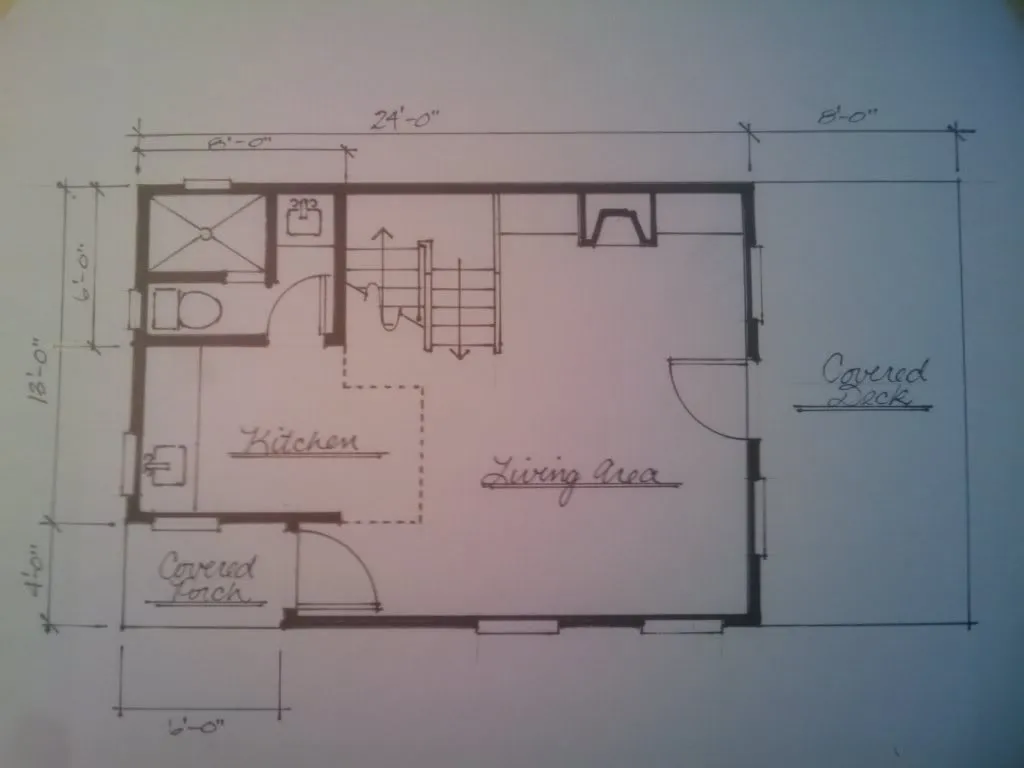

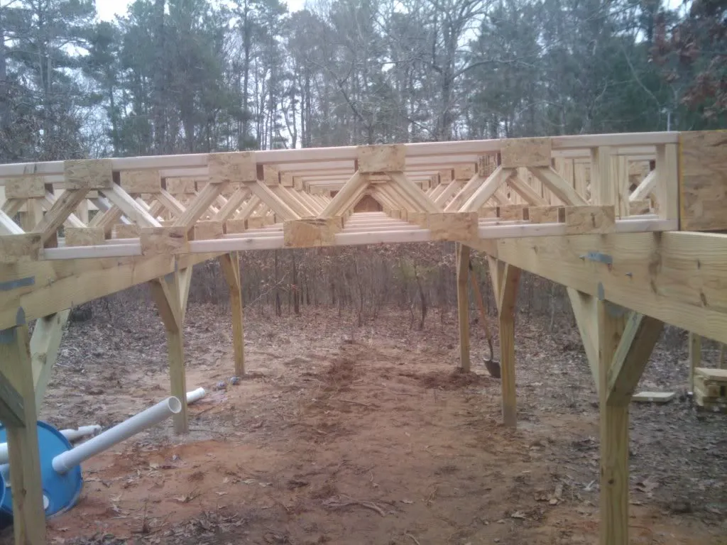

looks good.  have a floorplan you could share?  kind of interesting the way you extended the support beams... almost tree-house like.  i like it.
nathan.principe
yea I do, let me dig it out and Ill take a pic of it and post it

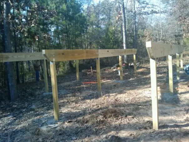

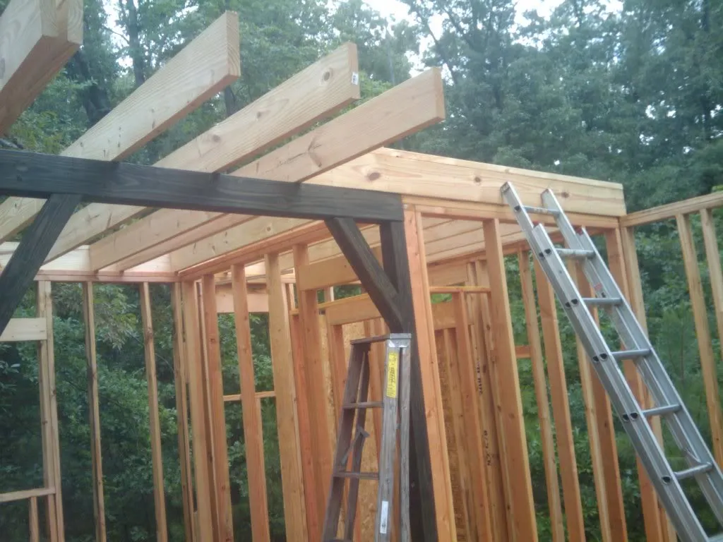

I have a question on the beams. The beams appear to be 4x12. Is that correct; two 2x12's with a spacer sheet?  They are on 8 foot centers, as well?  I ask because using Table 502.5(1) in the IRC for a roof, ceiling and one center bearing floor, two 2x12 could be used at a pier spacing of 8'1" for a 20 foot wide building. Yours is slightly narrower so there would be some small additional safety factor. However with the extra floor at one end that may be pushing the limits a tad far.  Of course if this is from a set on engineered drawings, that may be completely fine. It is just something that I wonder about.  (two floors in Table 502.5(1) lists pier spacing at 6'8")
One other concern that comes to mind also centers around the beams. The end extending beyond the outer end wall could be a potential source for the ingress of water. The protruding end could be a pathway for water to be drawn under the floor joist and along the beam. That could lead future rot issues.

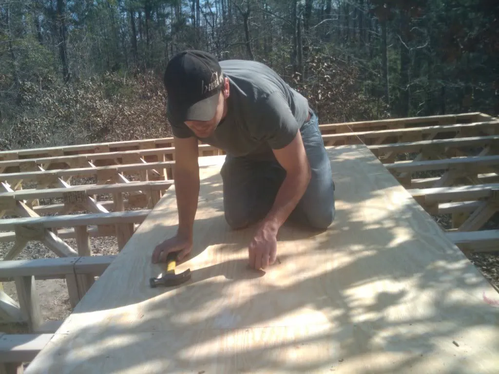

We don't see many truss floors around here, especially ones with OSB side plates. Are they factory made or owner built from a plan set?
One other thing that nags at me... the stair stringers.  It appears that the spacing is greater than 16 inches. maybe appearances are deceiving. 16 inch is fairly normal and in some places those stairs would be required to have stringers at 12 inch OC. My mind keep running a picture of 4 or more football players running down the stairs.

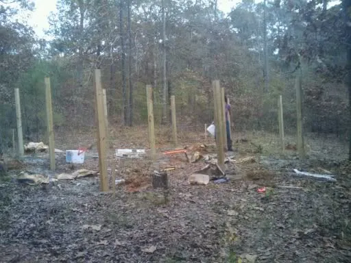

   If I may ask, Why is your first floor platform so high off the ground?
   I also, am interested in your floor plan . . .

MountainDon- You seem to be a celebrity around here so your keen eye to detail is much apprieciated.  To answer your questions, you are right on the size of beams, excluding the spacer, only double 2"x12".  I had the very same concern you did, so if you take a closer look at the picture showing the stairs and the very next one, you will see additional posts.  Under the portion of the beams that carry the load of the 2nd floor I installed 2 more additional posts per 8' section ( this gives me post approx 29" o.c.). For the rest of the beam I dropped in 4"x6" posts between all the rest of the 8' spans, making the spans 4' o.c.   What really bugged me is I used 4"x4" posts  d* this is the main reason for all the "beefing up".
                   In regards to the beams extending further from the end walls I had never considered your point, they are more of a "design detail",  what can be done about that now?
                   The stairs are a work in progress, the joist hangers you see in the picture are temperary and only served as means of keeping the stringers in place till I could sink a 1/4" lag from behind.  My end goal is to install railings on the stairs and porch and when I do I plan on extending a 4x4 post from the ground on either side right up snug the stairs and porch and bolt in place to both the stairs and porch, the post will extend up to become part of the railings.  do you think I need to do this more to the center of the end stringers as well?
Bayview- The answer to your question is nothing scientific.  We wanted to gain a higher vantage point to extend our views as much as possible, also I just think its kindda cool.  As cbc58 mentioned, its kinda like a treehouse effect
I see the extra posts..... they just didn't "register" upstairs...   d*
Quote from: nathan.principe on September 28, 2010, 09:01:09 AM
... the beams extending further from the end walls I had never considered your point, they are more of a "design detail",  what can be done about that now?
chainsaw.   ;D  Just cut off the ends with a chain or reciprocating saw.   The protrusions could also be flashed as long as you can still get the flashing slipped in under the sheathing and have it extend out over the top of the beams.
There might be a similar concern with the beam that extends under the entrance porch. Not sure what can be done at this point on that other than keep an eye on the integrity of the beam over the future years. Depending on how wet it gets it may not be a problem.
cbc58
another idea on those protruding supports is to place a board on top of them to create a shelf (angled slightly to shed water) and put plants on there.  siding/flashing would have to be done really well.  just an idea if you have to keep them for design.  maybe the pros here can say if that is feasible.

As  Promised here is the floor plan,  I had to redraw it so im not sure all measurements are 100% accurate, but very very close.  The loft is represented by the perforated line and sits above the kitchen and bathroom.  The fire place will be electric and have bookcases built around.  Hope this helps

MountainDon,I forgot to answer your truss question.  I made the trusses my self, I did not have them engineered.  I did some research and modeled them after others that I have seen in a similar situation.  The reason for doing this ( and using OSB) was cost.  To make them myself was pretty labor intensive, but I found it was cheaper ( and lighter) than then standard dimensional lumber.  I feel they ended up good, they are super rigid and the floor has no give.
I haven't seen anyone make trusses for a long time. Many years ago I made some using plans from a publication from one of the ag universities. They used plywood plates and waterproof resorcinol glue, plus nails. They were roof trusses but the principles are much the same. I was just wondering how these came about. You are darn right on them being labor intensive.

I have noticed that you have barrels with tubes coming out of it.... what is it for?
nathan.principe
hahaha, I was waiting for someone to comment on that.  That was my attempt at a small homemade septic system, after I brought it out to the site, I didnt get far on the installation before I was notified that I would need a permit and inspection for a septic ( I was told through the HOA that I wouldnt need a permit for anything, shouldve know better).  So for now a septic is on the back burner.  And while Im on the topic, Does anyone have personal experience with a composting toilet?  or electric incinerating toilet?  My 2 big questions are : do they give off oder when confined in a small space, and can you use it for #1 or just #2?  I am thinking I can get by having a simple "grease trap" or "dry well" type septic as long as theres no sewage involved ( only for sink and shower)  what do you guys think?
