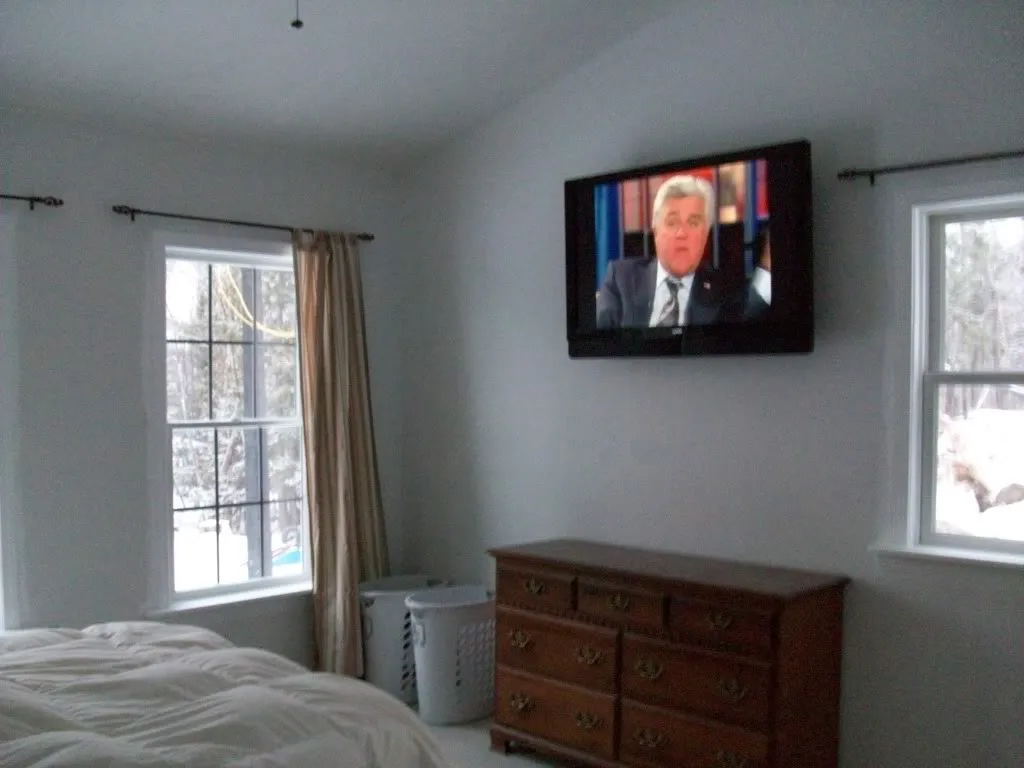

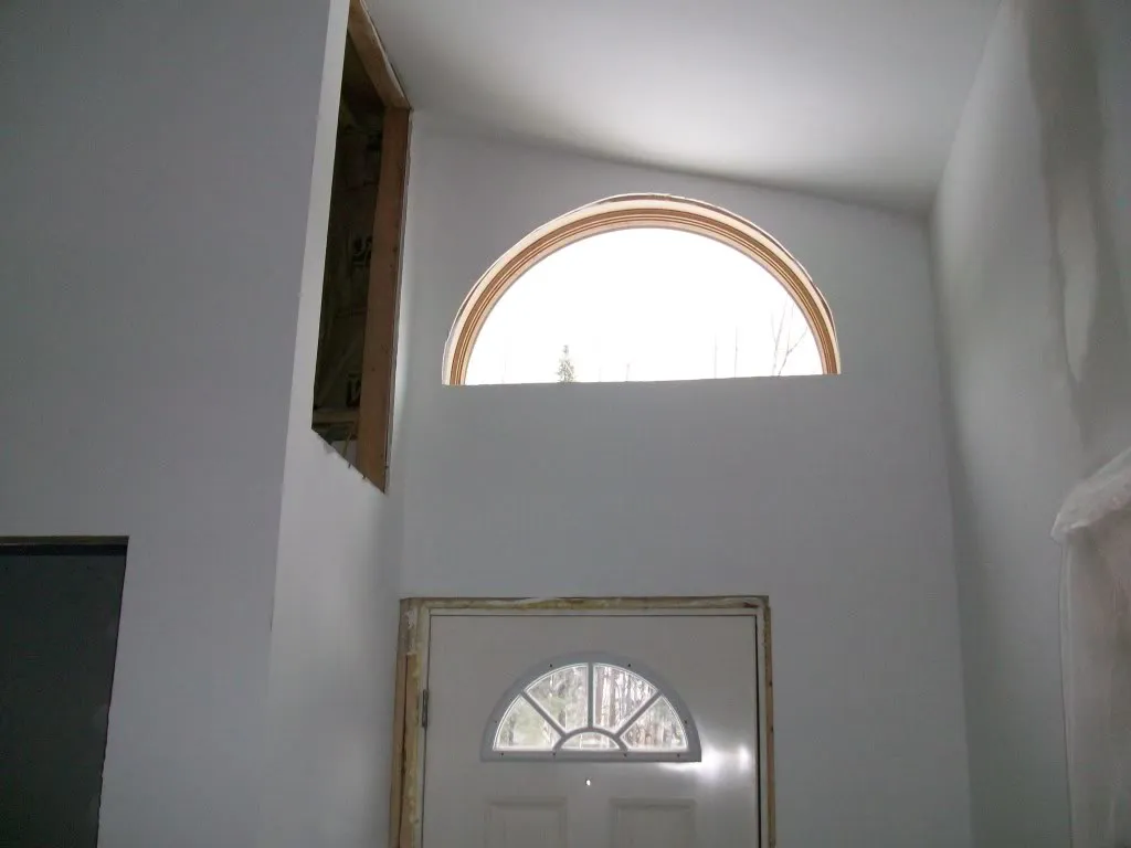

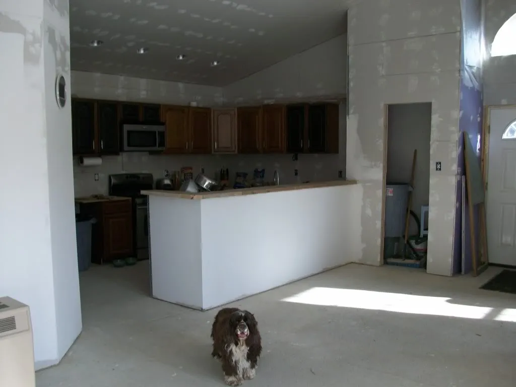

Heres a few other pics of the unfinished "current state"  ;D
Nice desktop monitor....   :)

Also love your walking dust mop.  Spaniels are some of my favorite dogs.  Great companions, fun to hunt behind but can get in a lot of trouble from being so bull headed.
considerations
Ahhh, somebody else living in an unfinished project.  Encouraging.   You are farther along than I am.....and it looks good, you are too humble.
