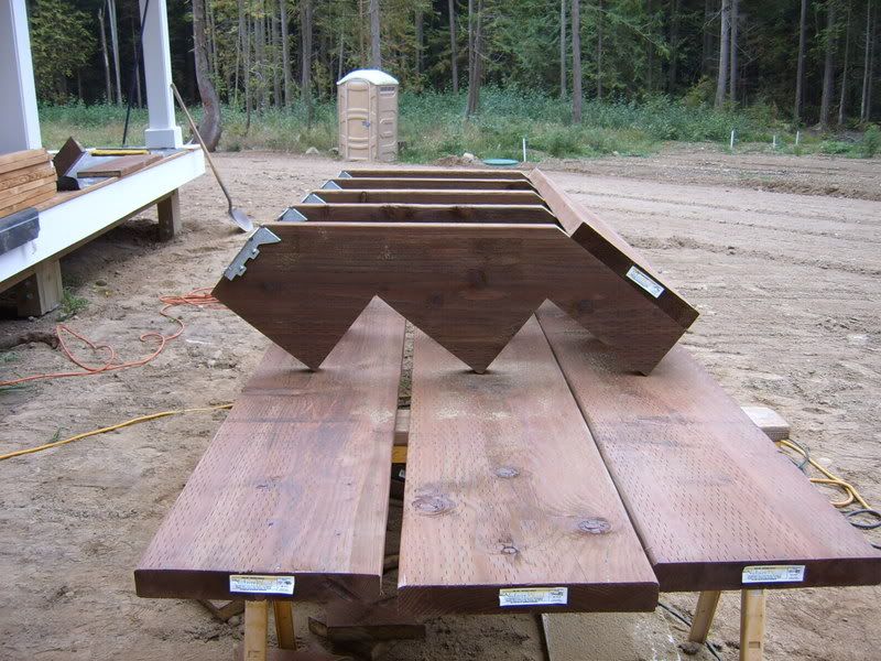

I went with the 12' walls (ballooned framed) with 4x12 timbers set at 8 feet (the bottom of the timber).  It gave me about 3.5 feet upstairs until the roof started.  My cabin is only 18 feet wide.

Let me add this additional photo, it is a little later on in the process.  I meant to add it first but must have clicked the other photo.  It shows my finished ceiling height of 8 feet.  So I guess I have rafter ties AND collar ties?
