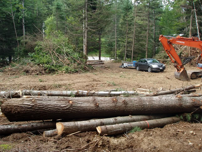

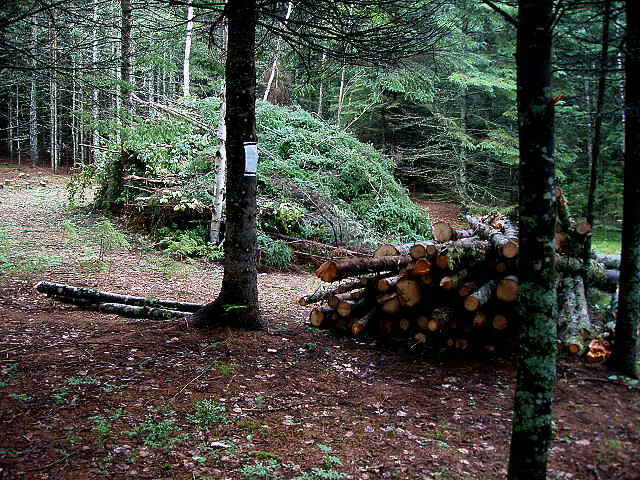

Most of the clearing was done by hand.  The lot was so thick it was hard to walk through.
Pile of saw logs that I kept.
Pile of slash and pulp logs.

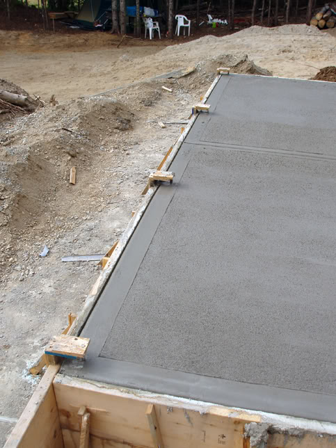

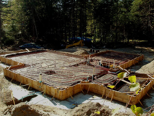

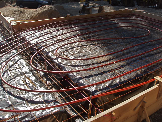

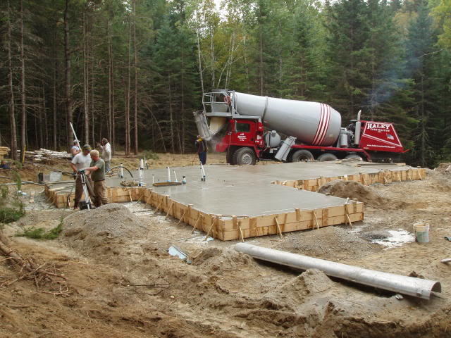

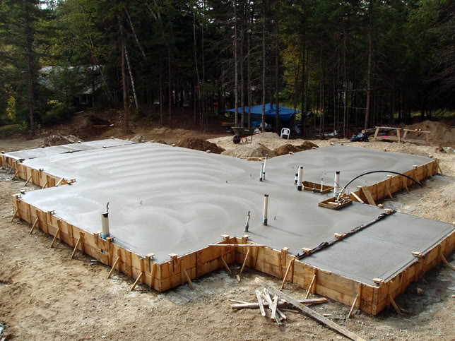

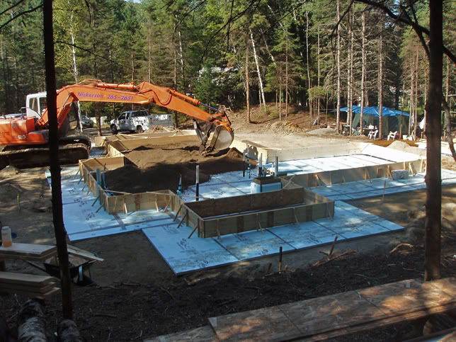

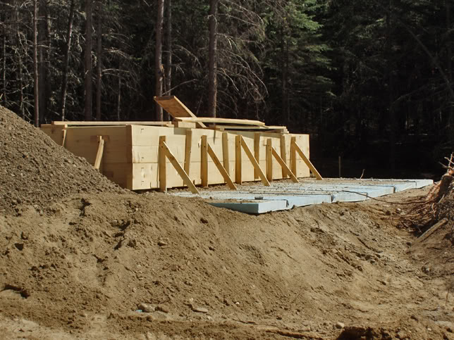

Filling the form with two lifts of gravel.  My foundation is a FPSF with radiant heat.  I took the design from the NAHB design guide for an unheated space (I want to have that option)
Almost all of my formboards were recycled into the building as rafters and whatnot.
I used 7/8" pex - two zones.
The pour was about 20 yards.
The porches have a broom-finish.

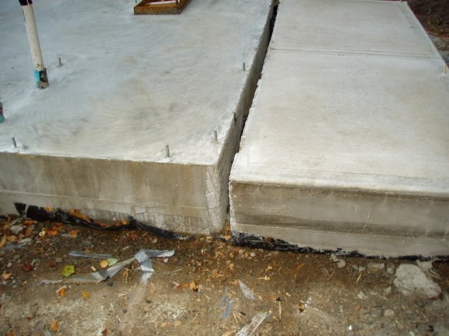

The "thermal break" between the heated slab and the exterior porches.  Later, 2" rigid insulation slid in this gap.

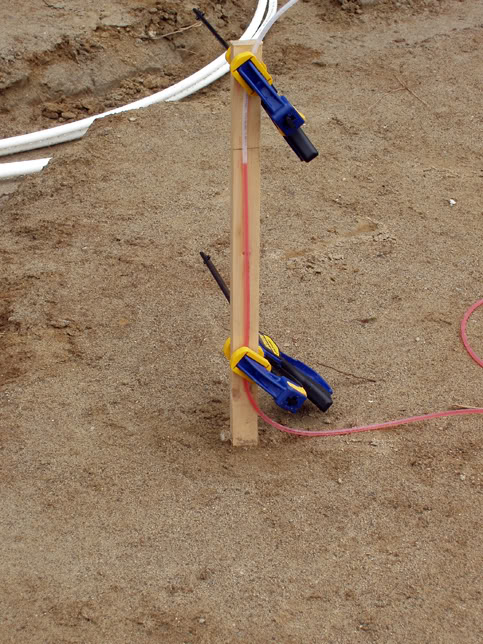

My water level.  I didn't use any fancy transits or lasers or whatever.  This cost about $2 (food-coloring included) and was very reliable.  My concrete contractor didn't trust it so he set up his laser transit and I was within 1/4" all the way around.  I actually trust the water level more.  :)

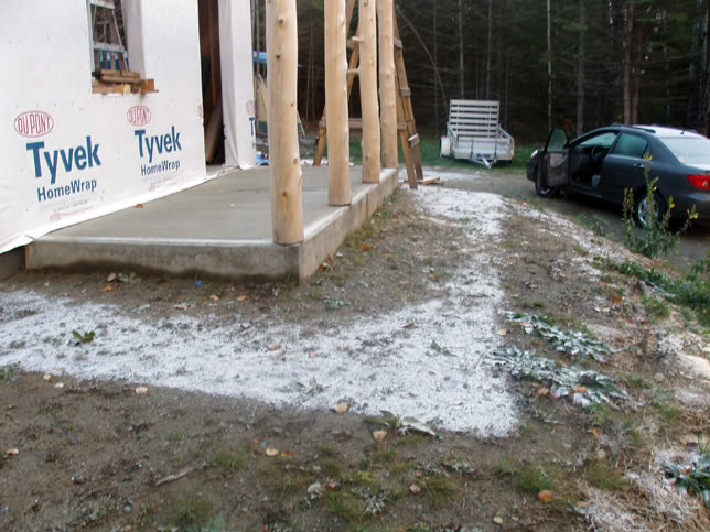

This is the FPSF in action.  Notice how the snow didn't melt above the perimeter insulation conserving geo-thermal energy below my slab pretecting it from frost heave damage.  Pretty cool eh?

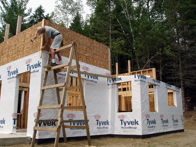

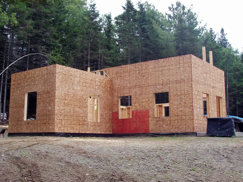

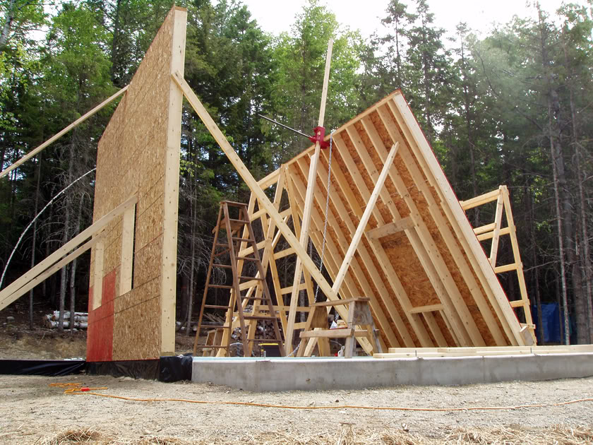

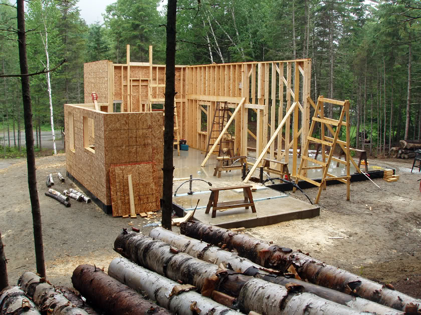

I raised my walls solo with the help of a single wall-jack.  Notice the "runaway" chain to prevent the wall from ending up in my yard.
Wall #3 going up.

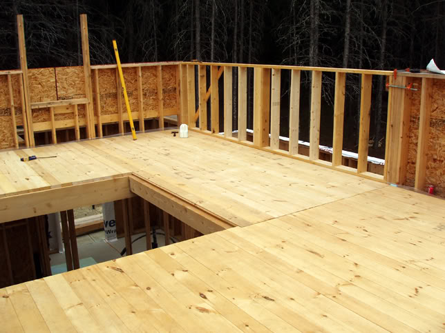

Notching for the 2x10 band-joist.
One of my best purchases was a few lengths of chain and a handful of turnbuckles I found in a junk shop.  I used these A LOT!

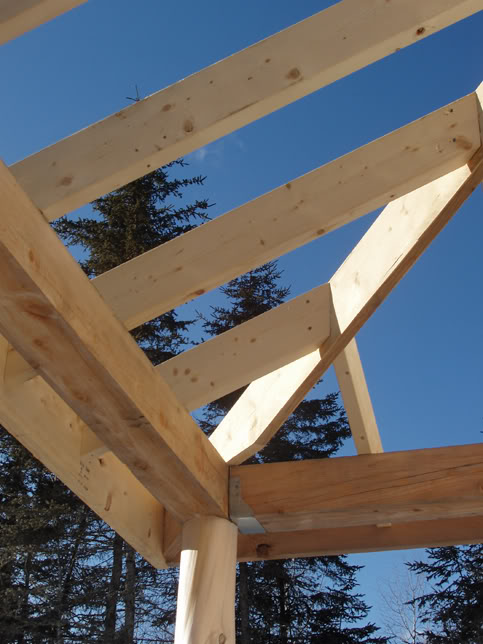

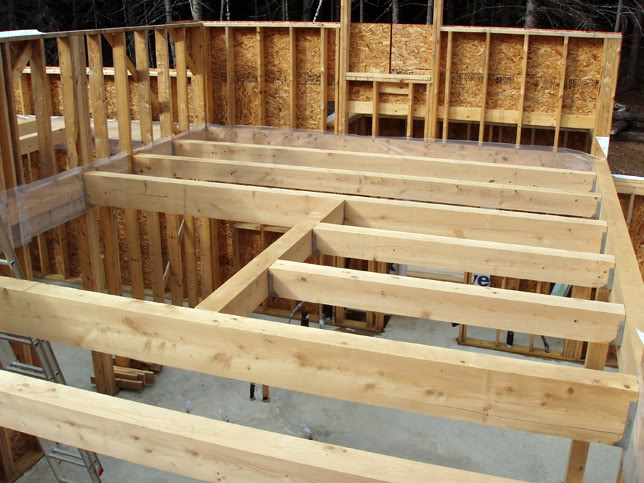

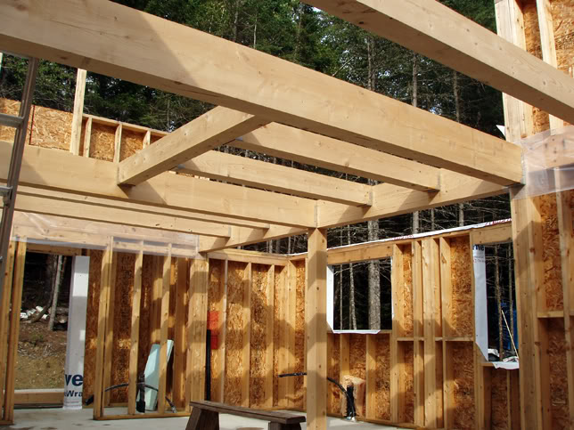

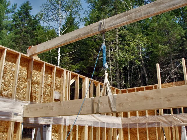

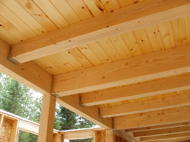

Using logs to position the beams.

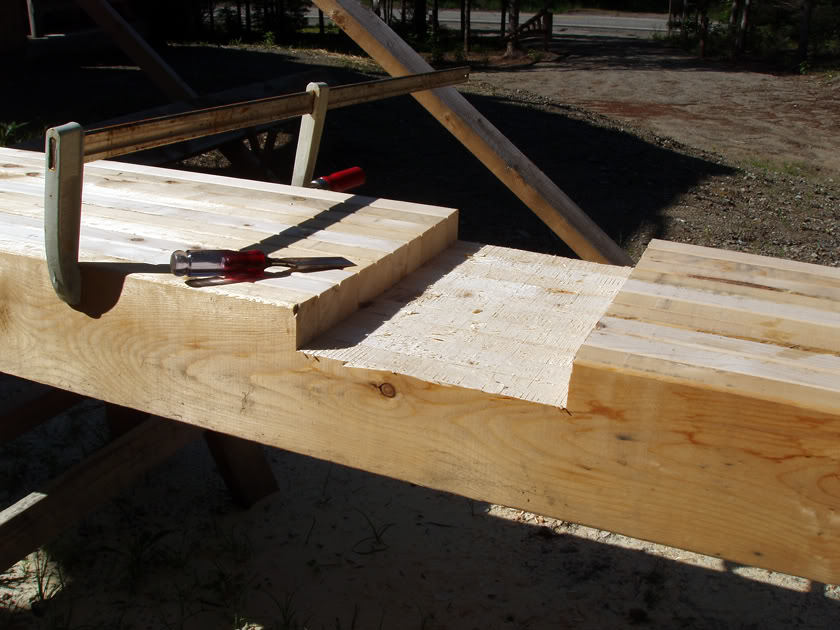

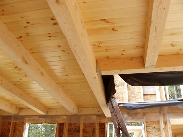

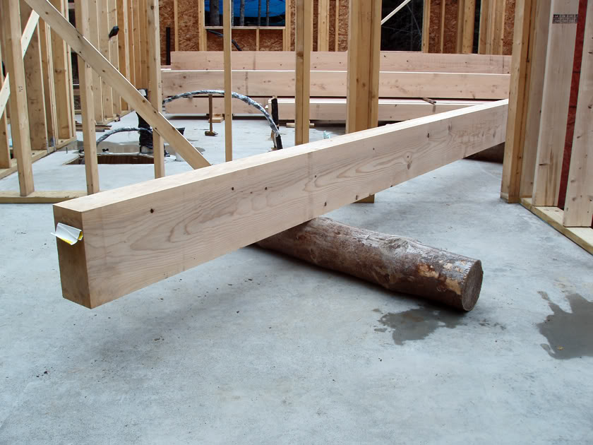

The first beam going in place (the 6x12).  I used a block-n-tackle to raise all of my beams solo.
This was actually a lot of fun (but also a little dangerous - I had to stay on my toes)
Dropping a beam into the Simpson Huc hangers (concealed flange).

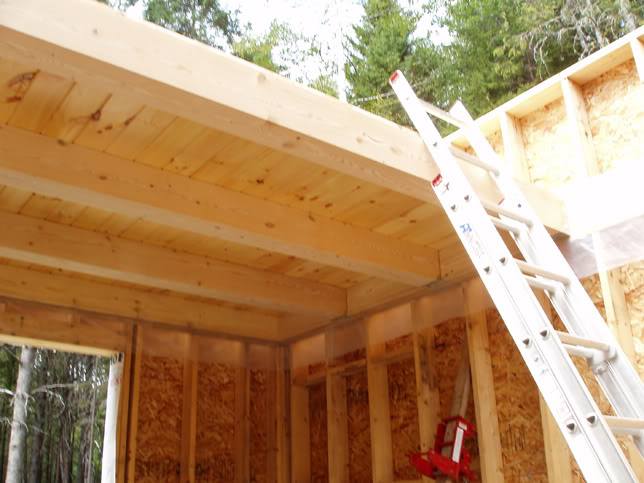

A local yard milled these hemlock beams for me.

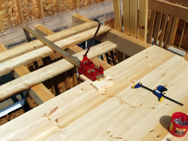

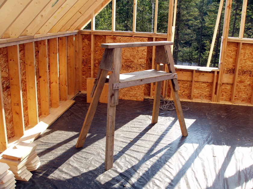

I used the wall jack on really stubborn boards.
Two coats of Polyurethane were applied BEFORE the boards were put in place.

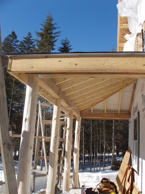

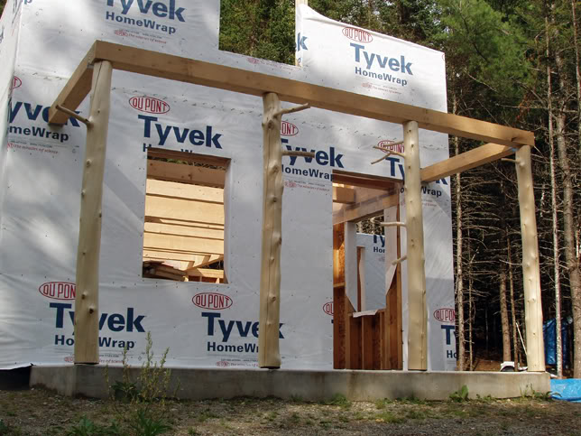

Natural white cedar posts used on the front and back porches.

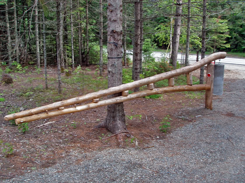

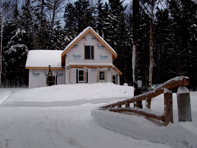

I had some cedars left over so I made this entrance gate.

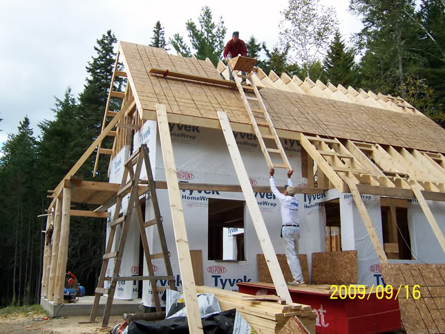

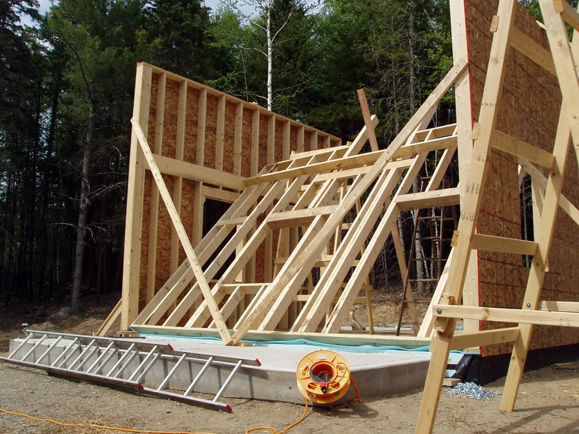

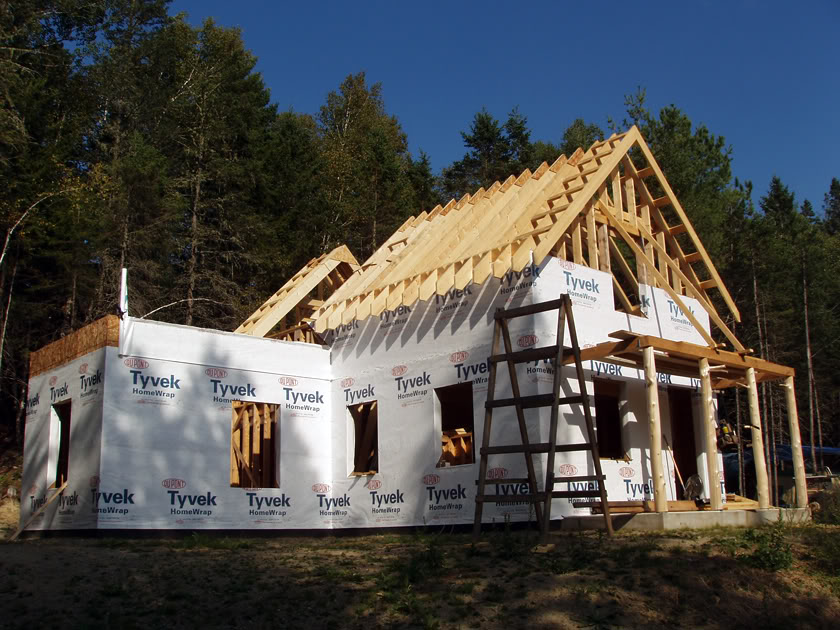

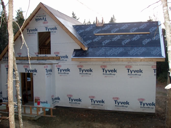

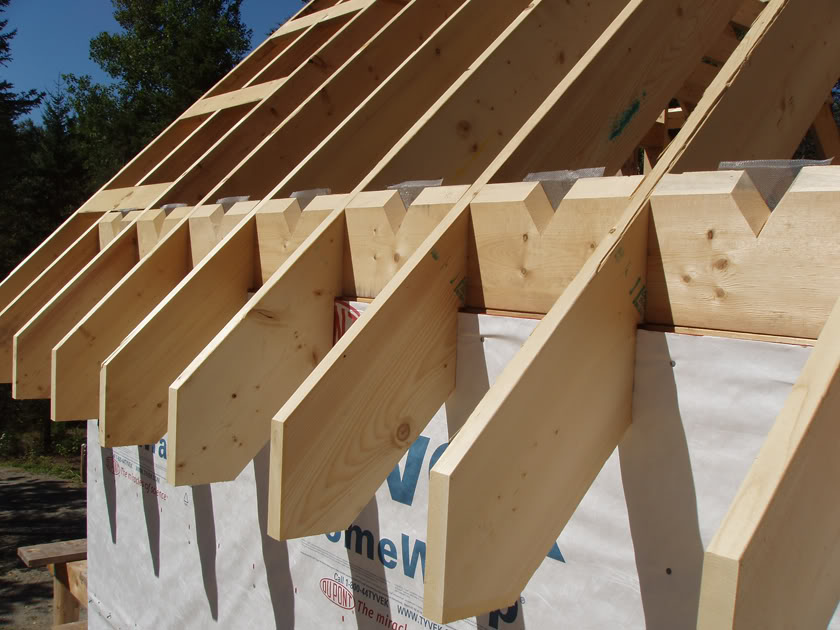

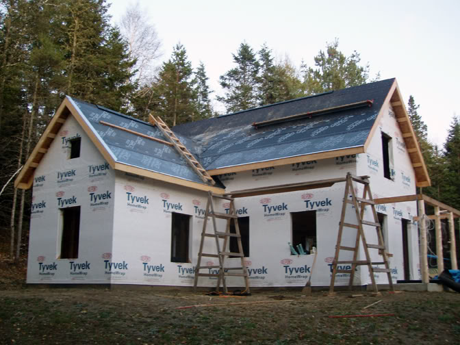

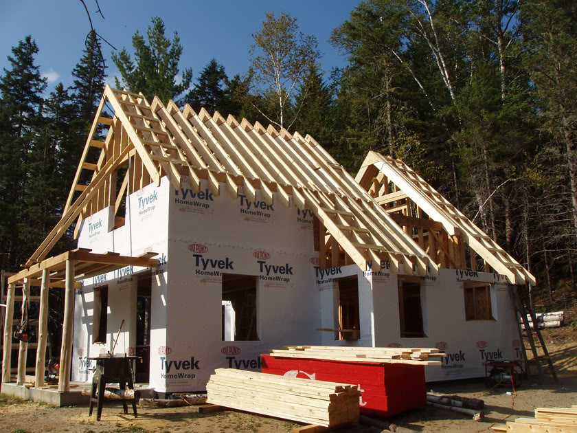

Okay, some more pics.  The next stage of the project was to build rafters and put them in place.  Again, I'm working solo so there was some interesting problem solving.
The only scaffolding I used were the two A-frames I made.

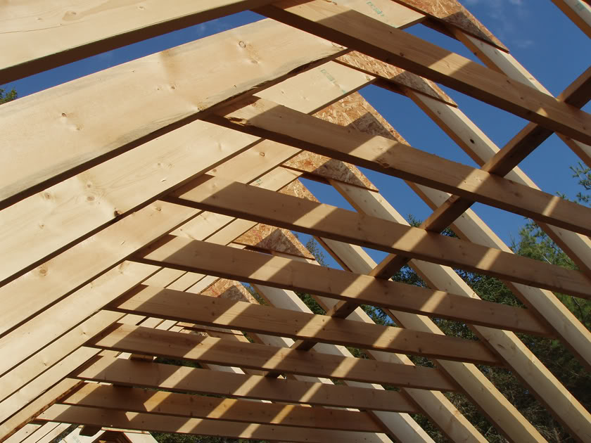

Notice that I have all my trusses pre-made and stacked against the back gable end.  Also, I used 2x10 rafters over the kitchen bumpout so I would have a deep insulation cavity.
My vent blocking.  It was easy to set up my big table saw at home and make all of these production-style.
Site-built 2x10 trusses 16 OC.  Double 1/2" OSB gussets glued and nailed.  The collar ties were nailed on after the trusses were up.  This is DEEP snow country so I over engineered everything.
Proof that I do occasionally come down off my high horse.  :)

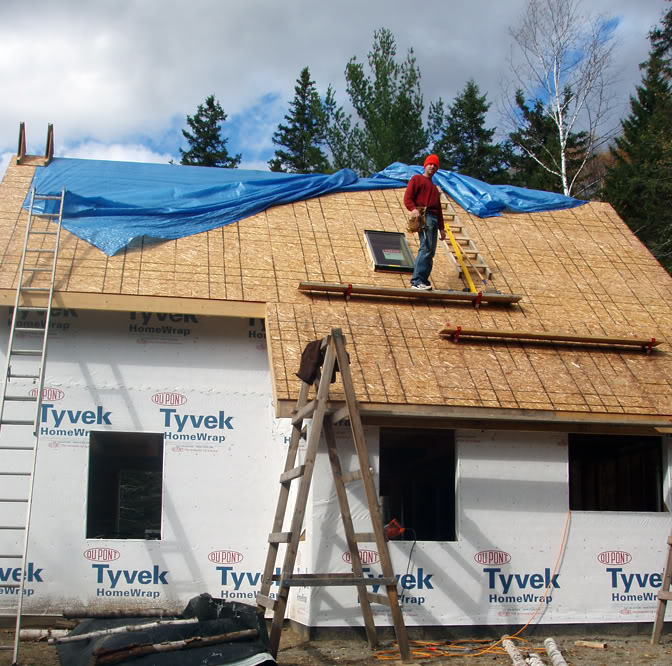

My dad came up for a week and helped me get the 5/8" OSB sheathing up on the roof.

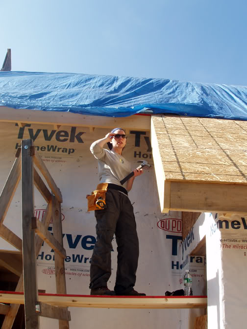

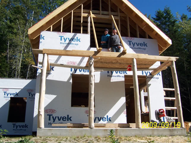

Me and my wife.  The reason why I put the front porch post and beams up first was so I had a good solid place to brace this gable end while the trusses went up.
Notice the site-built ladder hanging off the ridge.  I made two of these and they were very helpfull.

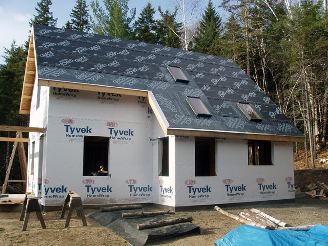

Putting in my skylights.
My wife working on the kitchen bump-out gable sheathing.
Lots of ice & water shield used around the skylights.

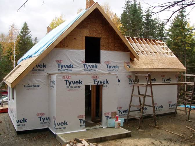

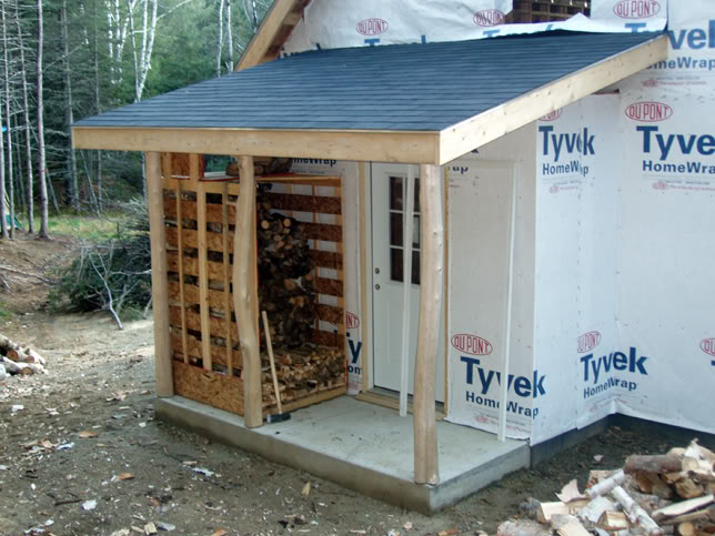

Back porch shed roof with a firewood hopper I made out of scraps.
Gotta throw in at least one hip roof to make things interesting.   ;D
Ya can't have too much ice & water shield.  I used a 5:12 roof pitch on this roof.

How did you anchor these log porch posts to the cement? Some kind of bracket or rebar?
I want to build a similar porch but my log posts will be sitting on small piers... not sure how to attach them and make them look good.

I thought about this issue long and hard but didn't come up with a good solution.  There is anchor-bolts cast in the concrete which stick up about 3"-4".  I drilled an undersized hole in the bottom of the posts and threaded them on.  My cedars were good and dry and I also sealed the end-grain with paint to reduce movement.  I'm sure there is not a lot of uplift protection like this, but it's a small surface area roof so I'm not really worried.  Something with a more aggressive thread would be better - like cast a long 1/2"-5/8" lag bolt upsidedown in the concrete. I suppose I could have wrapped straps up the sides of the posts, but that wouldn't be as clean looking.  Also, there is two thicknesses of asphalt shingles under each post just to get them up off the concrete.  They were really easy to trim and look clean.

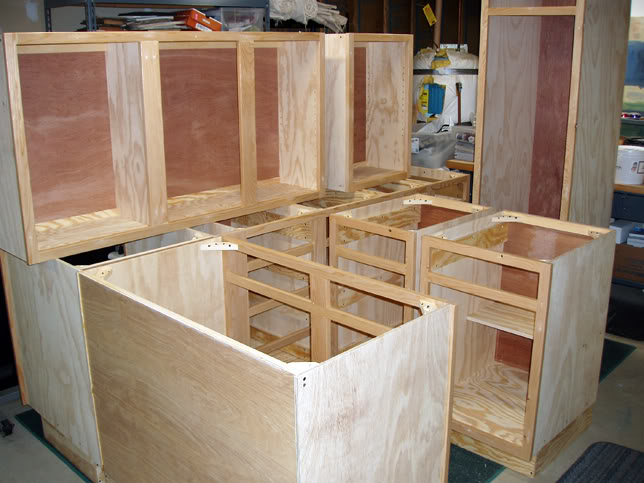

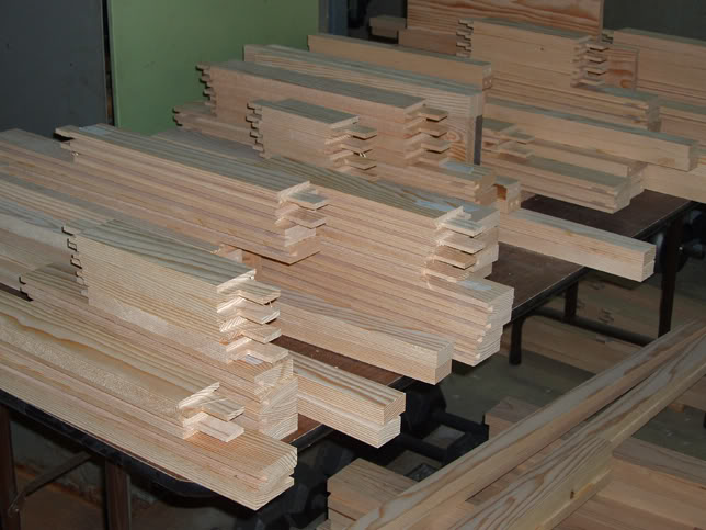

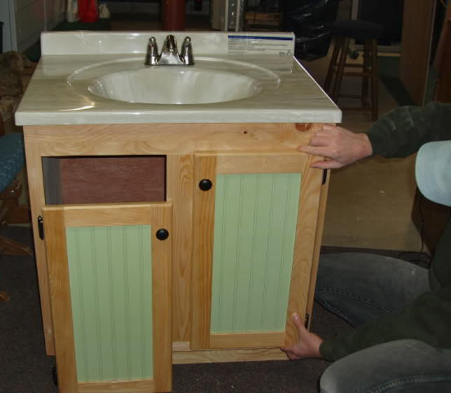

During the winter of 08-09, I made the cabinets for the kitchen and the bathroom vanity.  Cabinets are so darn expensive and I saw this as a real opportunity to save some money.
Making parts.
Table full of mortise and tenoned rails and stiles.
A sample of the doors.
All the doors ready to go.
The carcasses ready to go - all plywood construction.
The bathroom vanity.

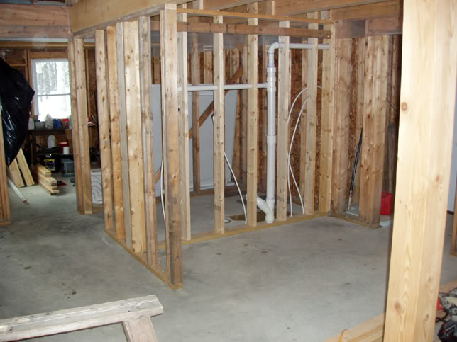

The interior partitions for the bathroom.  Wet-wall plumbing complete.
Dry fitting the bathroom.

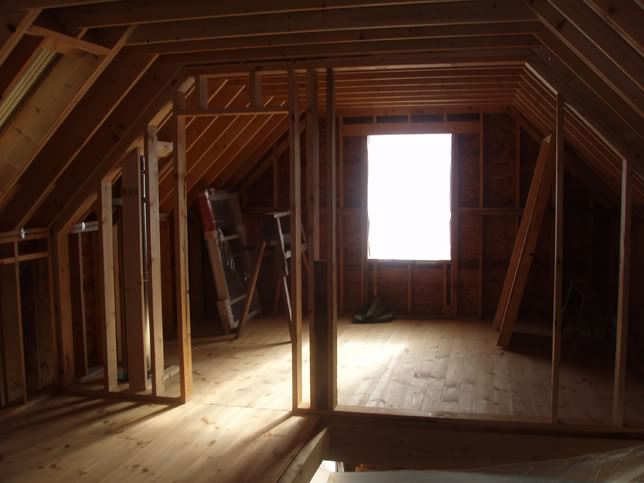

Started upstairs bedroom partitions - there will be two bedrooms.  I left the front upstairs window uninstalled and covered with clear poly so a boom truck can set my drywall upstairs when I get to that phase of construction.

Cabinets look great Jeff!
Very impressive for your first owner-builder house!  [cool]

Something to think about when framing bathrooms, is to install backer blocking for handicapped grab bars.  Where I currently live, I have the grab bars in the tub/shower combo and I have to say I really like them, there is a vertical one at the front of the tub at the shower end, and one at an angle on the back wall. You may not need them now, but it is nice to have secure blocking in place now if you ever consider adding them later.

Thanks BK!  Okie, thanks for that tip!  That is an excellent idea.  We may eventually retire here, plus our aging parents visit a lot...
