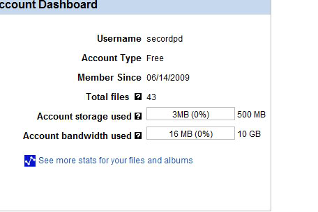

Has anyone else having a problem with the photos on the particular forum?    In place of the photo, it says "Bandwidth Exceeded, upgrade to Photobucket Pro."
When I was viewing it a few days ago, I saw the photos fine...  I thought maybe it was because I downgraded my cable broadband plan a few weeks ago, but all the other photos on Country plans are fine?
Just wondering if it is me or something else?    Really hagging me out - I want to view Jeffs photos again!!!
OkieJohn2
Yep secordpd, I have been getting the same thing on this thread for a couple of days, but no problem with other threads using photobucket.  I have no answer.
Photobucket places a monthly limit to bandwidth used on all of its free hosting accounts. When the limit of 10 GB is reached they no longer serve up the images. Look at your account settings to see the turn over date and a graph illustrating usage. Bandwidth used is bidirectional. They count the uploads as well as the downloads. It pays to save the images with greater compression when the images are only going to be used for viewing online.
On the Adobe Photoshop jpeg quality scale of 1 to 12 (12 is best quality) I find number 3 or 4 gives enough quality for a web view and saves a lot of disk and bandwidth space. It pays to resize and reduce large camera images before uploading.
Most all of my Photobucket usage is for the CountryPlans forum and I have bandwidth and storage room left and hundreds of jpg images stored with them over the last 4 years.
my bandwidth counter resets on the 13th of every month. Last month I came within 1 GB of being turned off.
OkieJohn2
John and Don, thanks for the answer to that puzzler ???, you guys always have the goods.
secordpd
Thanx for your reply's Don & John, but I hardly use photobucket, so my usage is minimal.
So figure it is something else.  I Use Piknik photo editing and if I right click I can save the photo's to Piknik, so that works for me.
Just curious as to why this happened, but no big deal...
