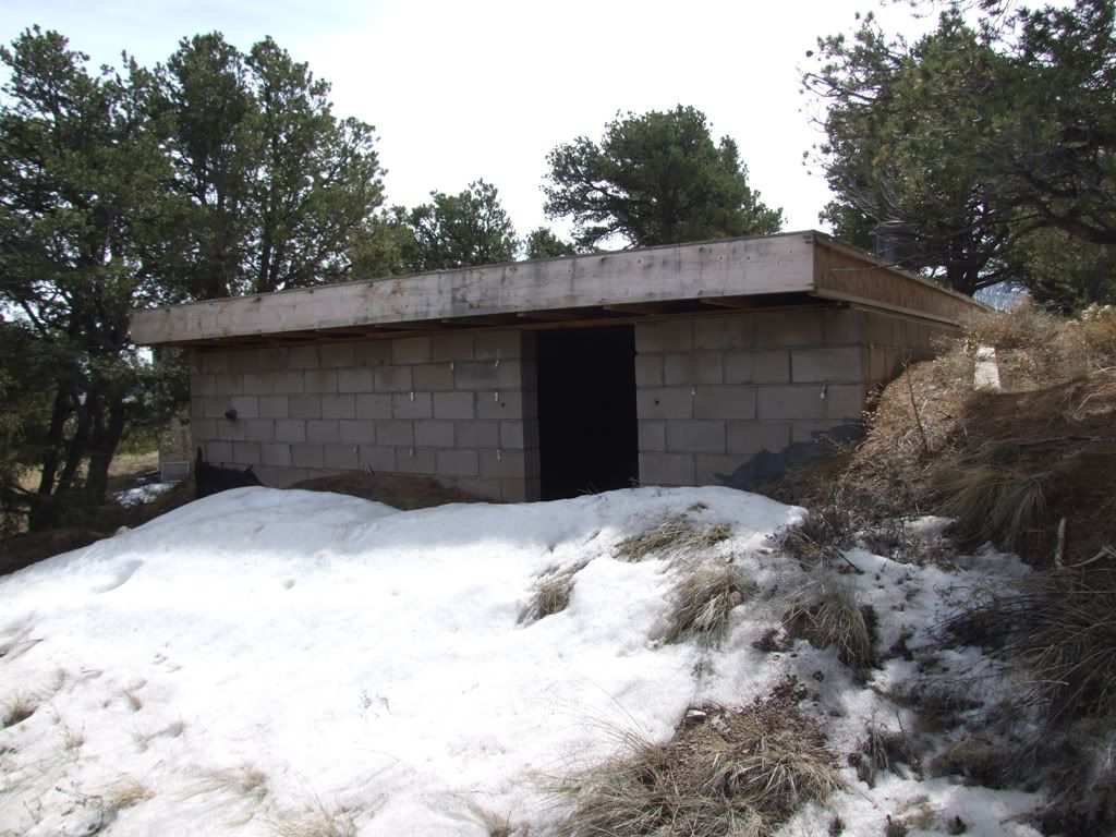

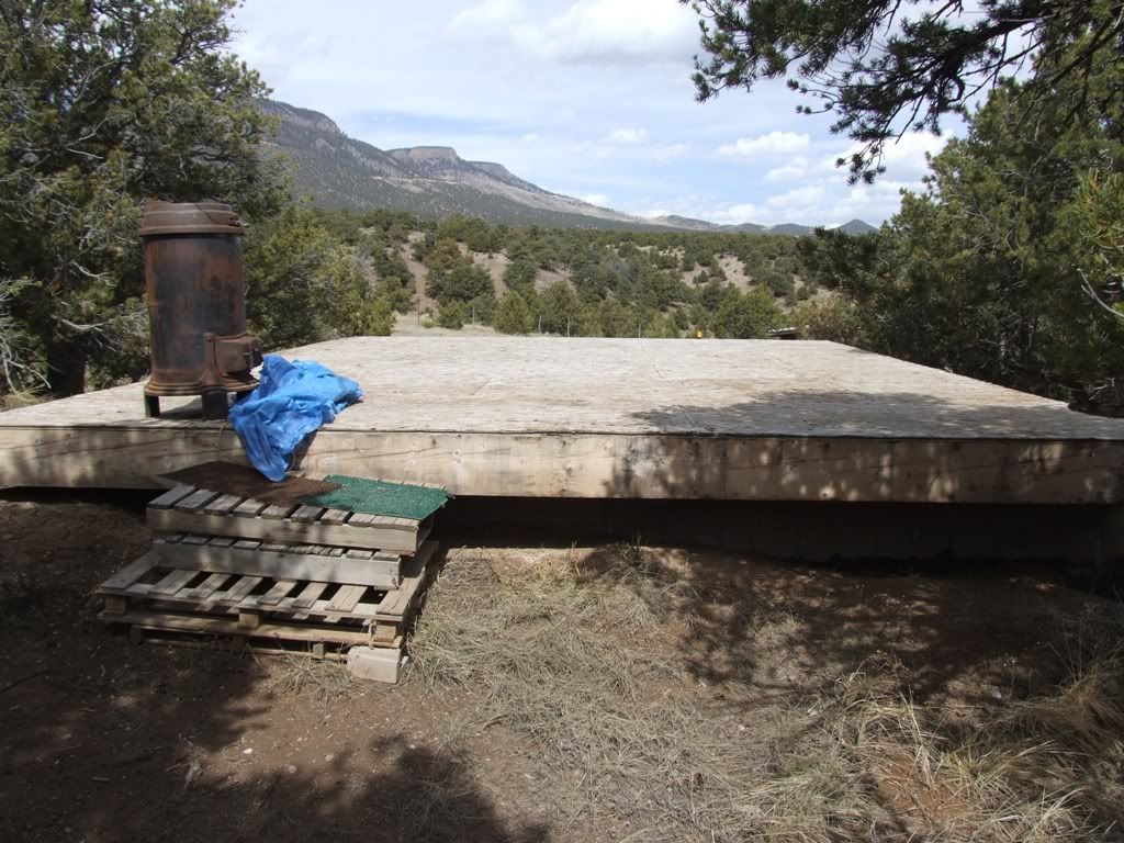

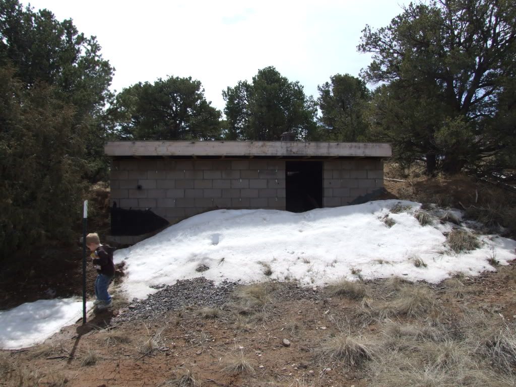

Here are a couple pics. The model is just my first attempt at understanding what it would look like. Many changes already from that point.
Thanks Don. Good suggestion on extending the block. The TJIs are 24" o.c. spanning 20 feet. d* d* d*
So if you put in another, making them 12" OC you would have a nice stiff MTL, IF those TJI's are sized right for the span.

So here is another issue I am unsure about. The access to the crawlspace cannot be correct. THere is just a 2x6 laid flat over the opening, and the tji is sitting on that. Surely that is not strong enough? Here is another pic to show what I mean. Do I need to turn the joists the other way? That table should help on the oc. question. Thanks!
rwanders
I would either turn the joists or replace the flat 2x6 with a proper header. Also, don't mix dimensional lumber joists with TJIs----use all TJIs or all dimensional joists--the TJIs are much superior and 16" OC would be sufficient. I used the same in a 24x24 with 3/4 OSB T&G and have a rock solid floor.
