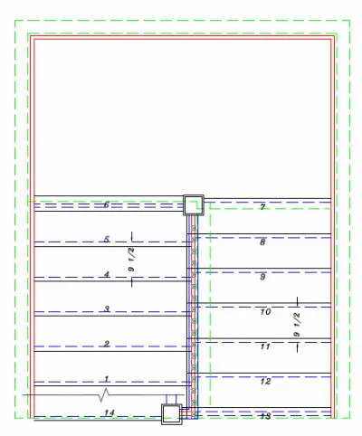

This would be an interesting project with lots of extra space and privacy in a still small house. A 6'-6"x8' U-shaped stair somewhere in the center would give good access to all eight bays of the house. Each bay could have a deck that provides a outdoor connection to another bay.... [cool]
Love to see what you come up with. 8)
Here's a simple layout for the stair;
