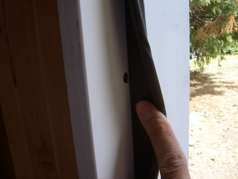

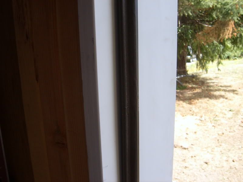

 Some times a jamb will be tweaked and need more than nails to pull it where you need it , I remove the weather strip , most is a fish scale type that just pulls out of a saw kerf ,
Once removed I pre drill and insert a screw where I need it and so I can hide the screw ,

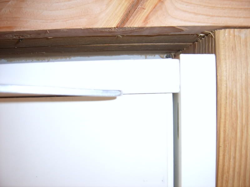

 Same with the head gap , now it can be a real PITA IF the jackarse who hung the door in the jamb screwed the pooch and got the spacing off >:(

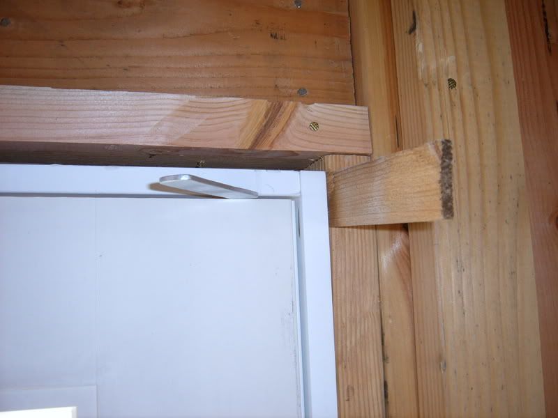

hinge side I should have a 1/8 " gap here , it can be fixed witha little tweaking , more screws , and some gentle taps after those screws are in place pulling on the jamb , easy does it on those taps as the jamb could split on ya ,
One on each side one in the center , the center one generally needs to be shimmed so the gap does not become to large , the end ones and held by the staples the guy used to asemble the jamb so no shims are needed.

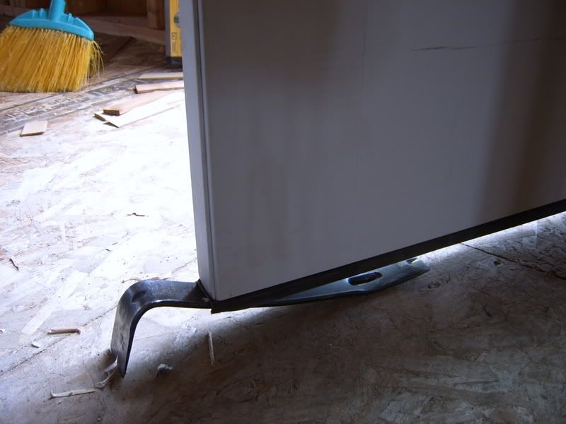

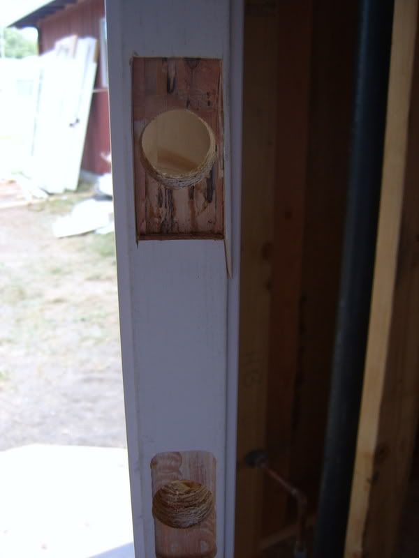

  I use a flat bar , IF the floor I'm working over is unfinished to hold the door open when I let in the backsets and escutchions, and strike plates .  This is once the door is hanging / hung .
 The wood they use really is geting worst to machine by hand , sharp tools are required for a good job .

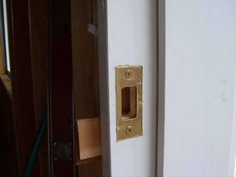

You can see it's pre machined but of course not right for the stuff we have to install. It was pre done with a router, and as you can see it's a laminated "plywood "type cord . I did split that lil side ,  >:( good thing it's paint garde I glued it back using tape to hold it till the glue dries .

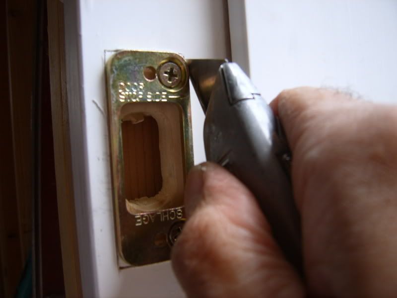

 Dead bolt reenforcment plate , pre drill for screws so it doesn't split.
Screw on then use a knife to cut right up tight  to the plate .
 The reenforment plate goes first screws close to the door stop , I remove the weather strip so it doesn't get cut / damaged in the process.
Then the cover/ finish  escutchions
Not perfect but good enought for paint garde , the primer always wants to chip at least a little  :(

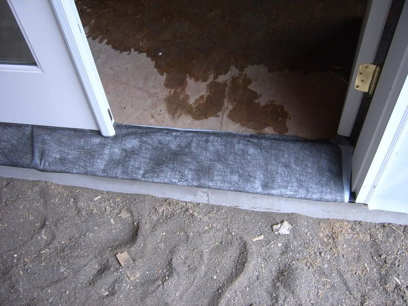

I also add a protective wrap , generally out of Typar cuz it handy , some times our doors come with plastic sill protector , these didn't .
So a staple , fold and wrap the sill so muddy boots and other light const. action save the sill from scratching.
Just staple to the plate or box sill and subfloor , helps some what , they still can get bent / damaged  But>>>>>>>>>>>>>>
