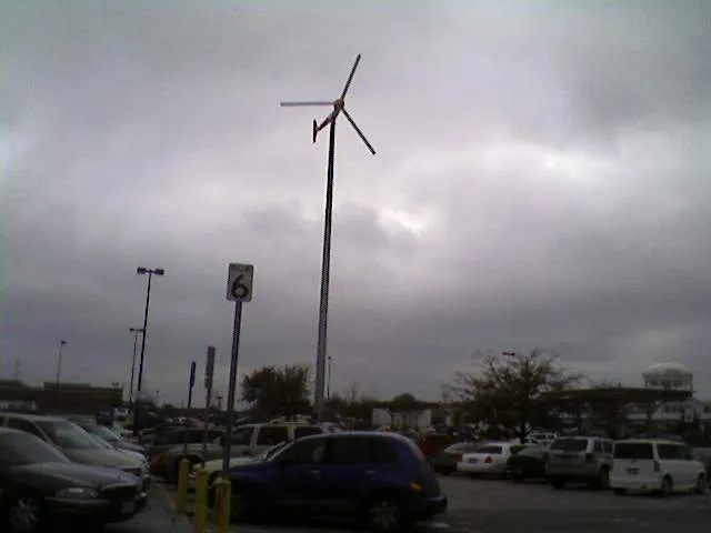

youngins
Here you go, Glenn:
Our local Super Wal-Mart is one of two concept stores (the other is in Denver) which testing the use of energy conservation teniques.  They have two other smaller windmills which I think pump irrigation water.
That's a start.  Now if only it was against the law for people to not like them or think they don't look nice.  I think we need some legislation. ::)
