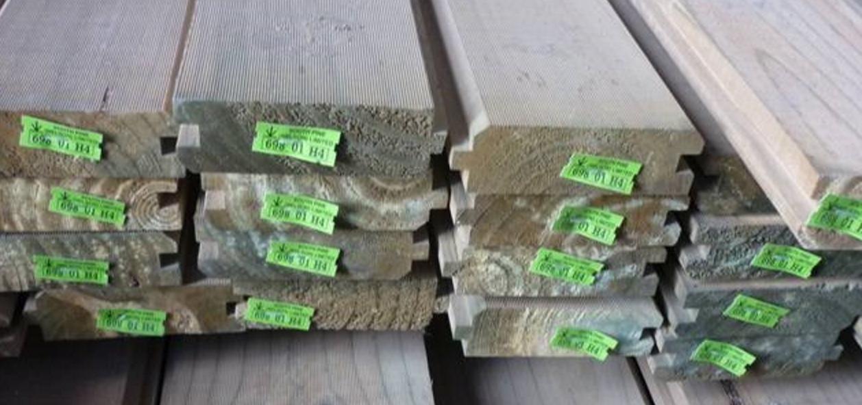

Does anyone have any comments about using 2x6 tongue & groove treated pine as exterior siding?
Similar to that shown here:
Are there any issues with the profile? I believe this timber is normally used to build retaining walls, rather than siding, but it seems like an excellent choice for me (in terms of look and pricing).

There are two cabins in the area that used this, and one has it vertical on one wall.  The door and window trim look odd because the it's really thick.  The joints collect dirt too.  The woodpeckers love it.  Other than that it seems to have held up well
Pine holds paint good.  Should be fine.  I had a house with redwood siding.. couldn't keep paint on it.
Of course be sure to orient properly with the tongue on top to avoid trapping water if used horizontally. :)

I vote no - Much for the same reasons of flyingvan - plus I am wondering about warping, cupping, knots loosing and fallout in the direct sun.  Anything like that needs a lot of paint an' putty as my old carpenter uncle use to mumble.  Looks like to me it would be a magnate for insects.  Spiders and flies.......

Bad idea IMO.  It is not designed to be used at least not horizontally as it will trap water and not last.  If and I say if you decide to use it then it should be vertical .  In regards to painting if that is what you choose then wait at least 4-6months for it to dry out.

Wood no matter if KD and treated and painted expands and contracts just the nature of the beast.... Looking at your photo and all the heart wood in those boards keep covered until used and nail well.  Just the nature of short cycled trees and lumber today........

What kind of structure is this for?  A home or cabin?  I ran an exterior painting business for 10 years.  - I would never recommend painting or staining treated lumber (which is what this is).  Staining will not make it look good unless it was maybe a solid color stain.  Oil based priming and painting might work - but I really don't think it would hold up well.  Your savings on using this 'inexepensive' siding and painting it - will easily be offset by the potential maintenance issues.  Latex priming - forget it - wouldn't hold.  Oil primer - it might hold but I would think within 10 years it would be peeling off.  Bob Vila says its doable - but I just don't think it will (link here http://www.bobvila.com/articles/how-to-paint-pressure-treated-wood/#.VrzvXfkrLUc)
Especially with horizontal siding - moisture will play an issue.  So even if the paint has a good bond - the moisture will cause peeling.
Staining with oil based stains will bond - but since its transparent the green will still show through.  I just wouldn't recommend it.
If you are going to paint or stain - make sure the lumber has dried out completely.

Sitting on another soapbox. Look at the end grain shot in the original post. I suspect that tree is one of ours, it grows like wildfire in your climate. It doesn't produce wood of the same quality, back in the 30's we tried scots pine here, failed experiment. Notice the quantity of reaction wood that is the result of that rank growth. Our radius edge decking tends to use the same type of growth timber unless we source higher grades at a premium. The microfibrils that form the cell walls tend to lie at an angle to the axis of the tree rather than along it. As the wood dries it shrinks lengthwise far more than "normal" wood. When the reaction wood is on one face or edge and normal wood that doesn't shrink lengthwise is in another part of the board, as the wood dries it distorts by bowing, crooking or twisting. If the wood is firmly attached to a substrate it can be held flat but can develop cross grain checking. There's where the warnings on the wood itself are coming from. Rather than sorting reaction wood out of our commodity stream we have derated the strength values (the people in charge don't agree with me there). I suspect that in a university basement someone is working on the "perfect" tree that has no branches and optimum growth rate. Way aside, I had a client one time that wanted a milled log house with no knots. We went for a walk in the woods  ;D
Tanilising is a form of pressure treatment using CCA, which is banned for residential here. It was a conservative measure, we've moved to several other methods that have their own problems. If CCA wood is rinsed and redried IMO it is safe, we were doing neither. The process fills many of the places a finish would grab. The wood doesn't accept finishes as readily nor can they key in as well, they lay on the surface. There's the finishing problems. BTW wash up after working with it and don't burn it, this vaporizes arsenic and heavy metals, you don't want to breath that and the ash is quite poisonous. In your environment untreated wood is highly susceptible to attack. Borate treatment is one option, it can leach out so needs a water repellant coat or some protection. If you go that route from my experience make sure the wood has thoroughly redried or it'll pull to the surface and crystallize under the finish. With everything there are pros and cons, or as grandma used to say "If the washin don't get you, the rinsing sure will".
