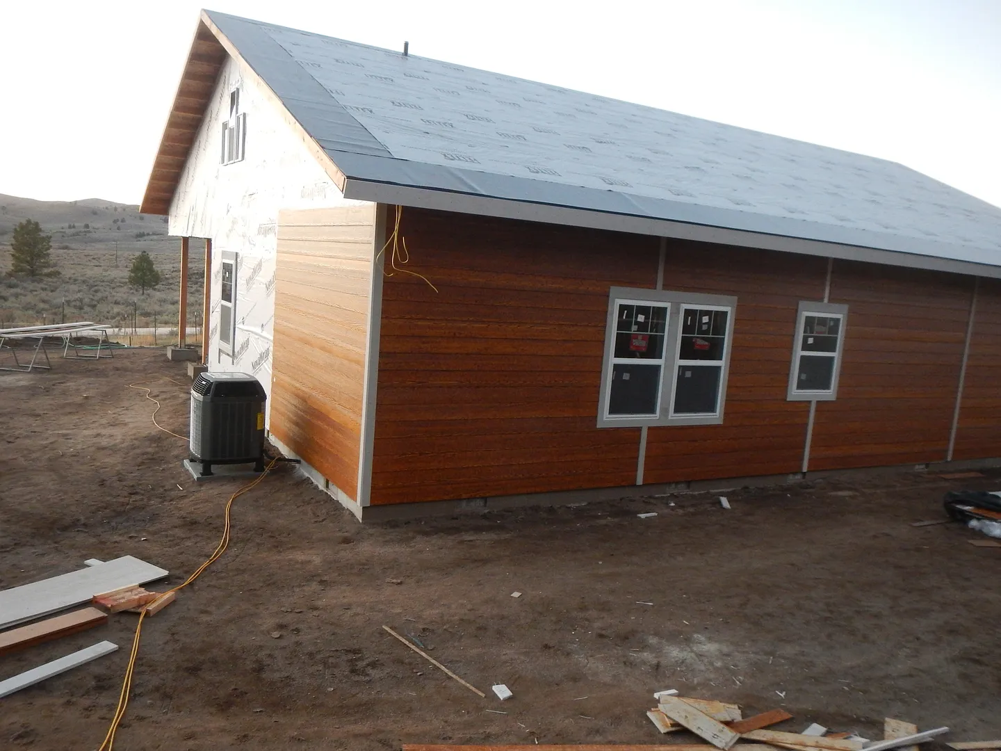

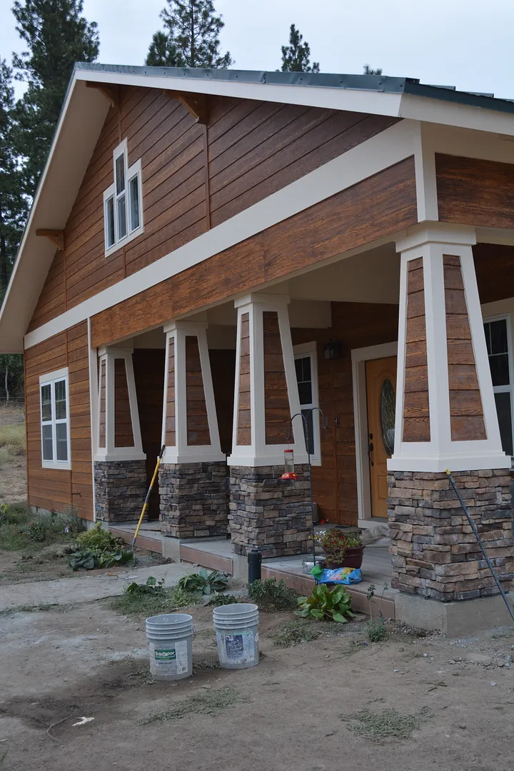

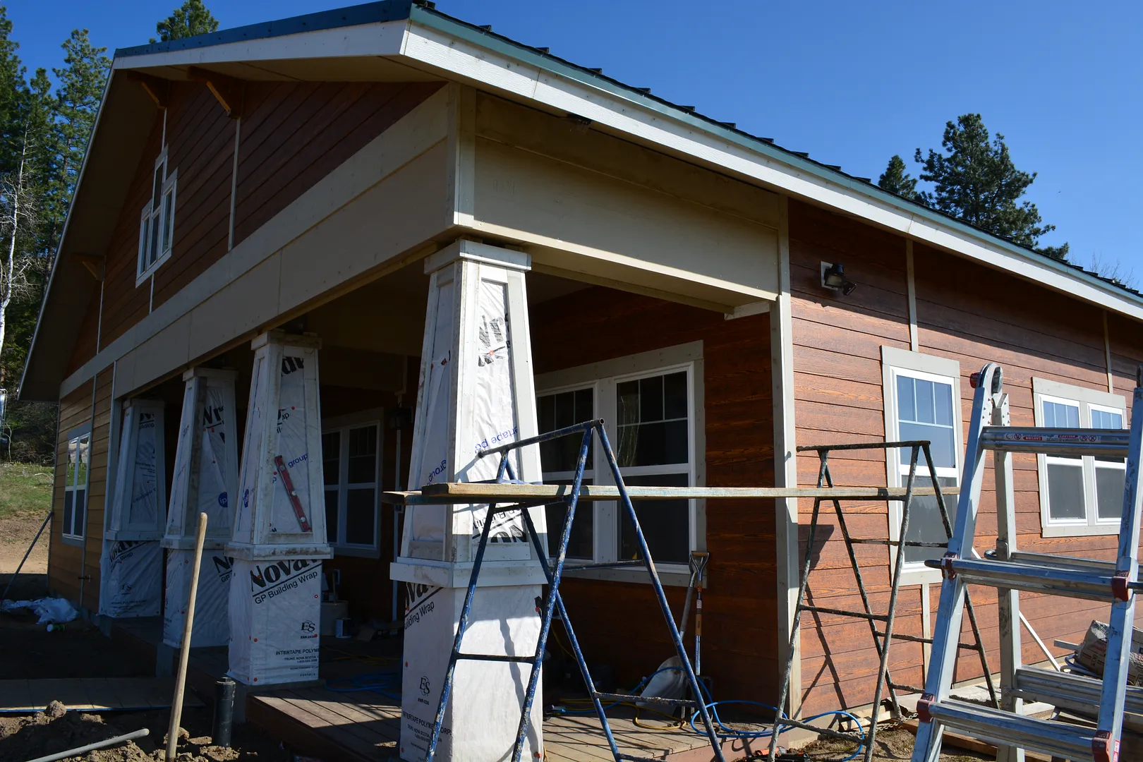

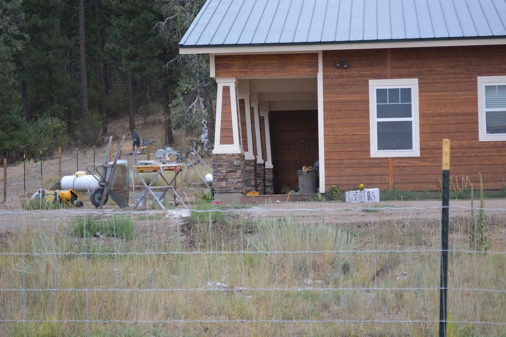

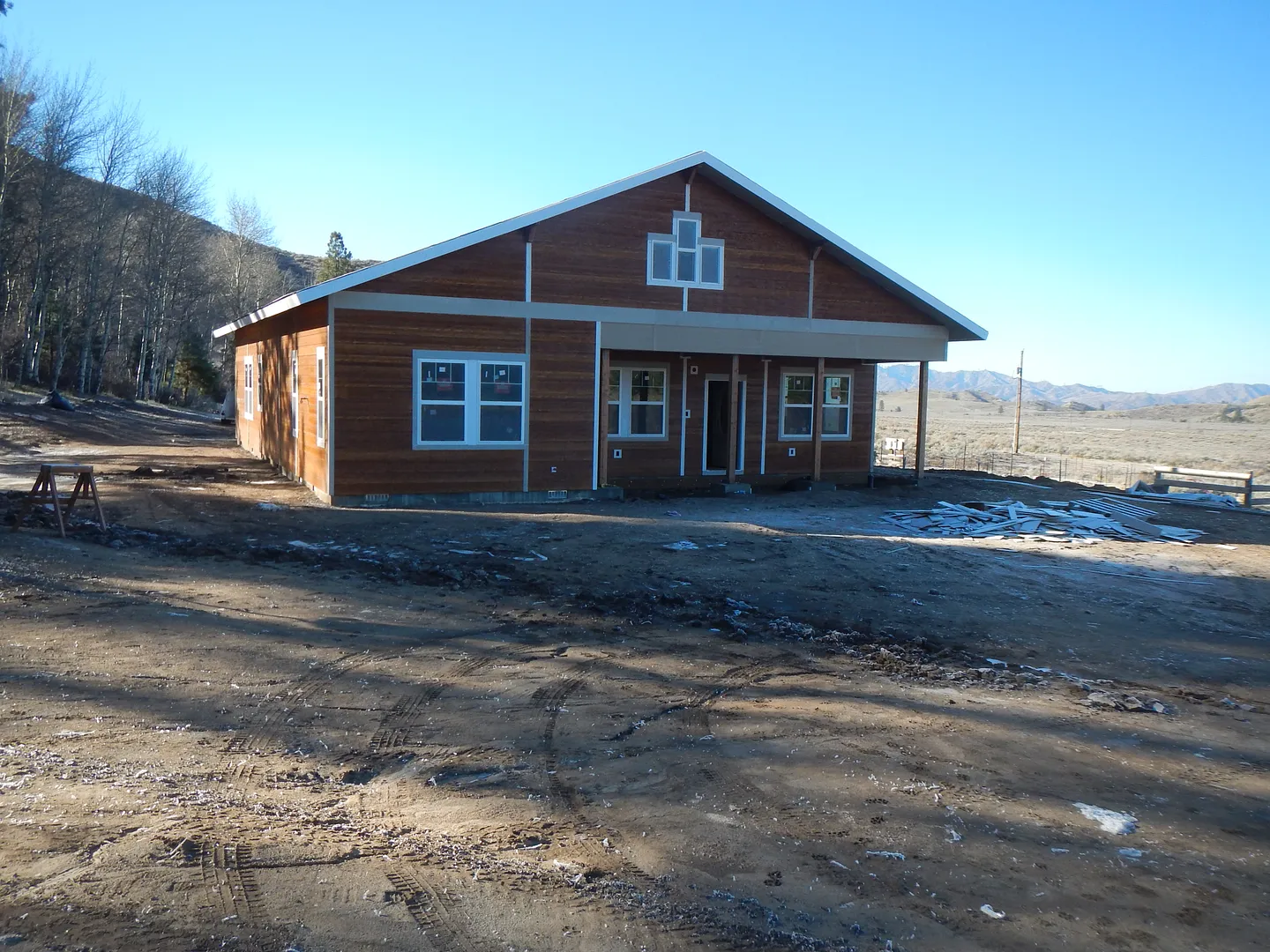

Cement Fiber plank siding. We used Hardie in the 12" wide. Love it. And it is fire resistant. Combine that with the cement fiber corner and door / window trim, fascia and soffit materials.
We used Hardie for the trim boards.  But a Certainted product for the cement fiber.  I think it is a twenty five paint guarantee.  I know I am never planning on painting it.
However Ellen did paint the trim boards.  But she can paint anything.  ME  :-[
She laid down the sort of orange under color then she painted over it with the darker brown and squeegeed it off to match with the edge of her brush.

Quotebut a Certainted product for the cement fiber
Are those really cement fiber boards?! They look amazingly like wood in your pictures.  Looks really nice.

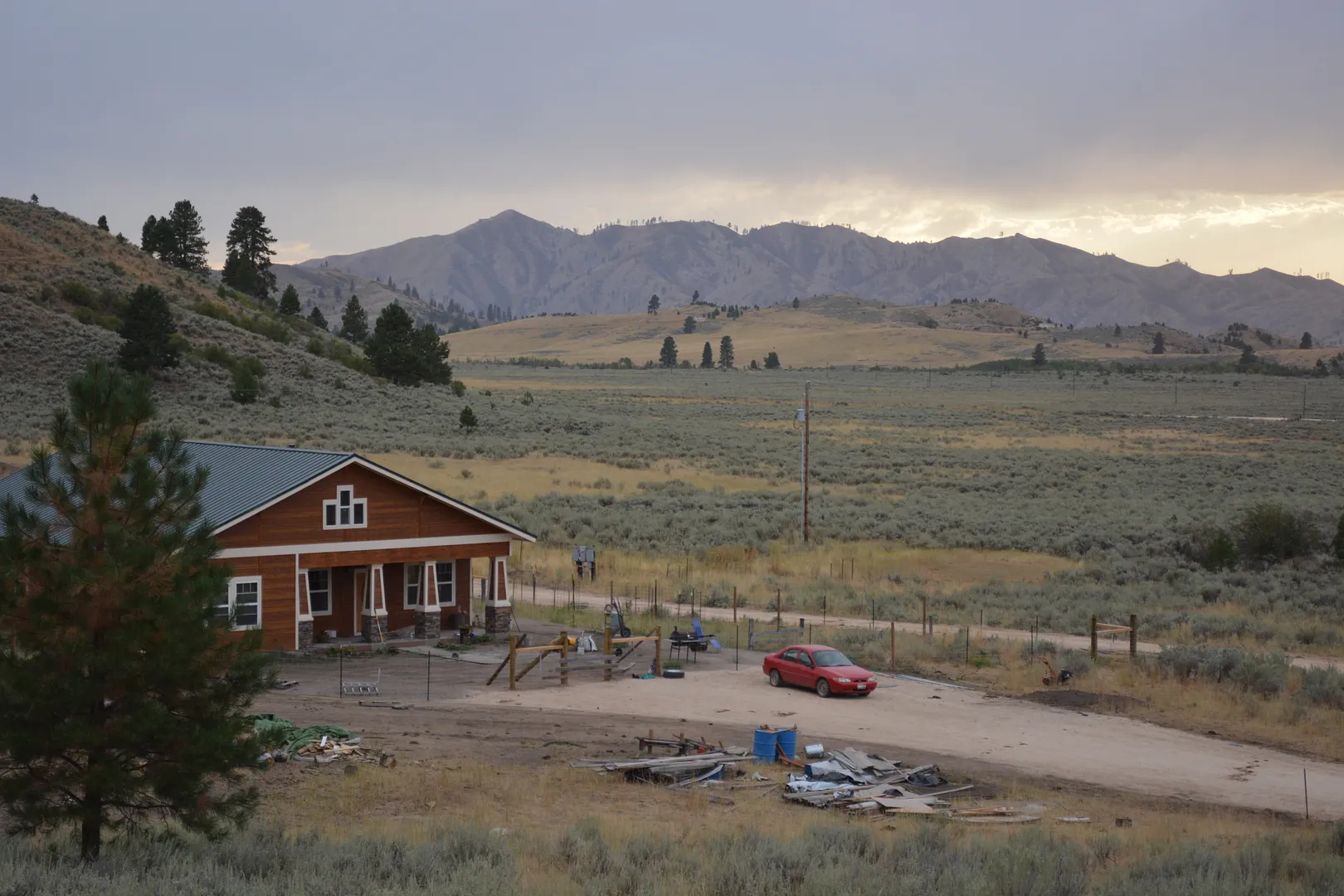

Looking pretty good - still a couple unfinished spots but its coming.
Quote from: knopfarrow on August 31, 2015, 04:54:25 PM
rick91351 - Are those really cement fiber boards?! They look amazingly like wood in your pictures.  Looks really nice.
Yeppers cement fiber.  Thanks they do look like wood.  This whole project has went pretty nice all in all.  Few clunkers but it was a pretty well thought out home by the 'Boss Lady'!  We have had people drive in to give the siding a look see.  This whole house exterior was designed for low fire danger and low maintenance.  I wish I would have known about the expanding paint soffit vents when we did this they would have been included for sure.  I just love that idea.  The porches both are turned away from the forest so they will not act as a heat sink and an ember trap.  Turning them away from the forest put them on the highway side as well about a quarter mile away so the house looks a lot smaller that it is from the road.  The metal roofing was as heavy residential as they sell.  Commercial weight was stupid expensive.    Just some things you might think of when you start really putting it to paper.

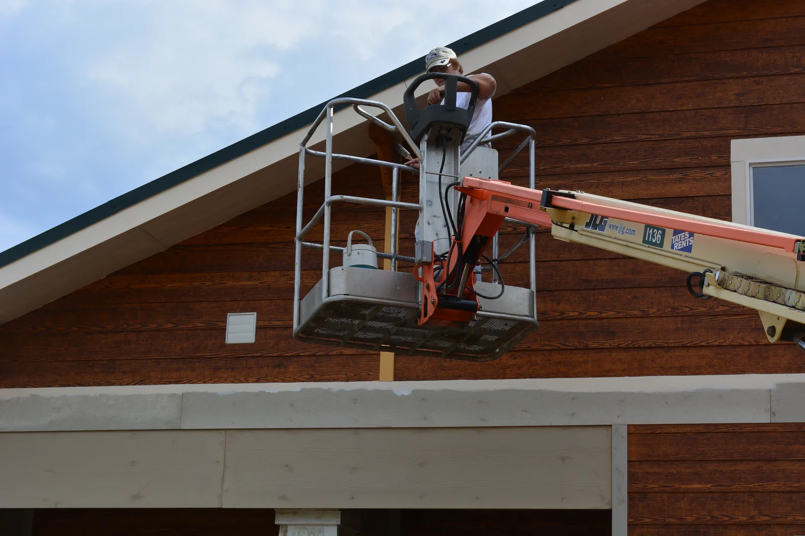

The guys I used they of course had the tools of the trade.  They make large speed squares and one guy is the sawyer and everyone is yelling measurements to him and he cut.  Yes you use a regular like worm drive saw but you need cement fiber blades.  Good dust masks are a requirement!!!  My part of the project I wore them and still was plugged up with dust.  As far a blade Hardie markets their own brand.  I used Exchange A Blade for what I did.  You use a siding nailer the looks a lot like a roofing nailer.  I bought a inexpensive one off Amazon.  And the nailers use the coiled wire correlated siding nails. Then the sideing guys pound or set the nails on each plank they did with a regular framing hammer.
When they finished what I hired done.
I did agree to doing this large board because it never made it up the hill and I was going to have to do a lot to finish this job myself.

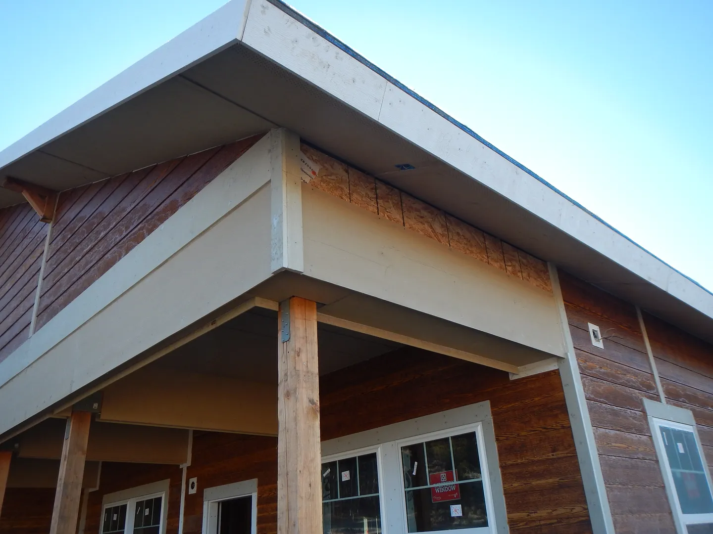

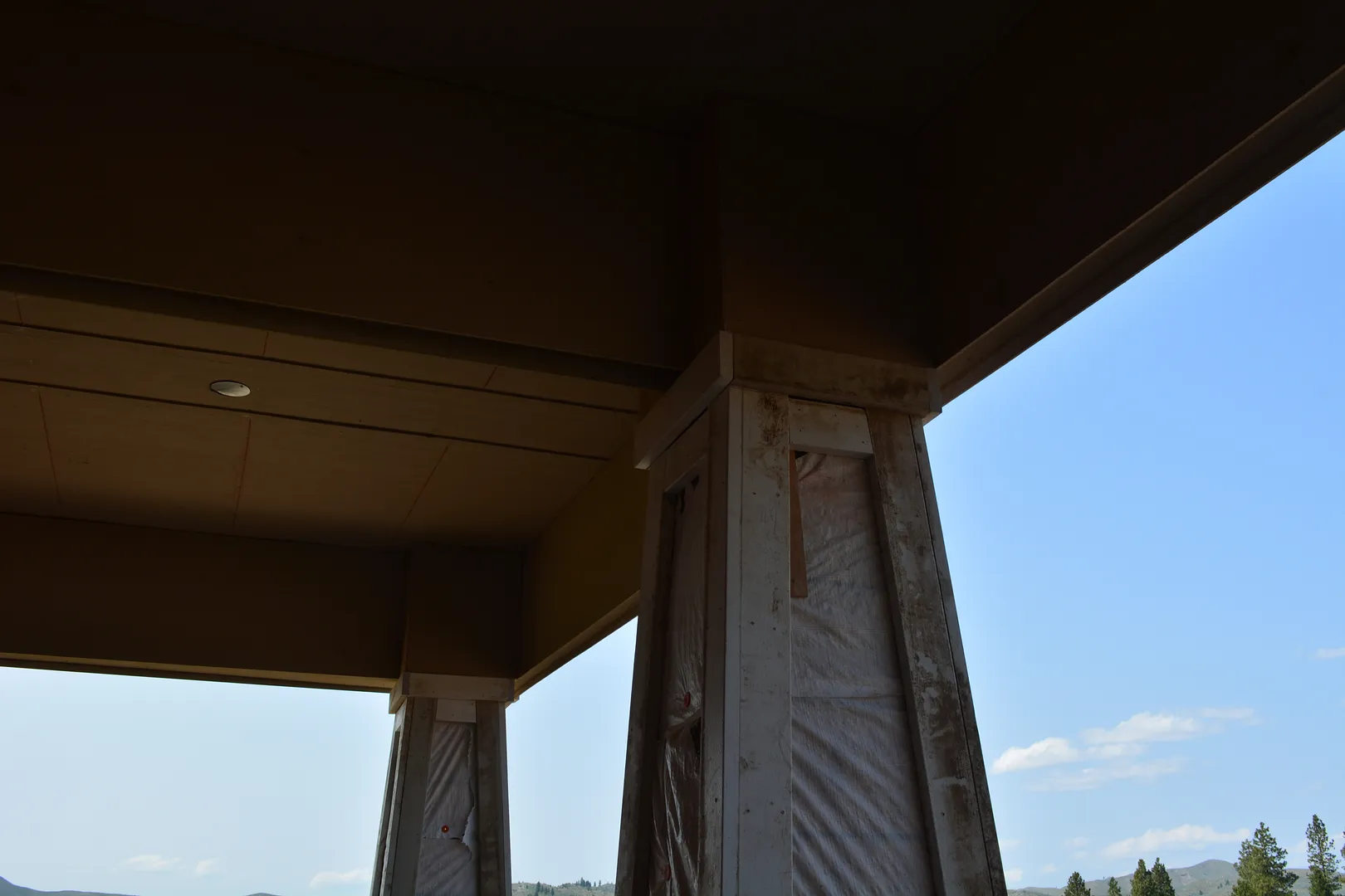

So what the heck did I bite off myself?  Boxed up under the porch pillars to sort of match what the siding guys did.  That took two 4x8 sheets of Hardie
The tapered porch pillars took over 50 Hardie  1X4 front and back and a whole bunch of other sized boards I was given by the lumber yard..   [cool]  Plus the infill took a massive amount of scrap pieces I had saved from the siding crew.
Plus got that big board ripped and put up there.
How it looked when I got done and Ellen finished painting.  The infill on those porch pillars took a crazy amount of marking and cutting. Everything was close to the same angle but NOT! and up and down the ladder and moving and on and on.  Me I am so glad I chose to hire the majority of the siding done.  But if I had the time and was young I might just waded off in to it.  We did not start framing until like the first of September and had the siding on I think in November.  So I had my hands full enough.....
