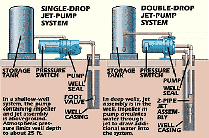

You can use a jet pump with a foot valve down in to the cistern and standard pressure tank with the pressure switch.  Pretty easy piece of cake type thing.  The foot valve should act as a check valve.  Jet pumps are not as efficient as a submergable but cheaper and easier most times to replace if you plan a head.  Jet pumps also have a problem when lifting from deep wells and Glenn has posted that you need to have a double piping system such as

I prefer submersible pumps but you should have no issues with a jet pump on a cistern as you only have a few feet to lift
Foot valve takes in water from near the bottom of the tank, from there your pump, check valve, filter, pressure tank then everything else. Hope that helps!

Here is a six page installation and troubleshooting manual for jet pumps. It might help flesh out the diagram rick posted.
