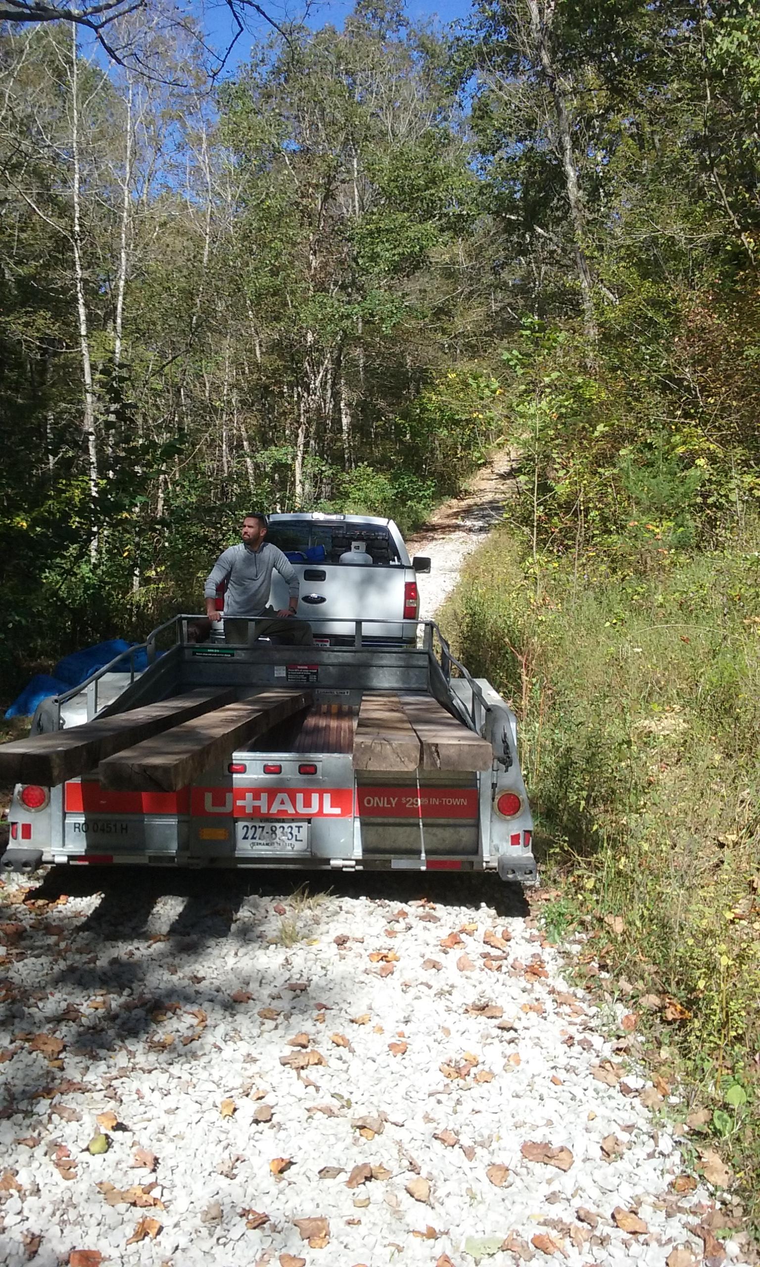

Had a nice trip this weekend.  Was able to get my camper and a big trailer with a tractor up my road easily.  Also able to get some 2wd non trucks up the hill.  However, new rule going in place, only 4wd allowed up the hill from here on out and even then only if you know how to drive.  Only project for the weekend was to bury the 300 gallon cistern and do some loader and grading work with the BX25D rental.  We got a nice 4.5 ft hole dug then hand backfilled it with only fine clay soil.  Its all clay, even the things that look like rocks are chunks of clay.  Also took a picture of our camping rig a 2012 Casita Spirit Delux.  That little thing is awesome, one of the best purchases we've ever made.

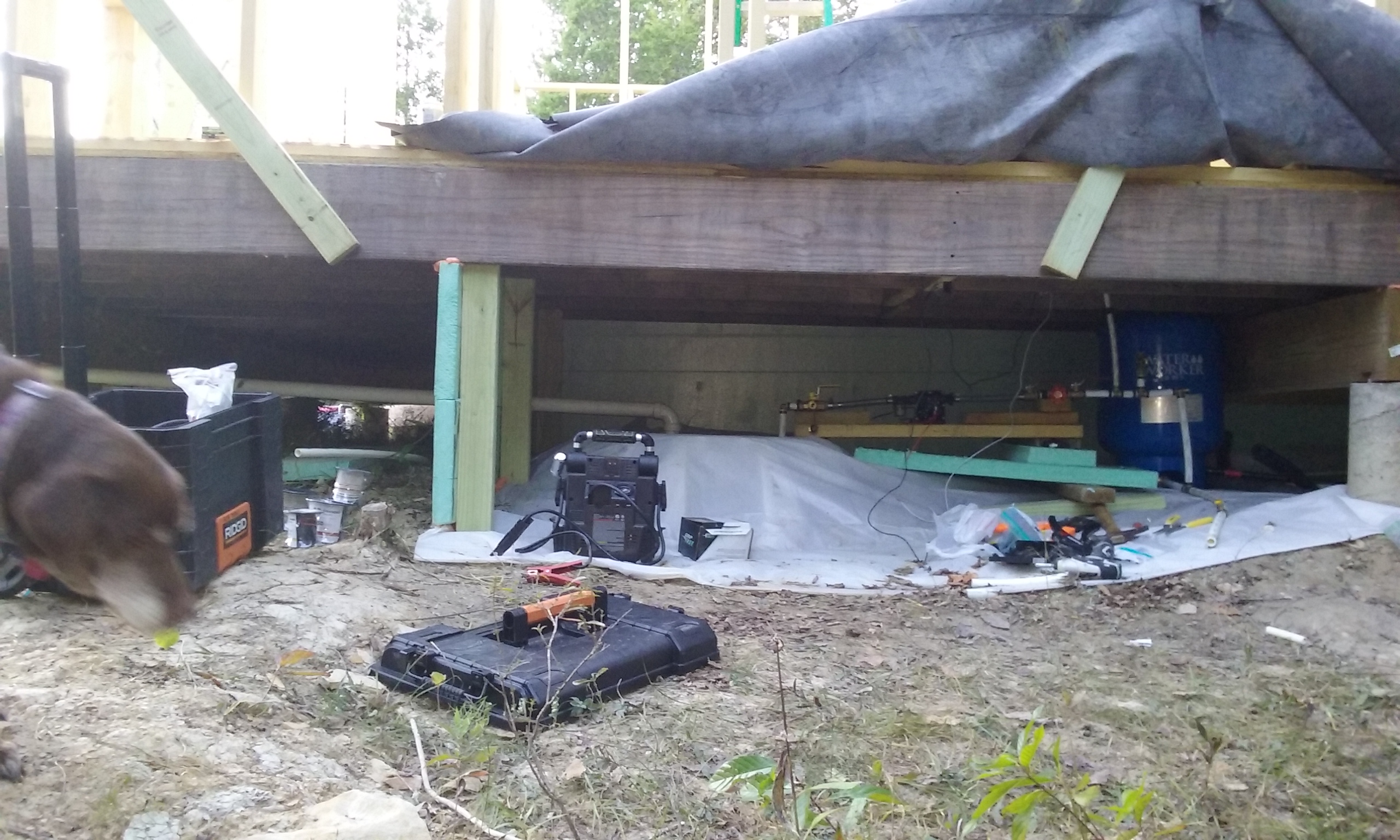

Did a day trip yesterday.  Out the door before 6:30 and working by 8:30.  Spent my time framing the floor joists for the little 8x10 bedroom, adding blocking and plumbing the water tank filling outlet.  Used a bulkhead fitting connected to a threaded cleanout fitting at he other end so I can back my truck up and easily empty my 35 gallon truck bed tank into my 300 gal buried tank.  I made some holes in the bottom of my 3/4 pex line that will pull water from the tank by means of an RV pump.  I forgot that bulkhead fitting so I didnt install it.  I ended up not bringing enough materials to keep me busy for thewhole trip, so I cleaned up the build site, took some picturesand left at 3:00 pm.

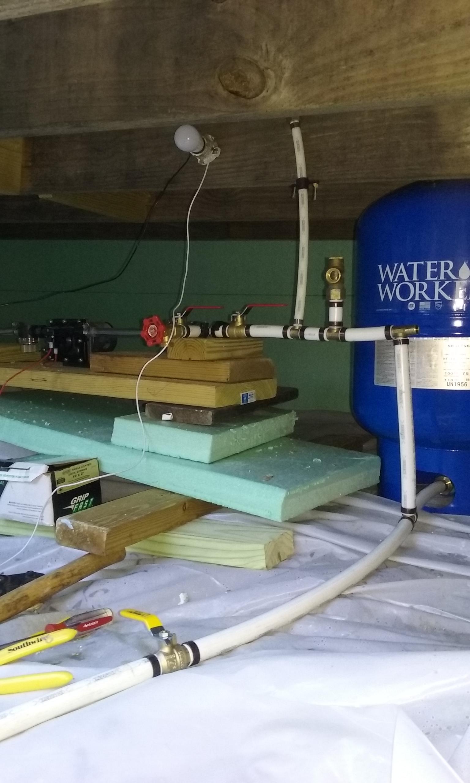

I had originally planned a day trip to build today, but I'm kinda sick, the credit card bill is a bit high this month, and the weather is crappy.  So I decided to make make my water pump connections and mount them to some wood so I don't have to do all these connections crawling in the dirt.   In the future, If I ever need to work on my pump or change it out, I will leave enough slack so I can pull this whole assembly out from under the crawl space.  I designed the whole thing to function as a drain back system.  In the bottom left of the picture u see a pex elbow connected to a 3 way valve with hose drain.  This end will go right into the tank off the elbow.  The 3 way drain will allow me to suck RV anti freeze into the pump via a hose/bucket.  Next is some 65 psi rated rubber hose.  Shurflow reccomends this to cut down on vibration noise.  Next in line is a sediment filter then the pump.  The pump is a 3 gpm 12 volt revolution model from shurflow.  It has a cutout setpoint at 55 psi. It has backflow prevention so It maintains pressure.  It can pull 6 feet of head, and is the same pump my offgrid neighbor uses.  After the pump there is more rubber hose, then 2 ball valves before and after a hose bib.  This will allow me to drainback the lines, blow out the lines, and also divert the anti freeze after the pump if I decide not to put anti freeze in the whole system.  That was long winded, let me know if you have any questions.

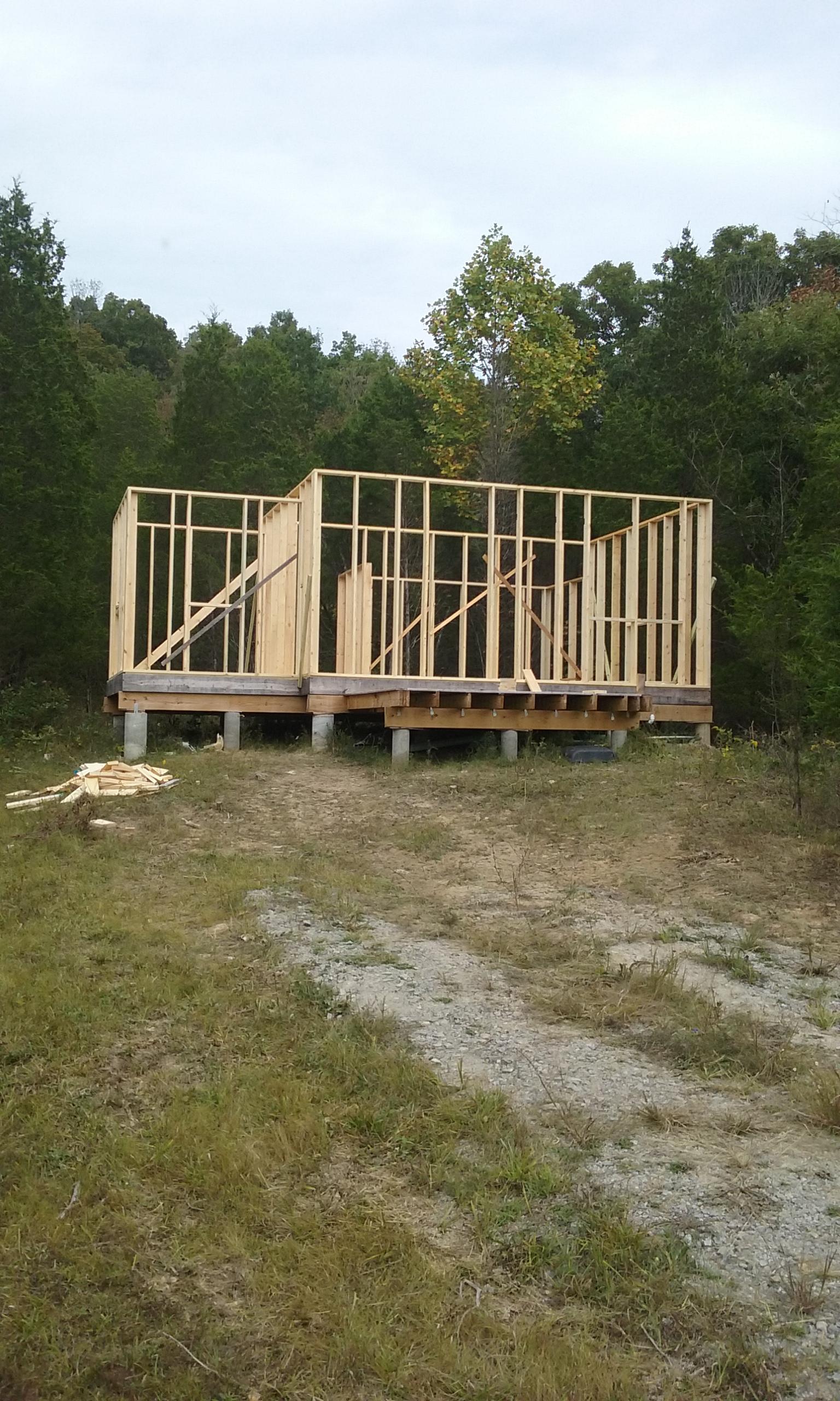

Got the crawl space insulated, the floor decked and the walls framed.  My HH6s didn't arrive on time, so no headers are in.  Rented a mini excavator and did some drainage ditching as wel.

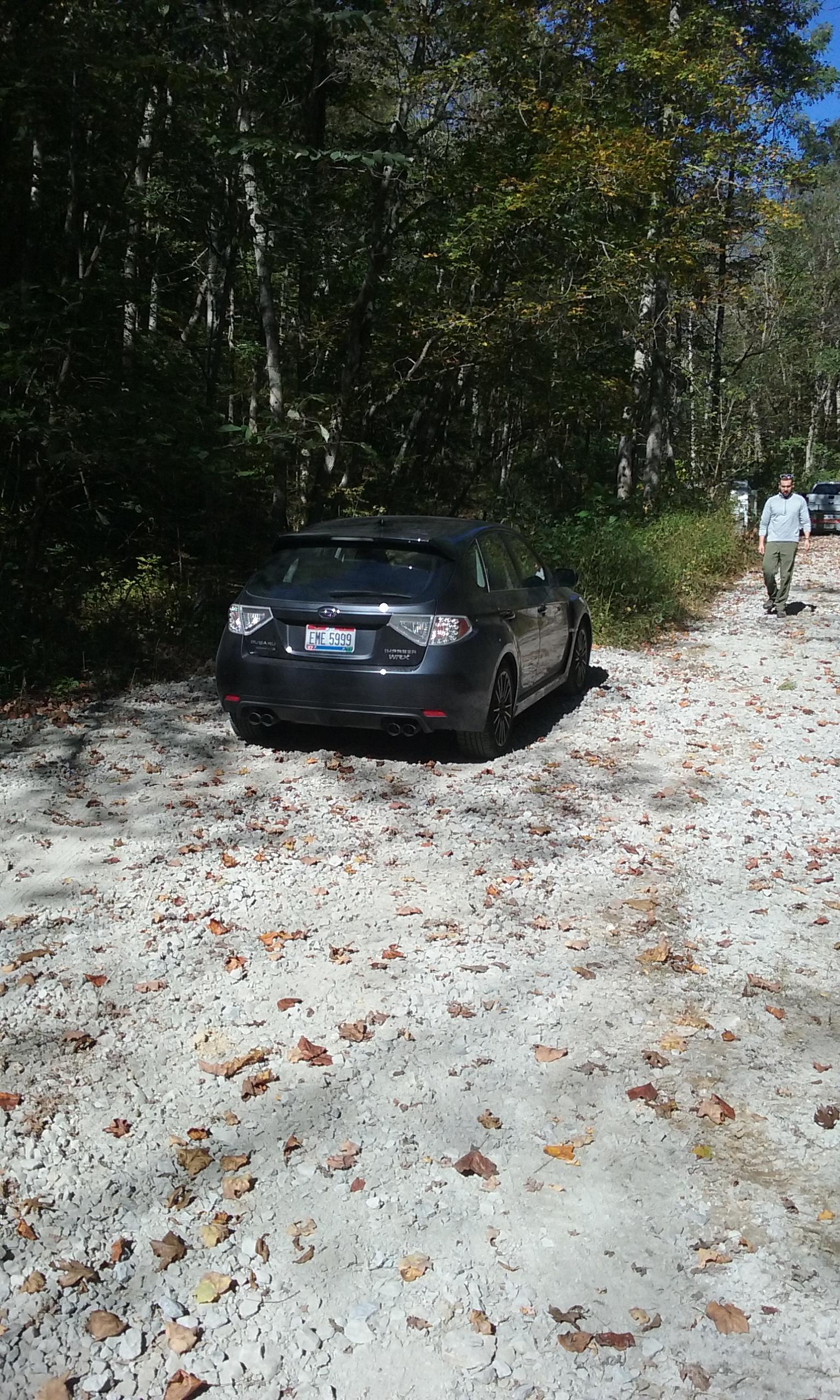

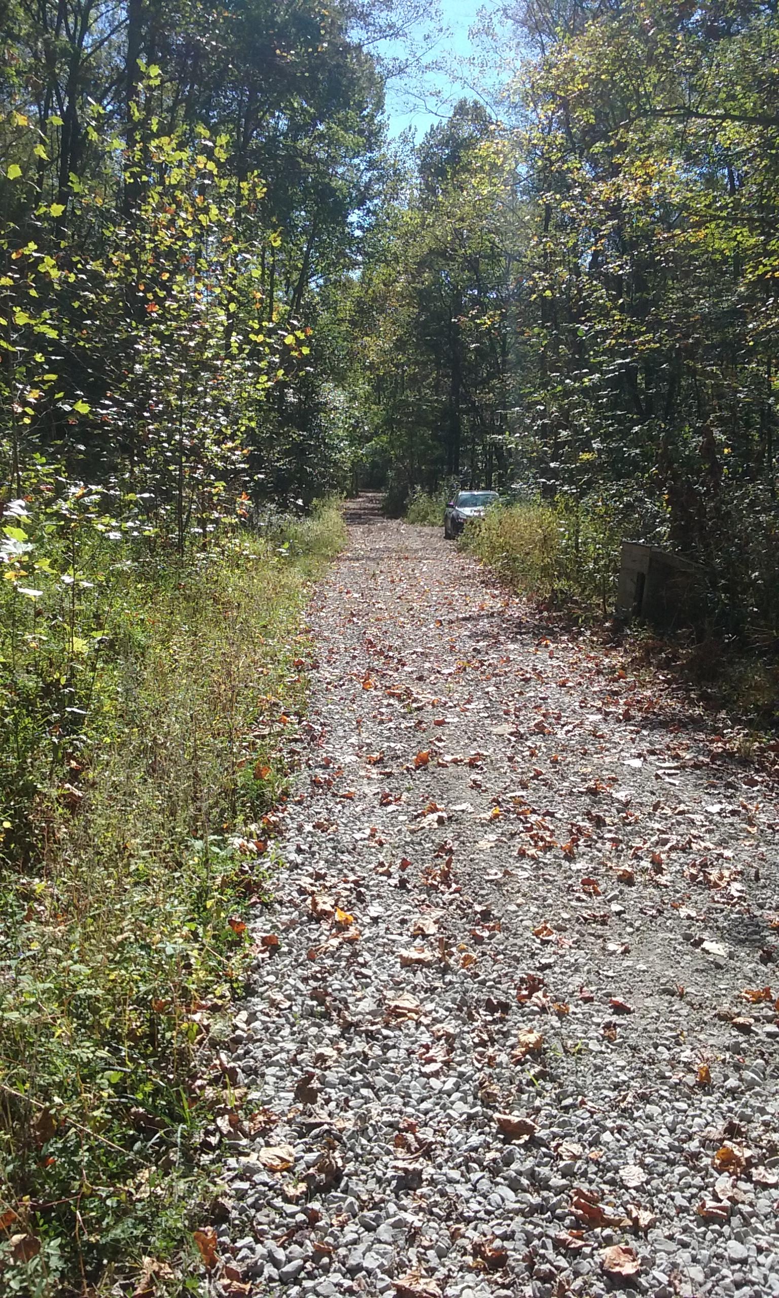

Had about 60 tons of stone spread on my road this fall.  Bit smoother than the creek stone base now.  Friends are easily able to get 2wd drive cars to the base of my hill.  Added a small parking area that can fit 2 cars and leave room for people to get by.

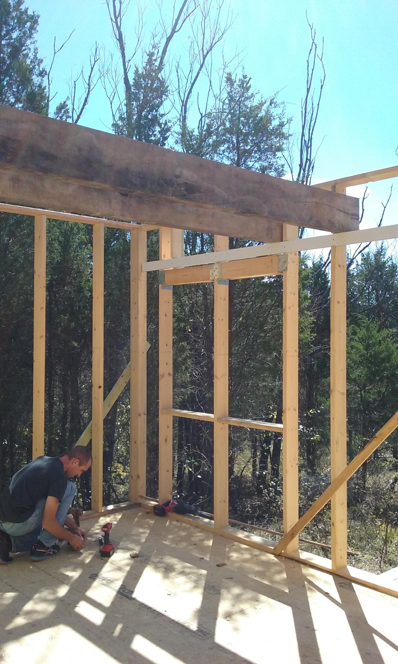

Hauled the 14 foot 4x10 Ash loft beams up the hill and got them set.  That was a chore.
Set the rest of the headers in with the HH6's then worked on plumbing a bit.  The whole thing is drain back so I can easily winterize it.  I also have valves so I can fill my pump with RV antifreeze and purge it in spring without it entering the rest of the house.

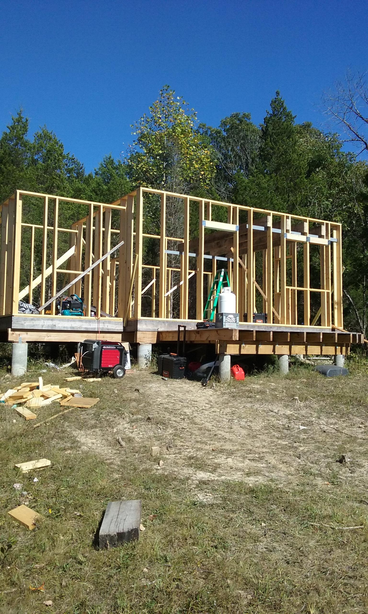

The state of things now
