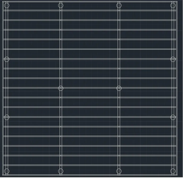

-Piers are 8'' Sonotubes 6' in the ground and 3' above with 4 bars of rebar.
-Screwed to the piers will be treated 4x4 12' long
-On top on the 4x4 crosswise will be 2x6 8' long
-To keep the precise 24'x24' size I will be cutting the 2x6 on the ends by 1-1/2'' to attach the 2x6 to box the framing of the floor
-The floor will be covered staggered formation by 4'x8' plywood.
-As of now the bottom of the floor will be covered in plywood also

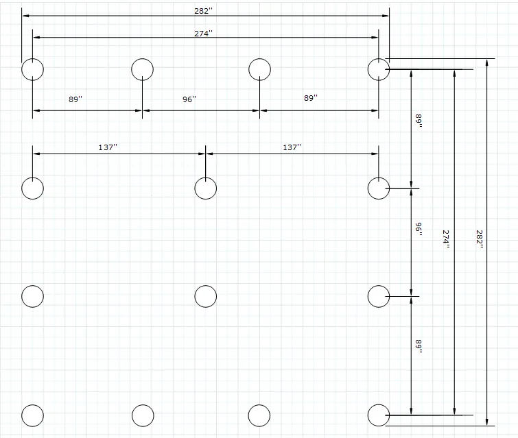

Dimensions
The 2 center piers on the sides walls are 96'' apart center to center. The corner piers are 89'' from the middle side wall piers center to center. The piers in the center of the cabin are 137'' center to center from the side wall piers. The dimensions of the corner piers center to center is 274''. This leaves me with 3'' from the end of each pier to the end of outside wall.

SouthernTier
Here's a good discussion about girder sizing and spacing:
http://countryplans.com/smf/index.php?topic=10511.0
Span tables for joists for floors:
http://publicecodes.cyberregs.com/st/ny/st/b400v10/st_ny_st_b400v10_5_par014.htm
(that's for NY, but would apply in QC as well I would think).
Seems like you are undersized on your girders.  Joists should be strong enough but somewhat bouncy.  But that's just a quick-n-dirty look.  Take a closer look for yourself.
Definitely need to insulate floor.
Cross beams?  by that do mean blocking?  Typically yes.
I would look into simpson brackets for holding the joists to the girders.
Also, it has been said here "design from the top down".  Can't really comment on a floor/foundation without knowing what is sitting on it.
NavyDave
Nimitz,
I think the 4x4s may be a bit small for a 12 foot span. I believe you'd feel quite a bit of bounce with that span. check those links that Southerntier gave you they are good resources.
Also a suggestion for your floor joists would be to stagger them using a 16 footer then an 8 footer then alternating the 8 footer and 16 footer. That would really help tie the floor together for you.
Insulation for a vented floor in Canada would be a must I'd think, depending on the use of the building. If it's a full time residence you may want to upsize the floor rafters a bit to give you more room for insulation. For the few hundred bucks extra for 2x8's vs 2x6's I think you'll be happier and end up with a stiffer floor.

grover
I tried to follow your description and I got lost after the sonotubes.  I'm not sure I follow the spacing of the sonotubes.  The only thing I got on that was 4 piers on a wall each 8 ft apart.
Can you attach some sort of sketch?
I would think if you do a 24' x 24' you should have 3 rows of 5 piers.  Maybe 4 piers down the middle.
How many floors?  What kind of roof system and pitch?

Sonotube spacing
