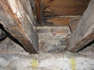

Uk don't run any perimeter supports as such the joists are positioned on the inner wall and cemented in place-set on slate for levelling if required
Is that current construction?
I think it would need some modification to pass here;
Treated sill on the masonry,  joist end lateral support,  hold downs,  gap between masonry and untreated, approved floor sheathing.
UK4X4
Going by the breeze blocks and particle board flooring thats pretty recent - mind you most houses in the UK are 100plus years old in my area- which would be true sized 1" with no T&G
No treated sills- with the damp course- there is no water in the interior brickwork- no water- no deterioration
By adding the sill you'd be adding a break point in the wall
Remember behind the wall you see is a 3-4" gap with insulation and the outer wall of the house which is continuous from ground to roof
we would have hold downs on the roof ceiling joists, but for a first floor its doubtfull
where would it go it has another story of bricks holding it down !
Mind you its been while since I've been on a UK site - so yep things may have changed
last floor I put in was nearly 20 years ago !
Squirl
That looks like every floor I've seen from the early 1900s, only stone and brick instead on concrete block.  Rough cut 3x lumber and all.  It is like seeing it new.
I was kicking around the idea.  I would love to use more onsite materials.  The less that has to be trucked in is part of the design goal.  I would just need to find a rock thick and wide enough to span the 2".  1" to each side would be 1/2 height x 2" 1/3 thickness or 6".  So a 3hx6Lx6W rock should be more than enough to create a joist pocket.
My concerns were like don had written.  Even with the damp course, it may be difficult to fly by and inspector.  With a damp course below and a solid foam layer towards the outside, there should be little moisture issues, but I am not a master mason and may have a difficult time convincing a third party.
More of a personal skill concern, with uneven non dressed stone, it may be more difficult to keep the joists level.  It would probably just take some extra patience. Then again, if I had that much patience, I could probably hand chisel out the blocks for the corbelled ledge.
I've also seen a 2" racking, where they let in the wall and corbel out the rest of the wall over it.  I would rather rest the floor on a corbel than have a heavy wall corbelled.

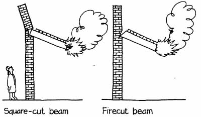

I always noticed angle cut to the joist in a racking pocket.  I wondered why this is.  It is called a fire cut joist.  If a fire burns through the joist support on one end, they can fall and leverage tilt the masonry wall out.  Ingenious.
