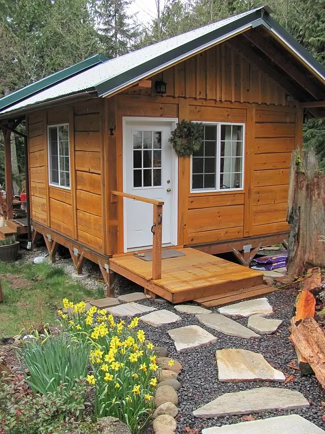

Nice project!  I did something vaguely similar, but my logs came from white pines about 5 miles from my property.  More info here... http://countryplans.com/smf/index.php?topic=8030.0
My windows and doors were framed by 8"x8" posts connected to my logs with 3"x3/4" plywood splines.
Glad my days of peeling bark are done, but it wasn't a major part of the time spent on the project.
Keep those posts coming! [cool]

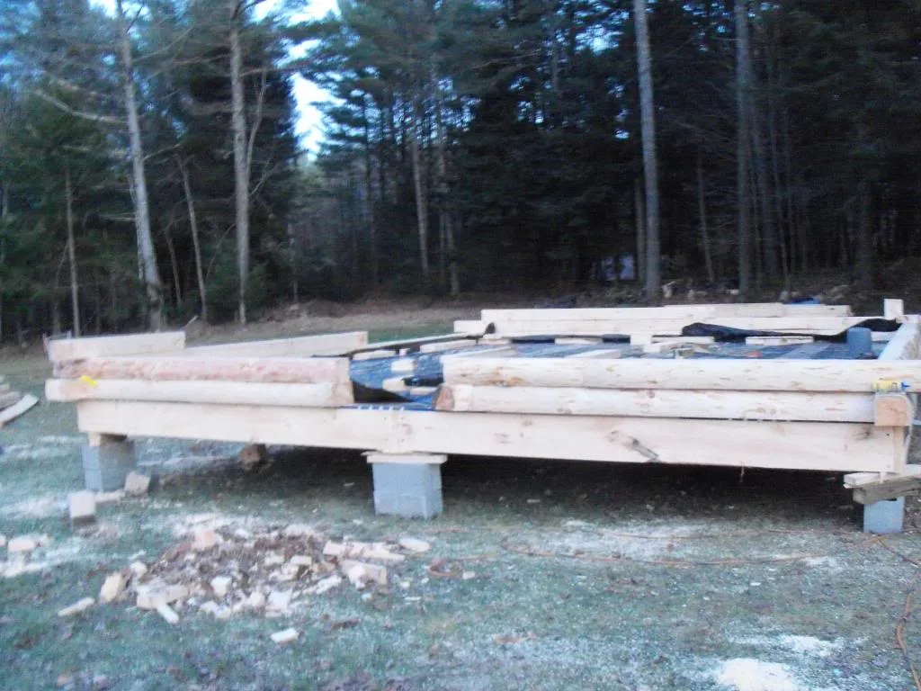

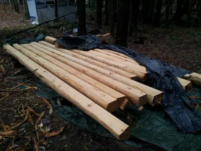

Here is a picture of it - 2-3 rows high. Peeled 8-10 logs and stacked them. I am prefitting it on my lawn . Then I am going to take it apart and trailer it to the place where it will last me and my kids a lifetime - I HOPE> The deck is in 4 pieces.
Here is the last log. tried down loading a longer video but it would upload properly oh well

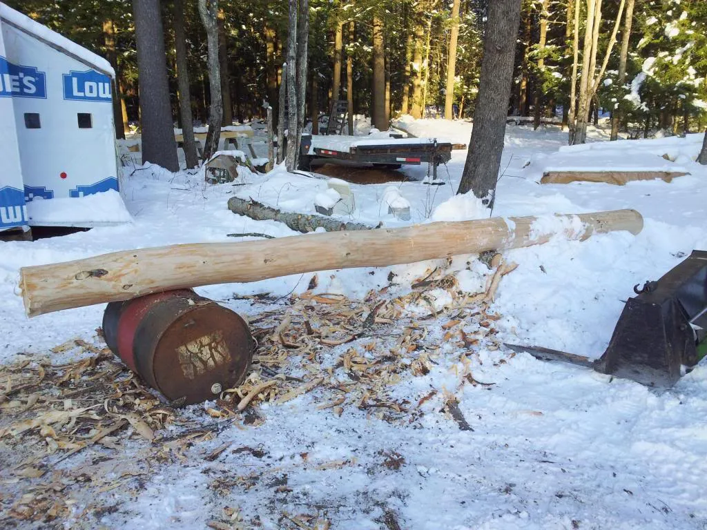

Cut ridge pole support post the other day. -8 in the morning today - but by 12:30 it was in the teens. 20' long as straight as I could find.. I draw knifed it.... One side was very easy but the other must have been still frozen...
Makes my back start hurthing again just watching you. Ah but youth has no pain.  ;)  No lifting is required.   Not saying it is better but I found that sitting on the log moving from one end to the other worked better for me.  Secret is to always keep bark under your bottom.  Peel from one end to the other as far as you can get around the circumference . Roll the log to expose more bark and do it again.
Remington760-308
I tried sitting on the log but i couldn't peel very good- was too bent over..... I  peeled half the log in sections then flipped it to get the other half..How old do you think I am????????  ;D  good thing I have only the one log to peel the whole thing. I have peeled about 45-50 of my d-logs. I am having Martin's Sawmill come back and cut 1 more bunch(25) logs for a few more good long d-logs and some floor planks.. I started my outhouse. NO PIC YET> The deck is 8' x 8' and 2'6" of it on one end is a deck . I boought some cull PT limber from lowes for $45 and it was enough for my floor framing.......The actual cost was over $125.00 I am going to put a vinyl floor down and build my walls on top of it. Slope roof to the back and collect the rain water to flush toilet....  EVERY CAMP HAS GOT TO HAVE AN OUTHOUSE!!!!!!!
