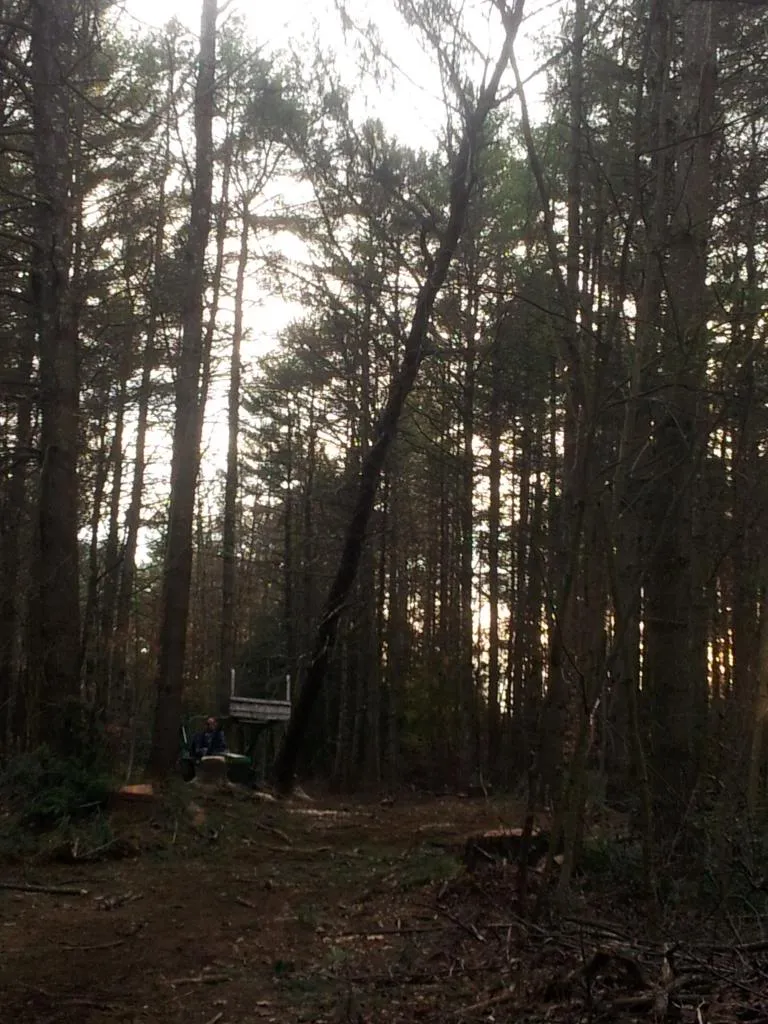

That's a little better 8). I am clearing for a new driveway at my home(residence) so I am using the trees for my log cabin - I should have enough. I have been saving out the  spruce for my beams.  They are a little stronger with no knots.

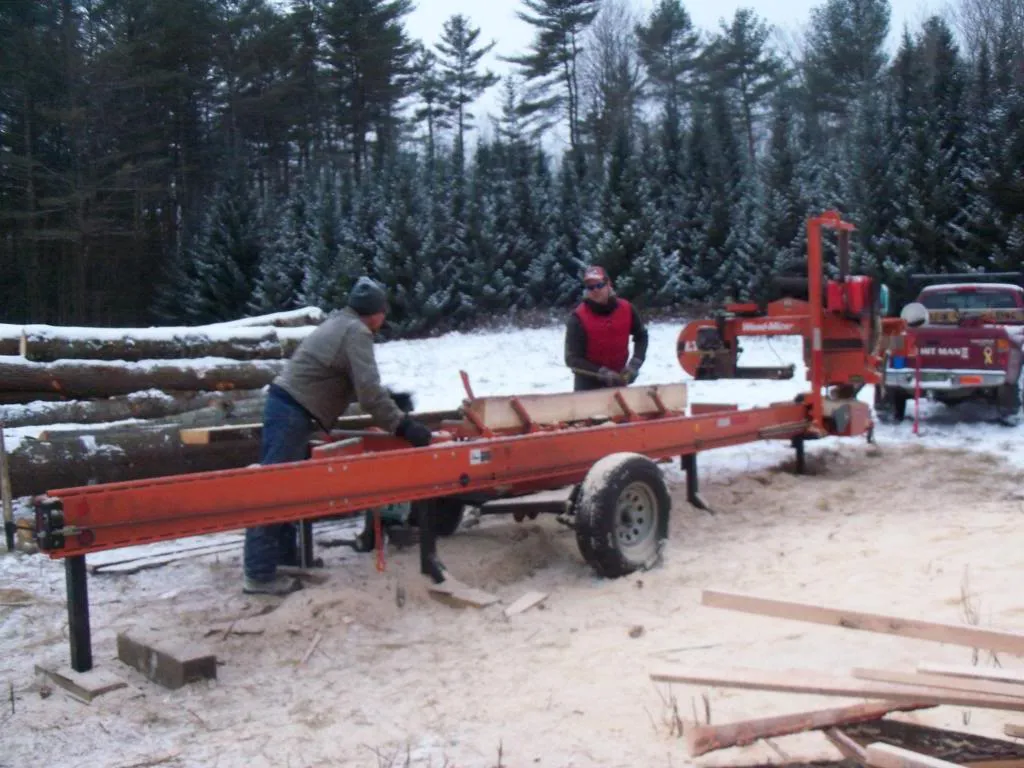

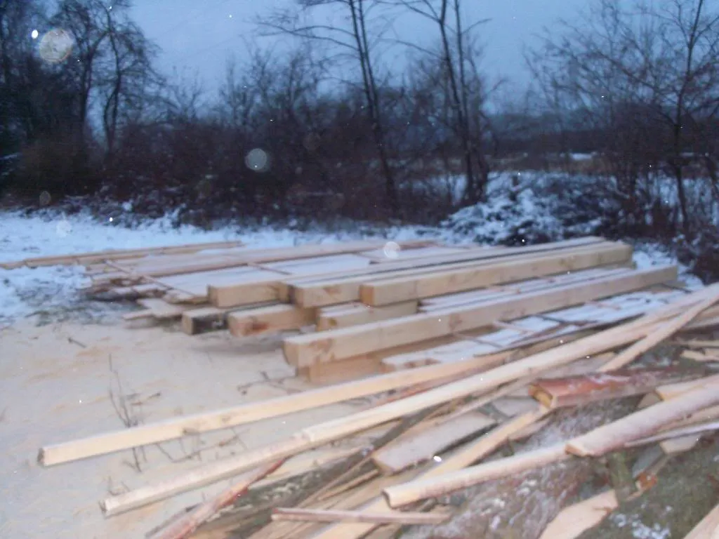

 ;D     Started sawing my timber into d-logs today ;D  We got 21-22logs sawed. Considering it was 12 degrees I was sweating all day. The kids and wife came out to help a few times. They built a fire to keep warm. Only pinched one finger today. I think I broke it - it is all black and swollen. Gonna continue Monday morning - should get in 7-8 hours of sawing in. [/img][/img][/img][/img]

martinbus@kingcon.com is doing the sawing. SO FAR SO GOOD> he is located  in Sheffield ,VT 1-802-626-3480

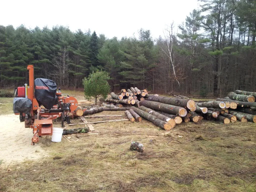

Sawed some more logs . Good thing I didn't buy a sawmill my self. The Woodmizer that he uses is all hydraulic. WHEW!!!  We where sawing the logs 6x6 - now we are sawing them 6 high but 7 1/5 deep. Now we have some really nice logs that will sit on top of each other with no concern of stability. We have been sawing for 3 days and now 2/3 done. Also glad I have a tractor to move the logs around and too remove the logs and beams when done to make room for more!!!
